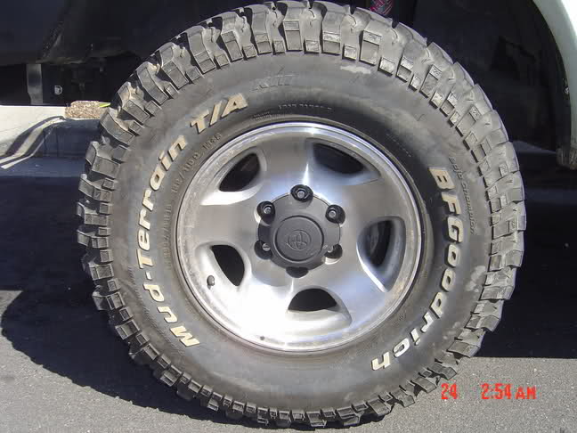

These are the tires I am running, BFGoodrich Mud Terrains K/M's 285/75/R16's. Good ole' 33" tires. I love the look of 80 series cruisers with 35" tires, but I really don't want the hassle of regearing at the moment and I obviuosly need more lift too:
