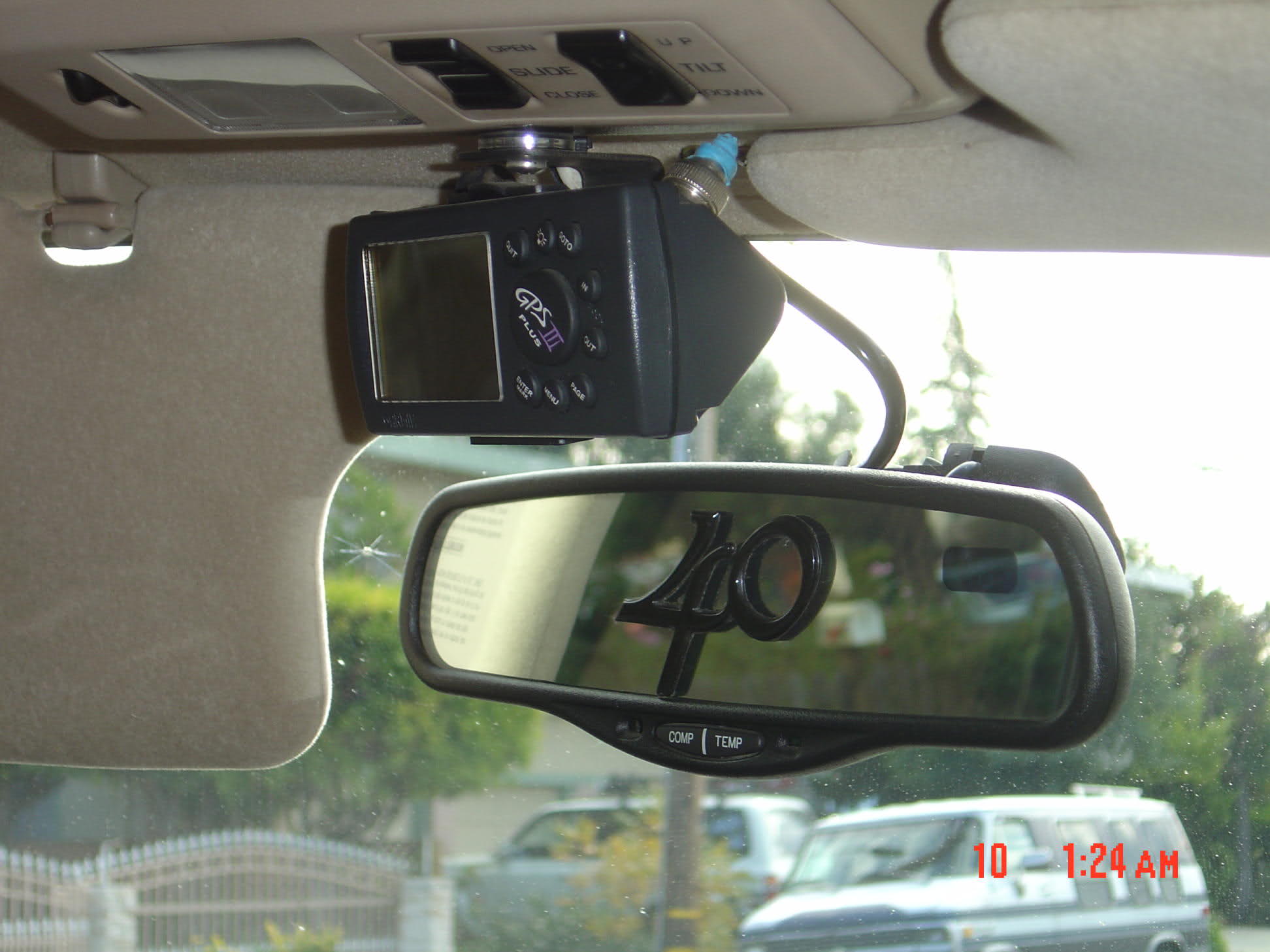

Here are pics of the GPS mounted on right above the rear view mirror. There is also a pic of the GPS antenna mounted on top of the snorkel, pretty trick ;) ....

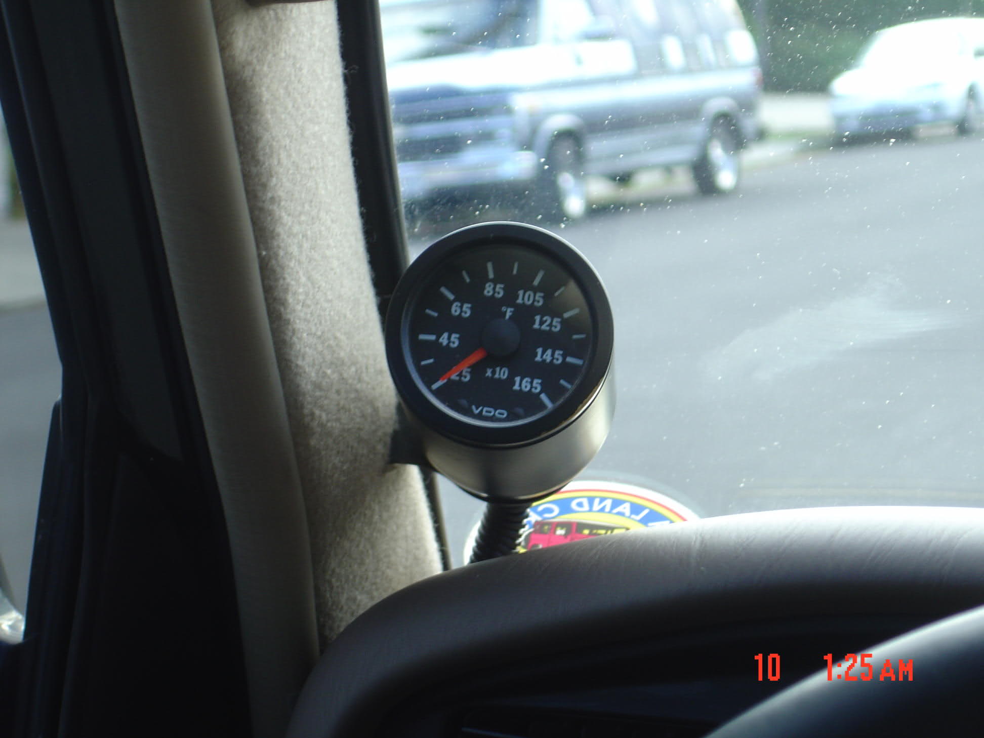

Here is also a pic of the Exhaust Gas Temperature Gauge, now all he needs is a boost guage (they would all look nice in the a pillar):

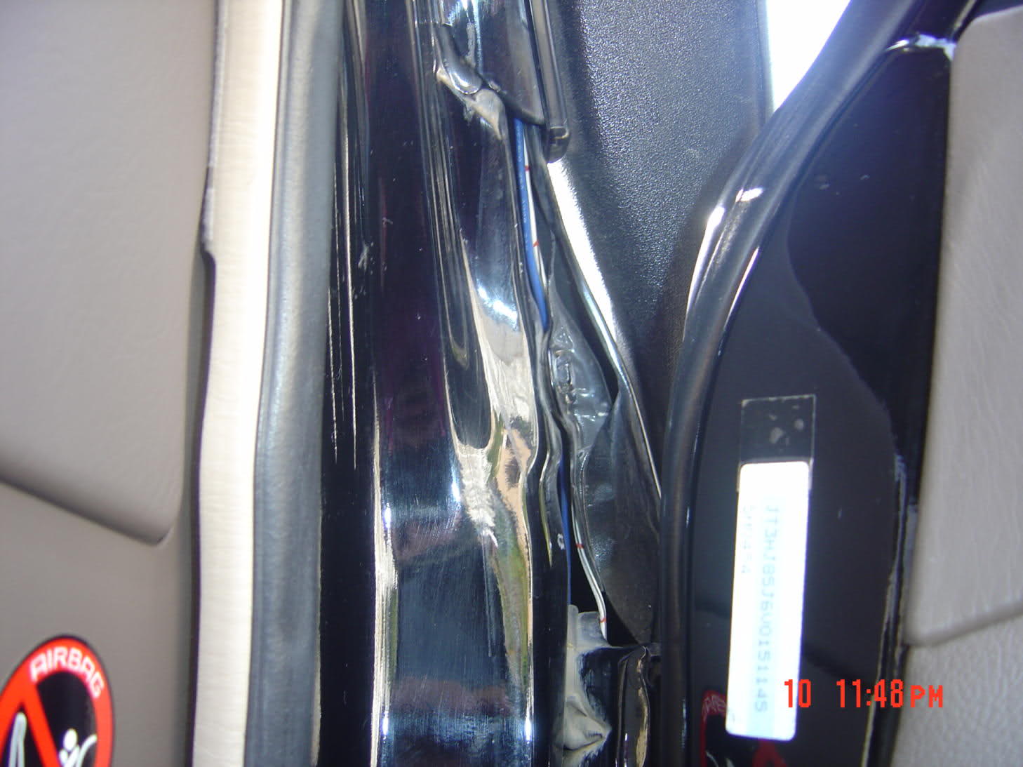

Also, a technical question. For the lights that are mounted on the roof rack, how do you bring them into the engine bay? how are the wires routed? I am interested in putting my Warn Spot lights on my roof rack as well, but I am unsure as to how I might go about routing them.

Beno, the wirirng of the lights were routed behind the roof rack, then behind the roof rack mount.....then thru the gutter railing done to the engine bay. Here is a pic of the wiring location (got carried away with the microsoft paint :D ):

Hmm...interesting. So you brought it down the rain gutter by the passenger side mirror...and then did you drill holes to get it into the engine compartment?
I got the top routing...just need a bit more explanation about routing through rain gutter and into engine bay...

No holes, no drilling.. The gutter goes down/points down to the door opening (where the door hinges are located) and the wires are then passed thru a rubber grommet already located there that leads directly to the engine compartment. Here are some pics:
The first picture shows where the gutter ends and the wires then go down to the rubber grommet that leads to the engine bay ( the second pic of the wires going thru the grommet into the engine bay is pretty bad, hope you can tell though)
