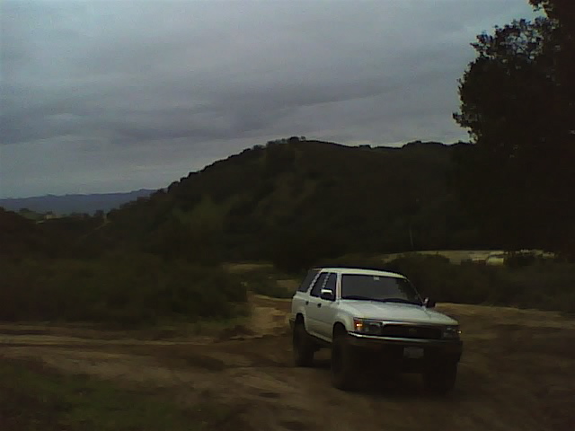

Great to see your cruiser out in the wilderness. It looks at home out there and just fits in with the scenery. Some amazing bike pics too.
Nice rig, great story. You can't go wrong with an FJ, a dog, and open land. I call that heaven.
