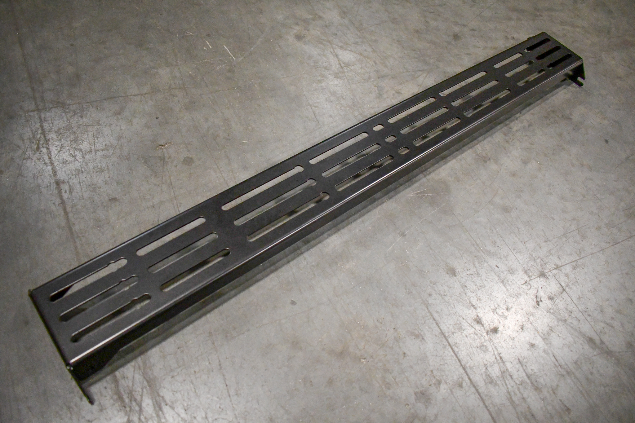

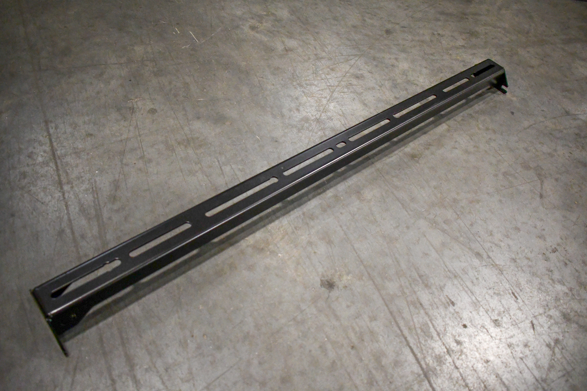

I just purchased the LFD Wide Crossbars for our TJM Yulara RTT (Weight: 123#) and will report how it performs on the stock side rails. Does anyone know how the strength/static weight capacity is changed when you have converted to different side rails (LFD/Prinsu/Etc)? I assume your weak link at that point becomes the roof but I have no idea what the weight limit on that would be.
I would like to eventually add a 270 degree awning on the side, but that would put my static roof weight closer to 200# and I'd like to see how it performs with the RTT first.
Edit: I have found my answer according to SSO and LFD...
SSO: This Lexus GX470 roof rack can carry up to 300 pounds in motion and 760 pounds in static weight.
LFD: Toyota specifies a maximum dynamic load rating for the roof of 300 pounds, 600 pounds static.
