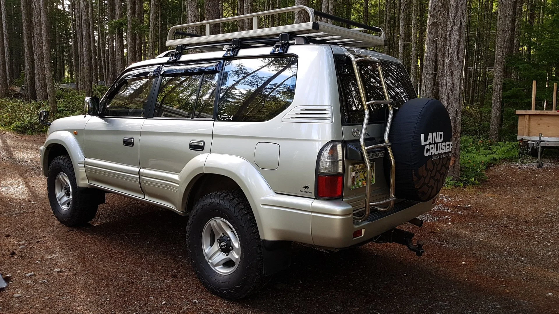

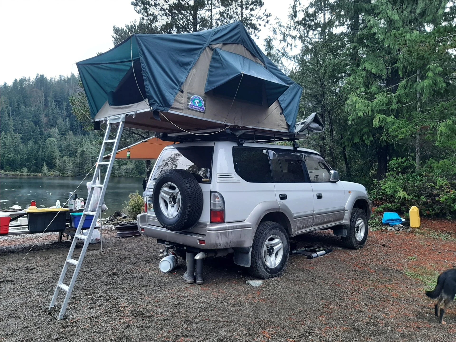

If you haven't got a rack yet here's an option. This is what I put on my 95. I love this rack,it's super strong and has an extremely useful "T" slot system in the crossbars to allow simple attachments. I use it for my RTT as well and had a Solar panel up there for a trip.
Check out Frontrunner online. They are in the US but actually list the Prado.
Cheers... K

Thanks Buggy,
Have you noticed that the rtt is too heavy for the non linked rack? Or does the tent itself anchor it well. That is a great lower cost option, though I think I would try to go with 3 crossbars.
-Jay
I built a frame that kind of links the crossbars together and provides a place for a cargo basket as well as a platform for lumber etc. or just standing on. I was planning to go with three crossbars but the end cost with our dollars was a bit much.
Three would be a good idea to transfer the load into your roof gutters.

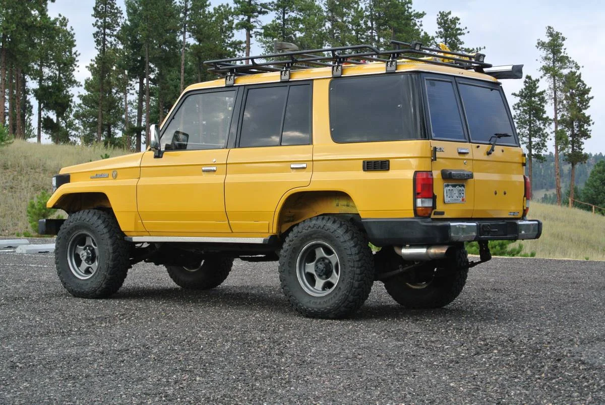

I personally preferred the original factory Toyo roof basket you see here on my previous RZJ with the six towers but I foolishly let it go with the rig. Not sure you would ever find one of those now unless someone wanted to let it go off their import.

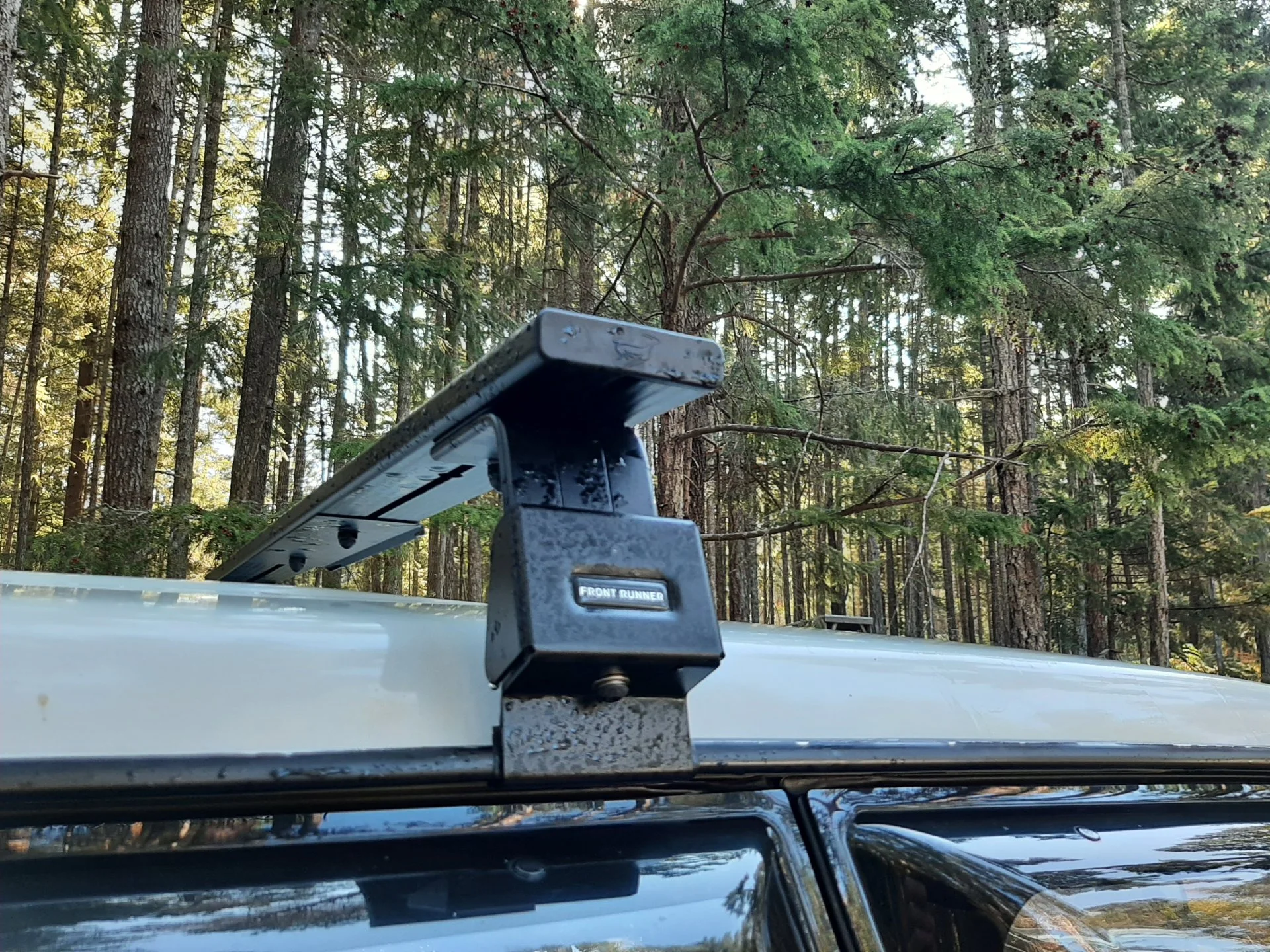

I followed BuggyBoy's suggestion of the Frontrunner Cross Bar kits. I reached out to Frontrunner, and they set up a kit with 3 crossbars. These can fit over the factory rails, and each have a nut in the end that faces up/down, if you get yourself some 3/16th inch thick 2x2in aluminum angle bar you can easily set up a nice sturdy rack by linking the crossbars.

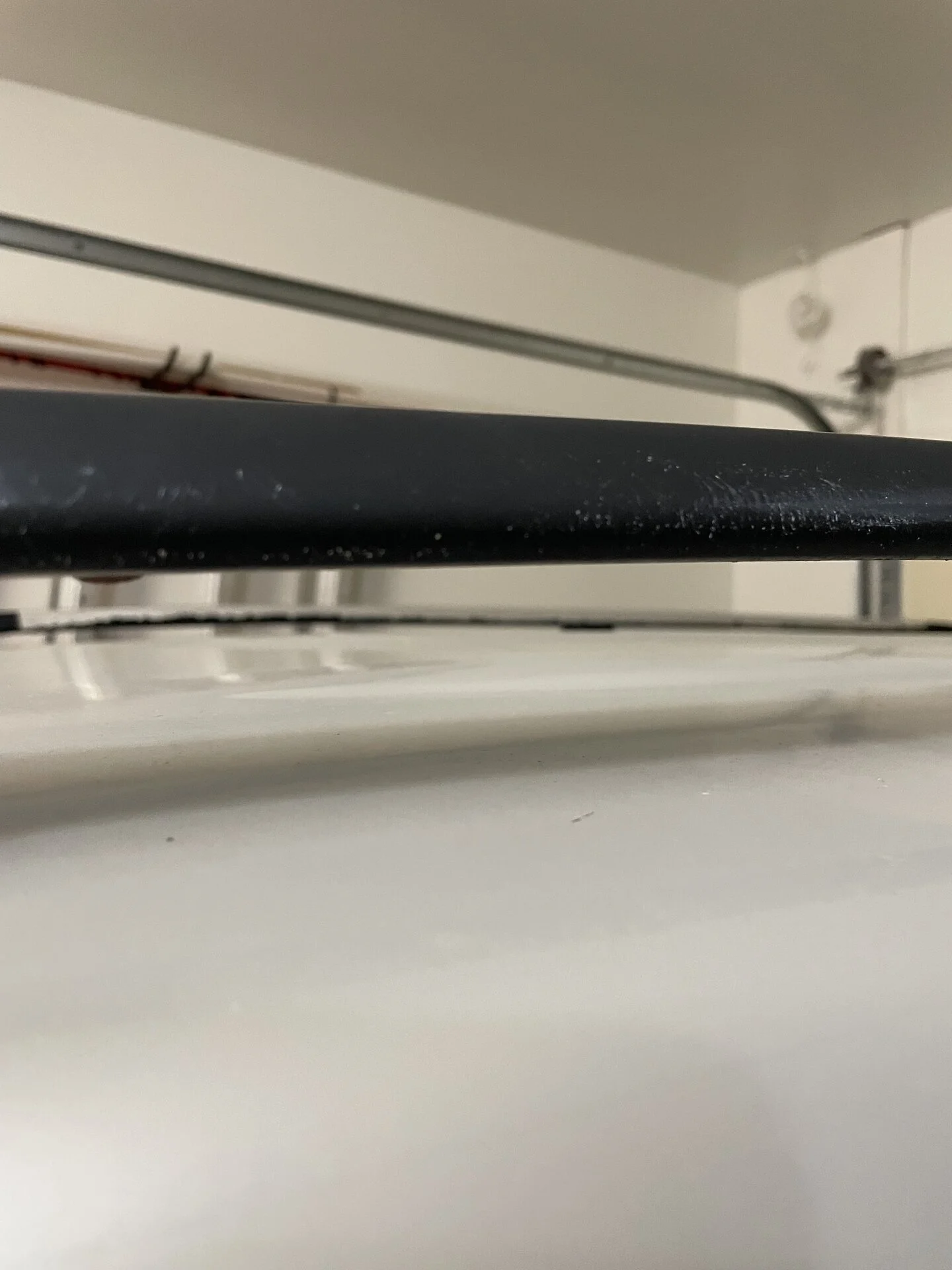

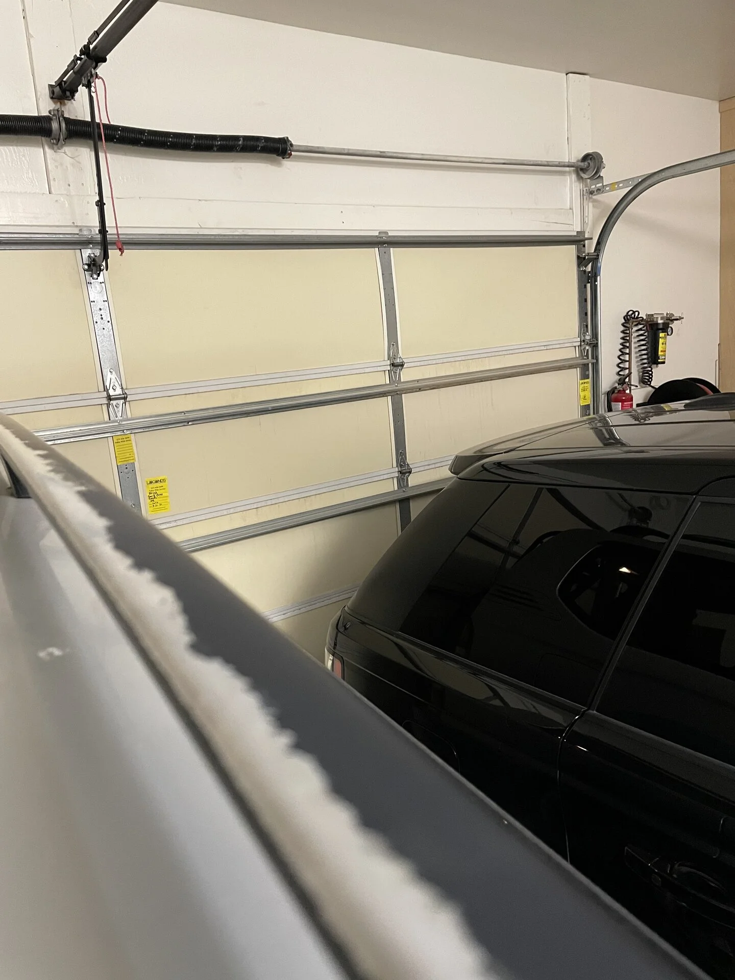

Kinda trapezoidish and yes, they need to be refinished. 41.5" apart between them
Well shoot, looks like you don't have any sort of track on the inside... which means you're left with a clamp-on method, not something that can bolt to the inside of the rail. I think that frontrunner solution mentioned above does it, also maybe you could find a set of Yakima lowrider mounts, if you want to add a set of round bars.
All of my solutions require bolting to the inside channel of the rail though unfortunately. hope this helps good luck!
I ordered a set of gutter mount bars from Frontrunner. If they clear the current bars, great. If not I'll take them off and fill the holes.

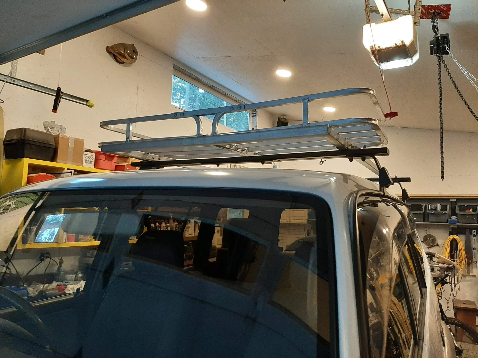

Fit like a glove and the Craigslist Yakima rack mounted right up! Thanks all!
I’ll get pictures posted up later.
