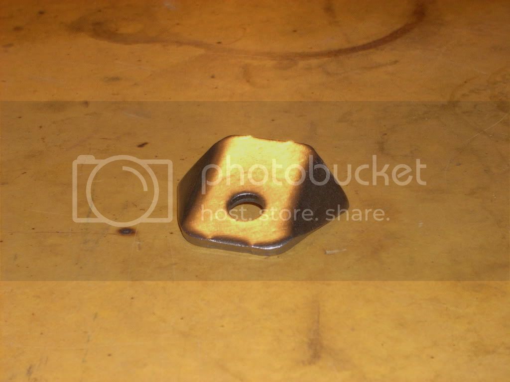

If you had 4 tabs welded on, you could easily bolt a rack on with some long grade 5 hardware.

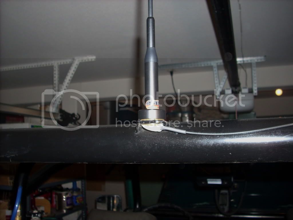

This is similar to the tabs I used for the roof rack
a
In this case I used a tab for my ham antenna. The roof rack tabs are welded the same way. I cut some pieces of conveyor belt to isolate the rack from the cage.

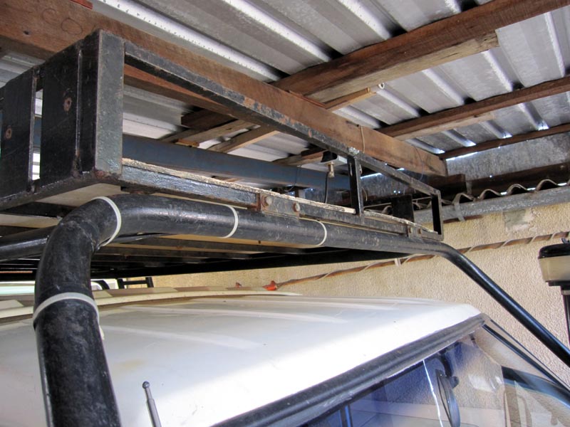

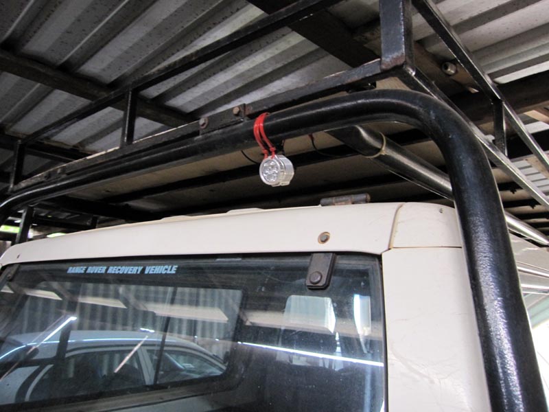

My rack bolts to my external cage with 4 bolts on the front and 4 on the rear. One pair of bolts per section of angle iron (1/4" material).
The cage has 2 pipes that run from the front hoop to the rear hoop.
View of the rear:
View of the front:

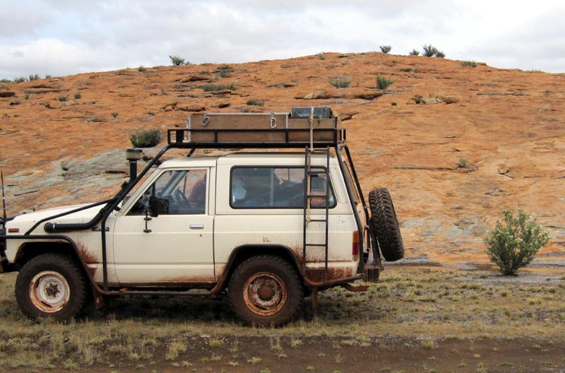

Side view on a trip to the oz bush. The rack has some 1/2" nominal thickness marine ply. It can and has carried a lot of stuff/weight over many years.
Obviously it's a custom rack and was made to fit.
cheers,
george.
View of the rear:
View of the front:
