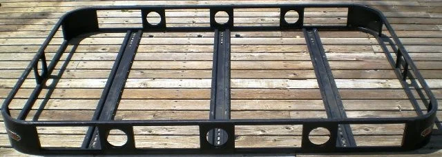

Alright, I've got a 4x6' conferr rack I picked up. I'm looking at flooring options for it.
here's some thoughts...what are yours?
Expanded metal: is nice...but makes it heavy, can rattle
Metal planks: still more weight
Wood floor: plywood flooring, have to seal
Cedar planks: interests me the most at the moment. weather resistant, light
The other "odd" thing I've found is how I'm going to attach the wood planks/or metal/aluminum if I go that route. There is 46.5" between the rails. there are 11 small holes down the 3 rails. They are 4" apart, and the end ones around 3"ish from the sides.
what have you guys done for floors?
attachment.php

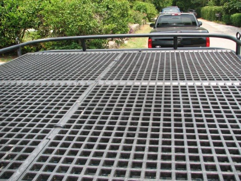

Pound for pound and dollar for dollar it's hard to beat plywood...
X2 on the chicken coop flooring...works great...I first used commercial zip ties to fasten floor to rack... but the sun deteriorates them...used c clamps and that has worked great for me....The floor squares are also pretty light compared to metal....and the elements wont work the material like metal...
Here's pics of the poplar covering. I think it's 2" spacing in between boards, not 1" like I said, and stainless screws from underneath. I don't have pics of the oak flooring in digital format. Ignore the dog in front, she just like to get in front of everything. The chicken coop flooring looks pretty cool, if I knew about that I might have used that instead. I'm guessing you could use some bolts and washers to bolt it down?
Nice, that looks like it works well. I'm off to the store to check out their prices on chickencoop floor :D
