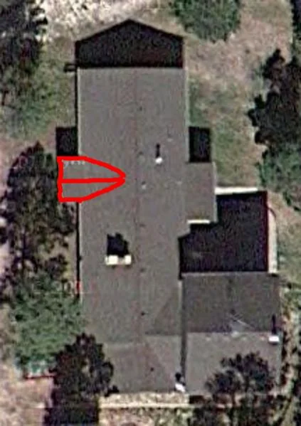

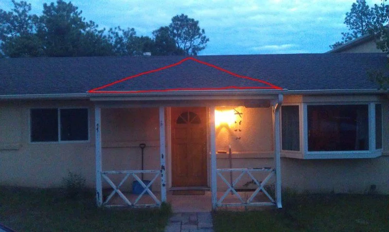

Still waiting on estimates and such, but I may have a problem. The porch roof on the front of the house is very flat - about a 1/12 pitch. The steel roofing brochures I've read recommend at least a 1.5/12 pitch. A roof over a sun room at the back isn't much better - it's right about 1.5/12
So I'm thinking of building a dormer-style roof out over the existing porch roof - see the sketches below. Any advice on how to frame this, or what it's called so I can search better? I've searched on dormer framing and looked in a framing book I have, but everything I've found so far is for a dormer that goes through the roof to add living space, window, etc., or how to frame this sort of thing on a new roof. I'm just intending for this to sit on top of the existing roof. How would you tie it in to the rest of the structure? Would I need to add anything to the existing interior roof structure (trusses)?
