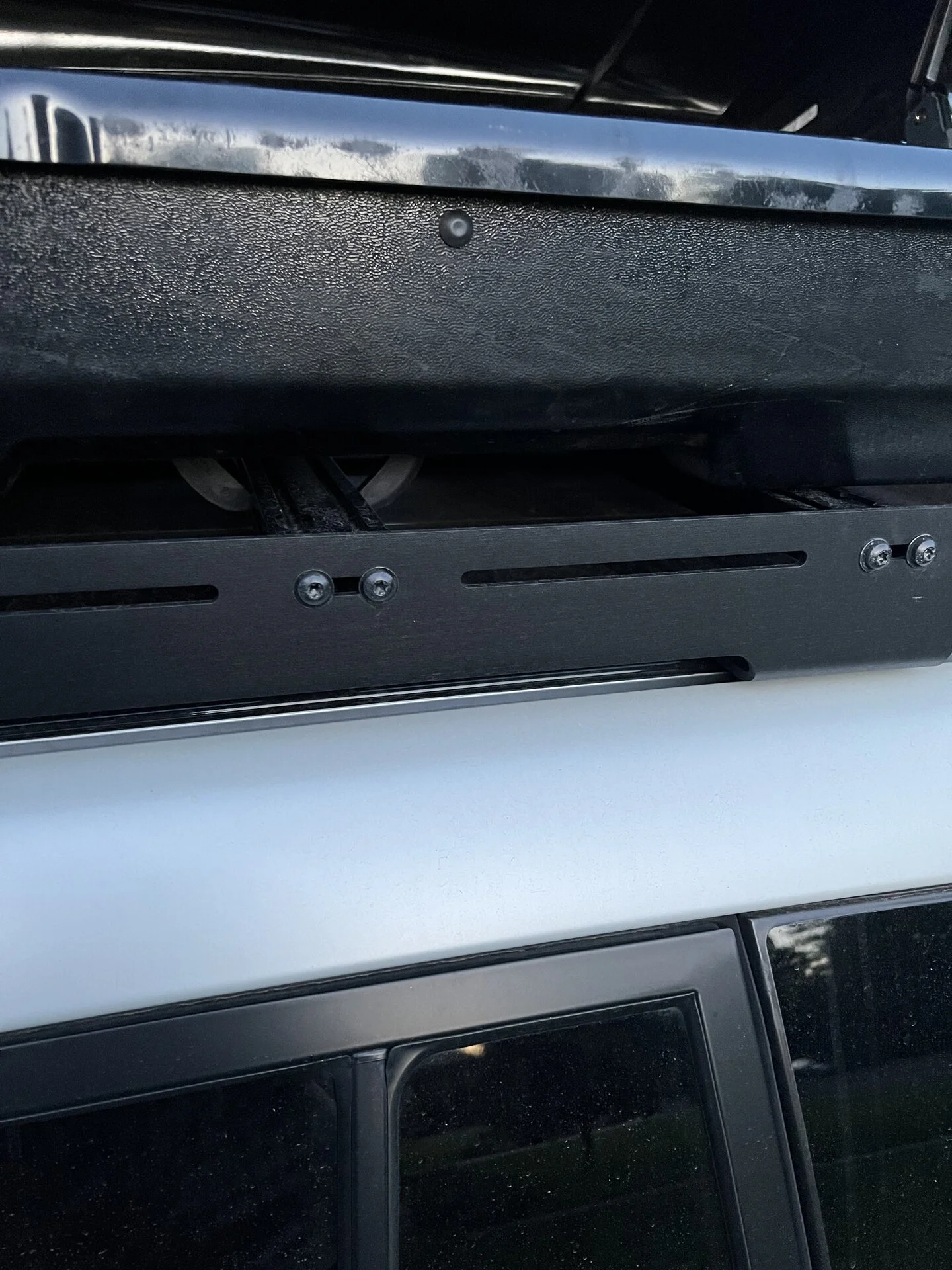

You should be able to throw a carriage/shoulder bolt into the flat rack pointing upwards from the crossbar and use that to secure your roof box. Remove the box's clamps and I'd guess theres thru holes into the bottom of the box. At least my Yakima Skybox works that way.

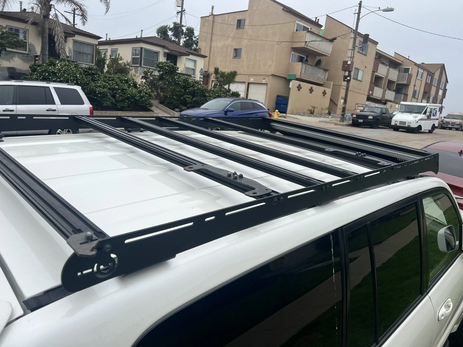

Another option could be putting a different shape crossbar extrusion into the roof rack at the 2 locations for your box. There’s a lot of different shapes on 8020.
The problem isn't the shape it's that Thule box attachment points are recessed so the box fits lower to the vehicle on standard crossbars (ie the bottom isn't flat like).

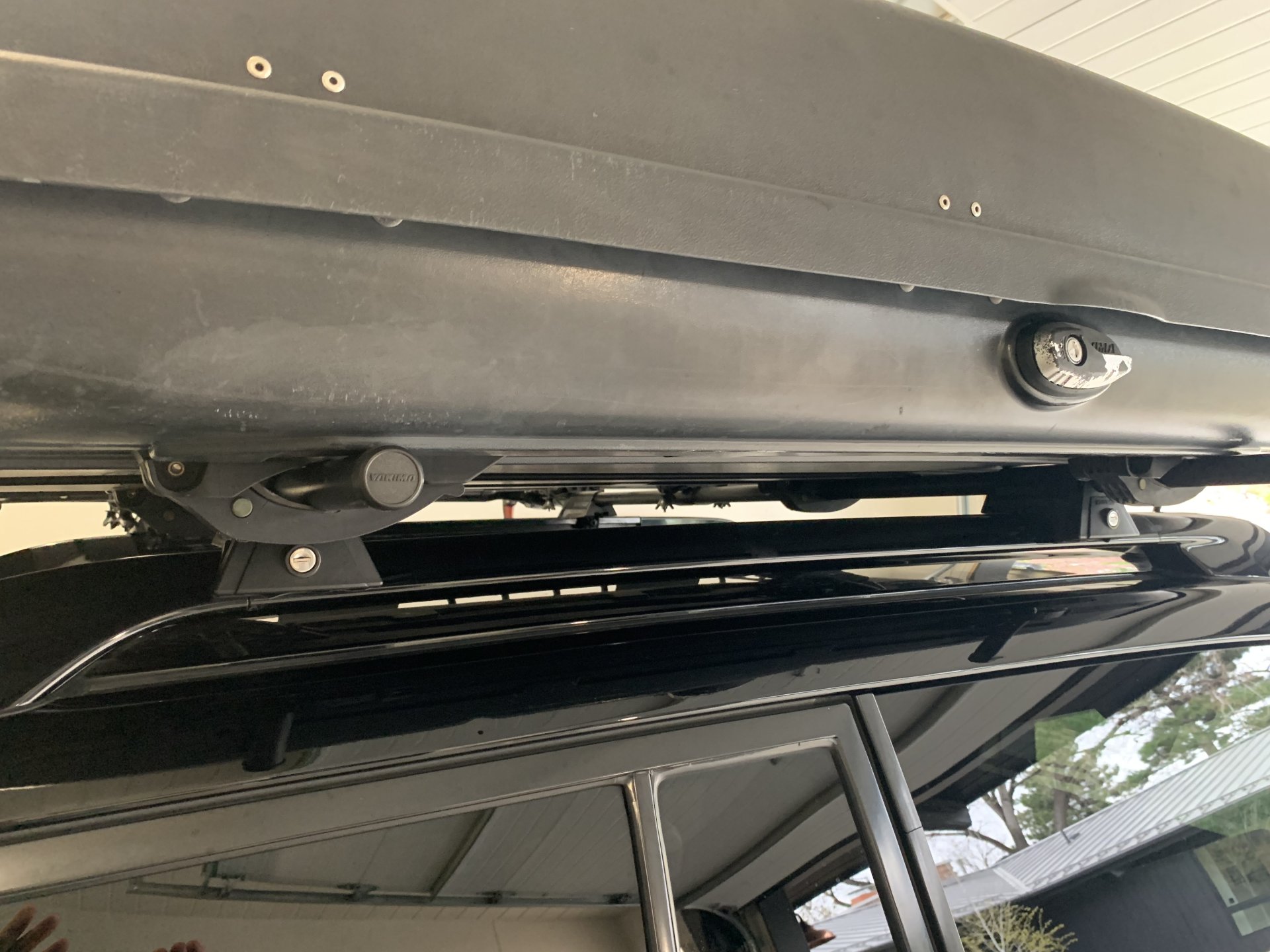

My Yakima Skybox 16 is several years old but I think they still make the same model. Bottom is flat and claws drop below the flat bottom. I’m not running a flat rack but assuming you can get the claws through your crossbars you should be fine with a Yakima.
I just picked up a Yakima Skybox on craigslist, but haven't fit it to the Gamiviti rack - only my other car (BMW E39 M5 with Thule bars). Like the pic posted just above, the bottom is flat, so see no reason it can't fit on my flat topped rack. The Thule models I was looking at, were all recessed and would likely pose a problem on the front/rear of a flat top rack.

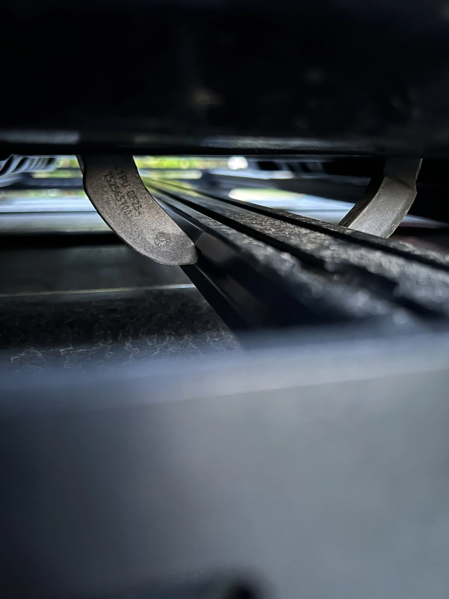

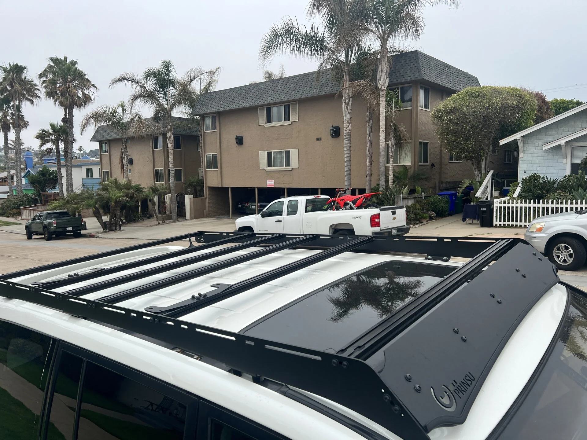

I tried mounting a Thule box to my Prinsu rack yesterday and can confirm the indentations make it impossible. I was able to get the claws to dig their “fingertips” into the gutters on the sides of the load bars and it felt pretty sturdy to me… but then I started thinking about whether I want a roof box hanging on by it’s fingertips going 70mph down the highway and took it off.
If anyone knows of a replacement Thule claw with longer fingers, let me know.
If anyone knows of a replacement Thule claw with longer fingers, let me know.View attachment 3360242View attachment 3360243

To make my Thule Motion XT Alpine box fit snug and clamped securely below top of the rack level, I removed two crossbars: the one 2nd in from the front and the one 2nd in from the back. Lowest portions of the box fall right in as long as claws are vertically slid to the right spots.
