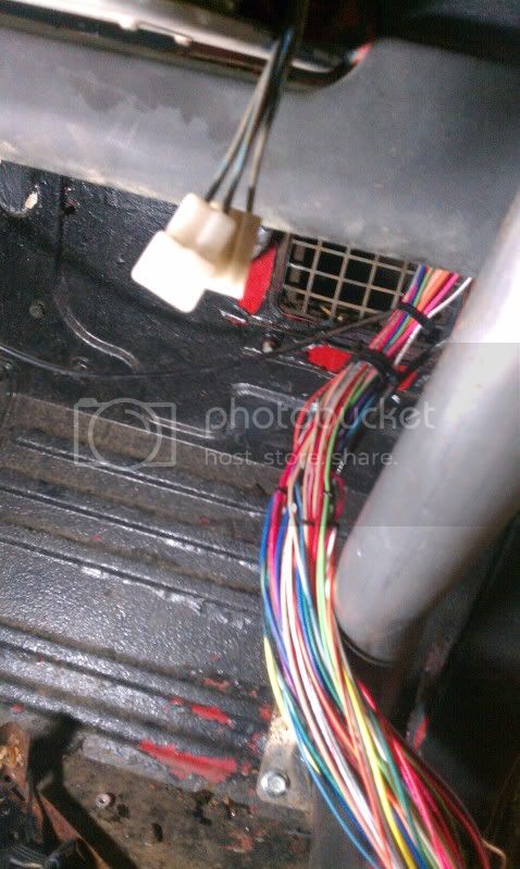

OK, so here's my update
Now I have to remove it, finish welding it, then start on the front halo and uprights, door bars etc.

As for the body flex and all that..... 2 of the 6 portions of floor where the cage muonts AREN'T rotten.
It's been a hell of a long time,. I want this thing done.

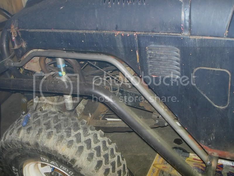

Sorry for being so late on the subject but here are some pics of a friends 40 I built & at the bottom of the page it has the tie-ins with bushings at the chassis points. Previous pages should have the cage build-up pics I think if you want to look for incab ties. Has pics of cage out of body complete sitting on the ground.
https://forum.ih8mud.com/40-55-series-tech/123989-aussie-1978-fj40-buildup-18.html
