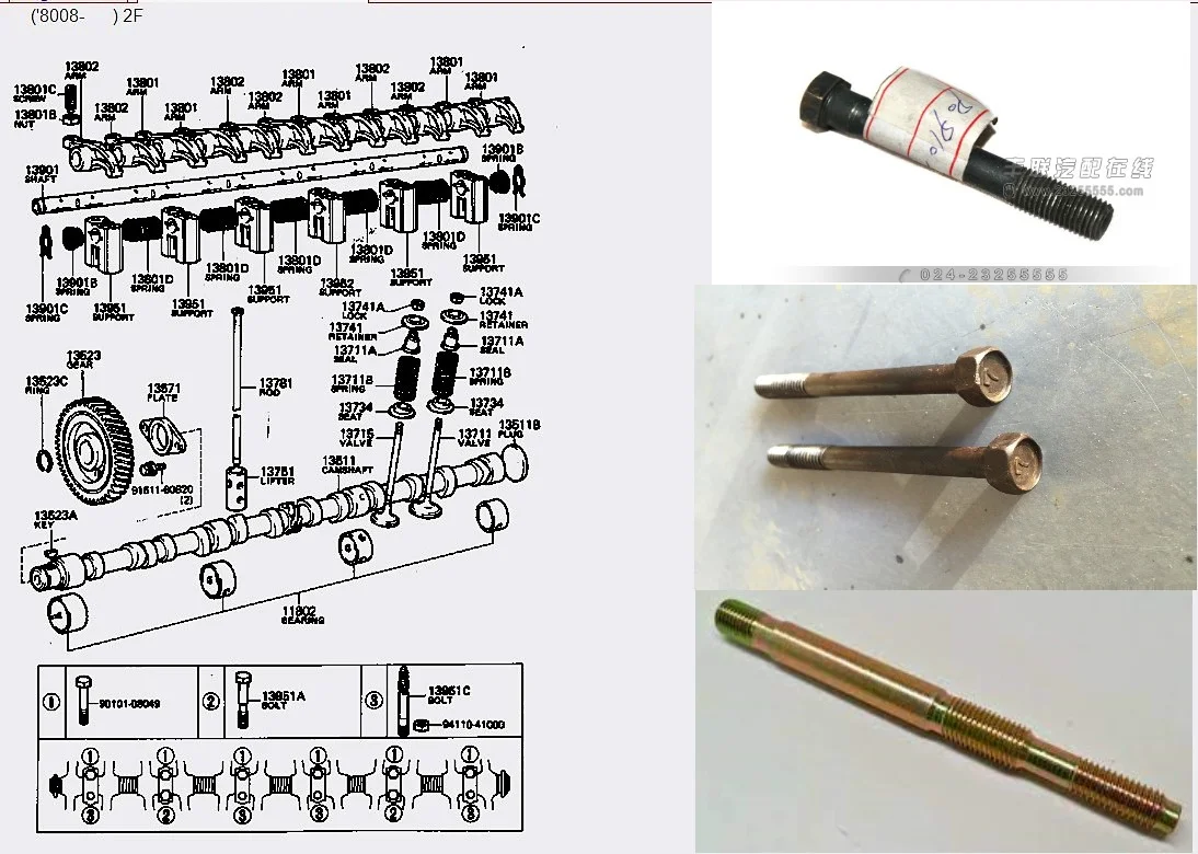

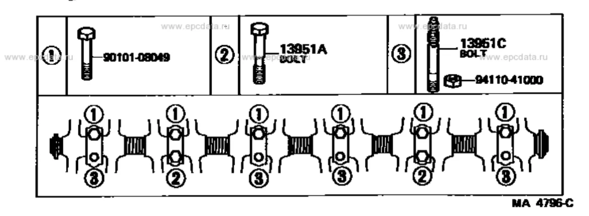

There are three different bolts. Two seem pretty special. You should try to get them from to your I think.
Try to get them from who? The mechanic in LA?
Toyota said all they could get were these "equivalent" part numbers but said they aren't sure if they will be the right length. 90116-08123 for the stud and 911611-60855 were all they could get out of the parts that came up. They couldn't even find 90101-08049 in their system... weird. Spent an hour searching just now nothing other than that so far

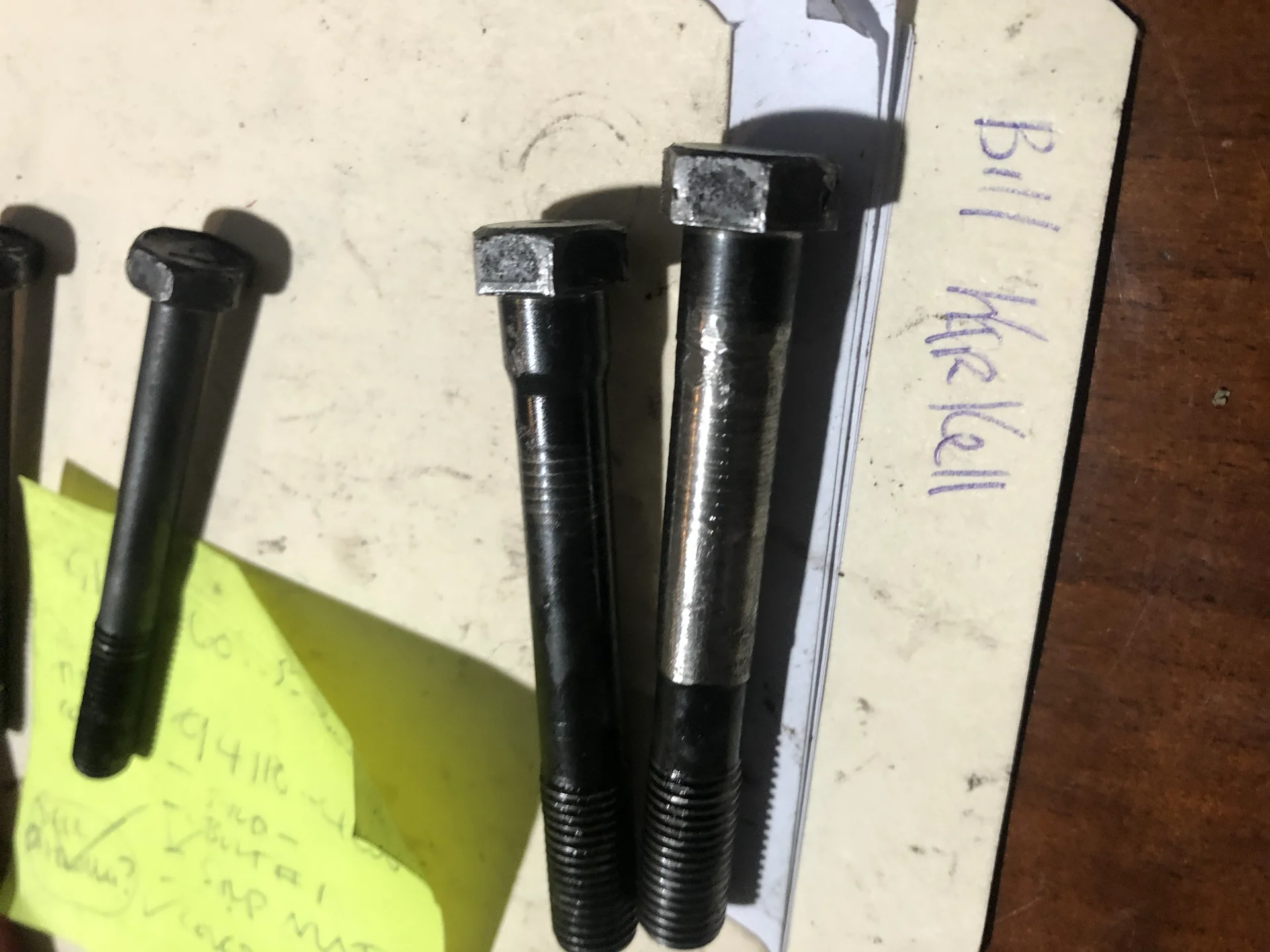

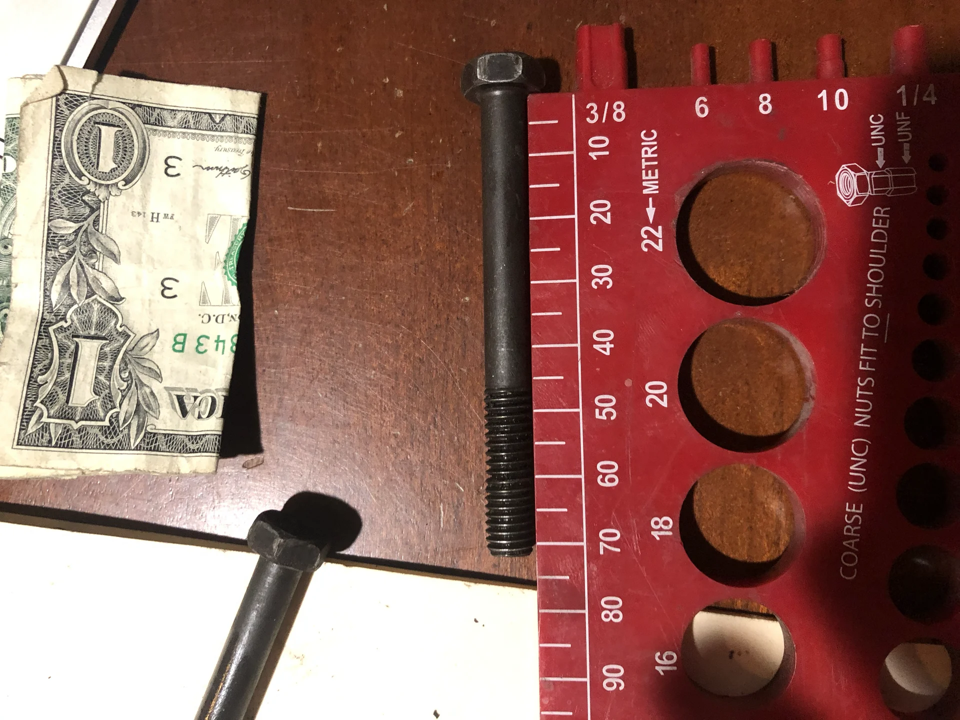

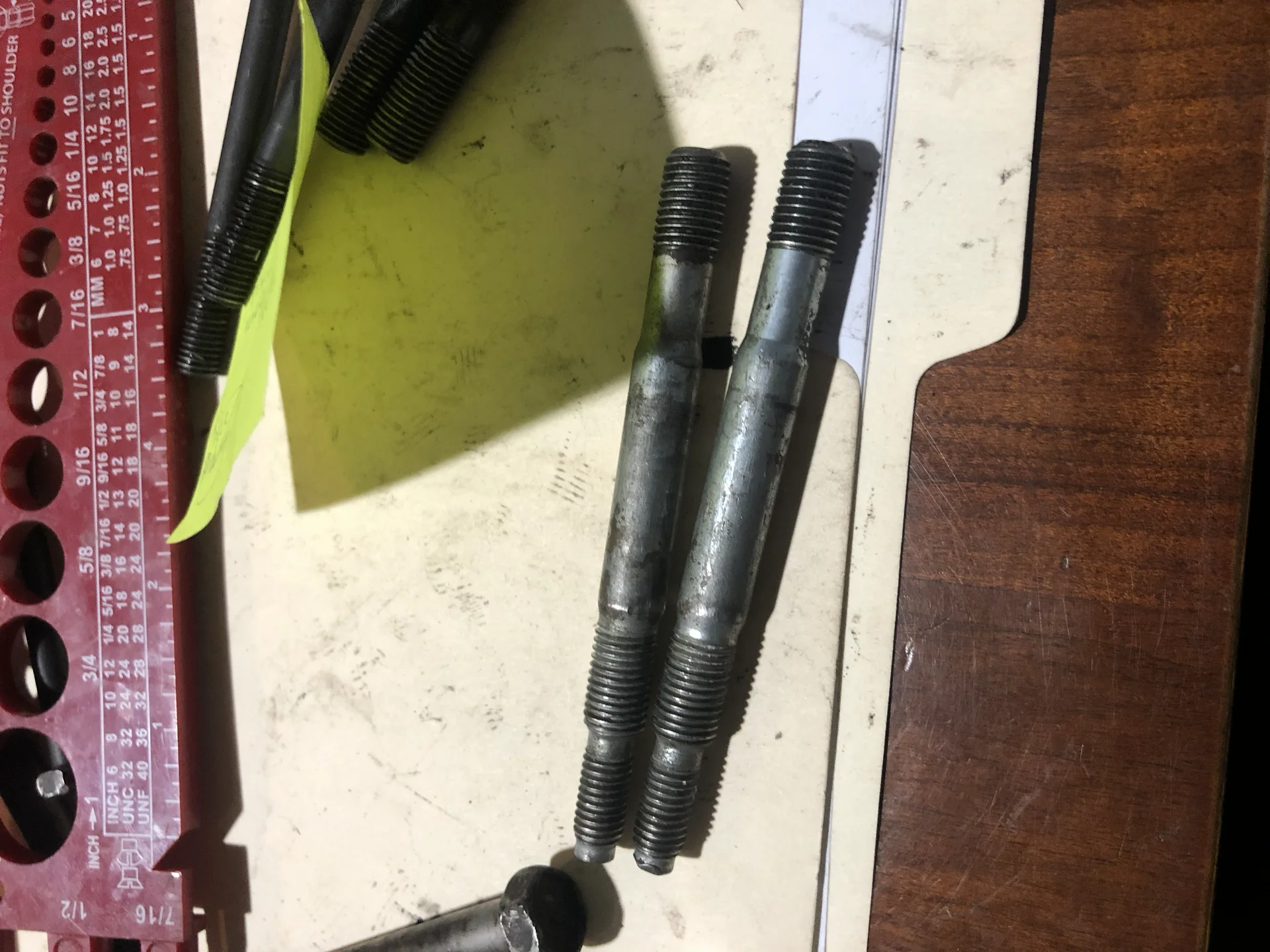

K gentlemen, Been at this all night, I thought I had 5 of 6 rocker assembly bolts but they are just fools gold basically. They were the right diameter and 73 mm like the wider bolts I have for the rights side of the assembly, but their threads don't make it all the way in --- they're just too short for the assembly because the threads are only able to go in halfway before running out of length. Same with the studs, they look almost identical but from going through other threads photos those appear a bit longer.
Besides the Bolts that go into number 5 and number 2 on the right side, (73 and 75mm x 10mm is what I have) im going to need new bolts, studs, washers, and the 4 nuts that go on top of the cover.
Took a lot of diagnosing and measuring to figure this out (assuming im right) either these studs will be used later or the guys who shipped my project are shaping up to fully be the idiots I thought they were and put the wrong studs in the bolt box, (I wouldn't put it past them as they sent me 2 fly wheels, 2 starter motors, and solenoids -hoses-and fans for the wrong vehicle entirely.

Figured it out. Ive got a 40 series rocker that came with the rig, but the 60 series bolts, studs etc. I think they must have just really torques these shorter bolts, not sure how they got a way with it.
Im trying to figure out next steps, my budget just got smaller and I don't want to buy a new rocker if I don't have to. Maybe I could do a trade?
The last concern is the spring and valve height and which rocker assembly it is set for.
Is it a REALLY bad idea running with the 40 series rocker and 60 series bolts as before if it fits the valves?!
