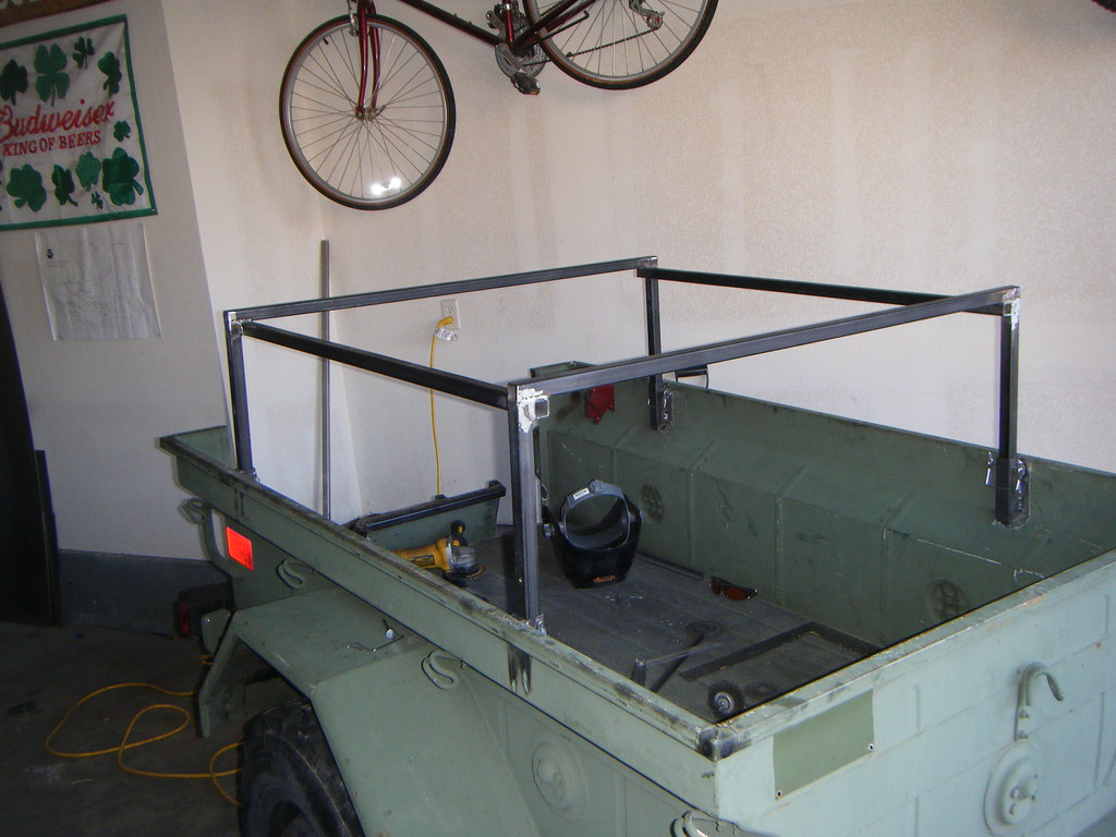

Eventually I want to put a nice lid on this but for now I have put together a removable frame to hold our roof top tent.
The frame is 1" sq 11ga tubing and the receivers it fits into are 1.25" 11ga square tubing.

I figure with this set up I can take the frame off and use the trailer for all the landscaping and general junk I need to tow around this summer until I make it a dedicated camping trailer.

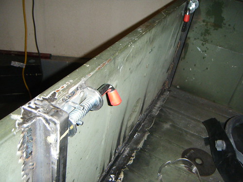

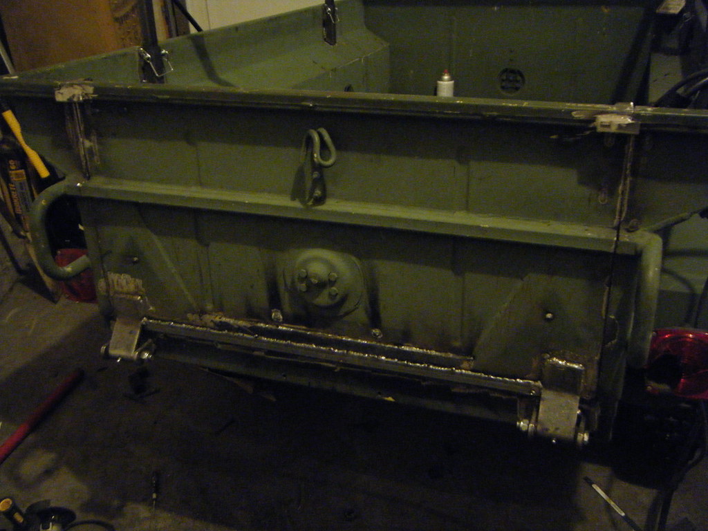

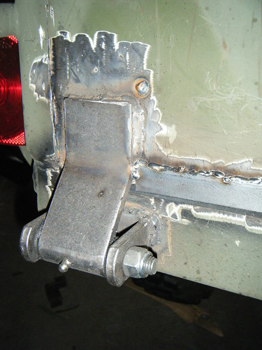

Next step was to cut a tail gate, this was about like cutting the hole for the snorkel on my 80 series, you know if you make a mistake you are living with it from that point on.
I used the ideas from others on the forum on how to weld up the tail gate.
I wanted a smooth transition out of the bed of the trailer so I welded the bed to rear frame and then weld filled it in to make it flat.
I found some heavy duty grease-able hinges from Northern Tool

So I think I have most of the welding done now, now I have gobs of grinding to clean up all my crumby welds.

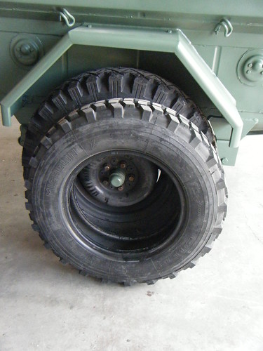

The tires on this trailer where original and look like new they even still have the rubber whiskers from the mold but unfortunately they are dry and cracking in the side walls and I can't find a a spare the same size so I decided it best to replace them.
I am going with Cooper Courser Traction LTs, they are 7.5 x16 so they are about 2" taller and a little wider than the stock tires but it will keep that same look.
Next step, grind , grind , grind, then get the tires mounted and then pack the bearings and I should be ready for its first trip out!

Has anyone checked Coker Tire for the unitred military tires? Pretty sure they are repoping them from original molds. Not sure on pricing though.
I checked the Coker tires out and almost went that direction, but I don't know a lot about tires and if I went with Cokers I would have to use tubes. The tires on this trailer where tubeless so I was not sure if tubes would even work with them. The cost of the tires was around $90, tubes were about $15.

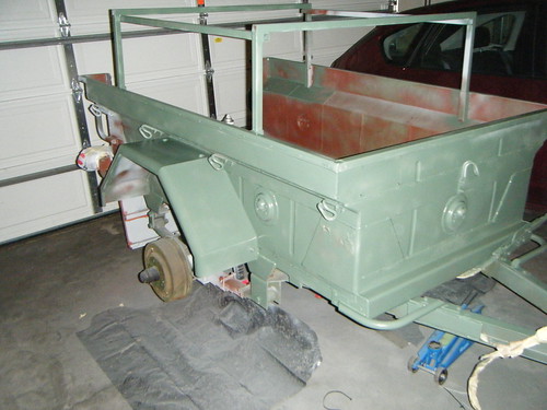

Bearings repacked, one side had been done recently and the other looked like the original packing...WT:censor:, who does one side and not the other at the same time? Synthetic grease and new bearings and it looks good now.
Clunked my head on the spring hanger under the trailer while painting, man that hurts:doh:

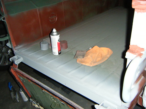

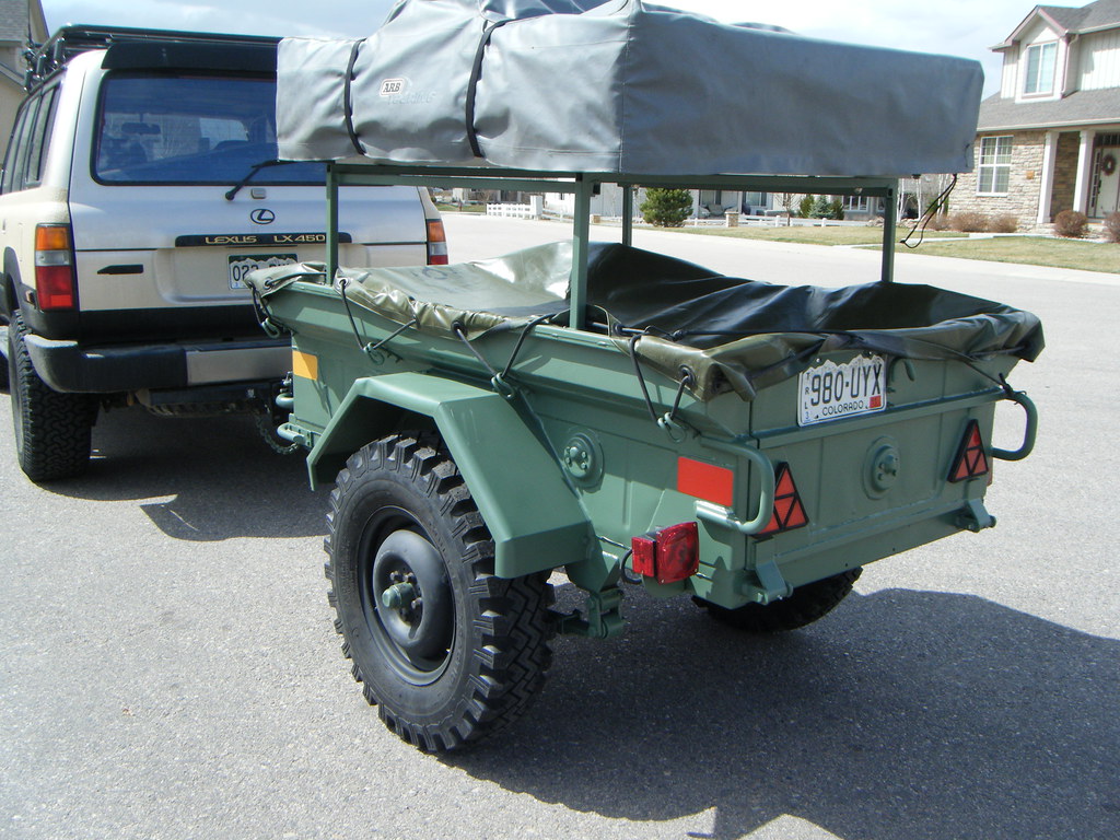

Painting is done, tent is attached, just need to get new tires mounted...
I am not sure about the tent height above the trailer, I will give a test run next week and see if it is too tippy. It is easy to shorten it with it pinned on. I also need to figure out some type of stabilization / leveling leg for the trailer when the tent is deployed it rocks when getting in the tent.
