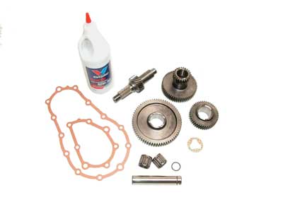

They say there is no change in high range and from what I can see they come in full or part time...
Landcruiser Rockhopper Full time
The Rockhopper low-range gearset replaces the standard gears in your transfer case.
High Range is unchanged while Low Range is reduced by 45%!
* Conquer obstacles at much lower speeds
* Gain increased throttle control
* Control ascent and descent of steep hills and rock ledges
* Enables use of larger diameter tyres
* Reduces driveline stress
* Provides an economical way to increase your 4WD performance.
Due to the nature of driveline modifications, the stresses of competition/offroad use/abuse and the many uncontrolled variables in what people consider to be reasonable use, we do not offer any warranty on drivetrain components whatsover.
Fitting is simple! Remove the transfer case, take the old gears out, put Rockhopper gears in, refit the transfer case, fill with oil, enjoy!

What I like about these gears is that you get a part time conversion as well as the lower gears for the low end. That to me is a great deal for the price.
I like the idea of killing two birds with one stone and also not having to regear the diffs and the ability to keep them stock.
