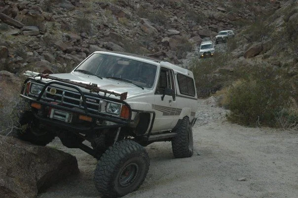

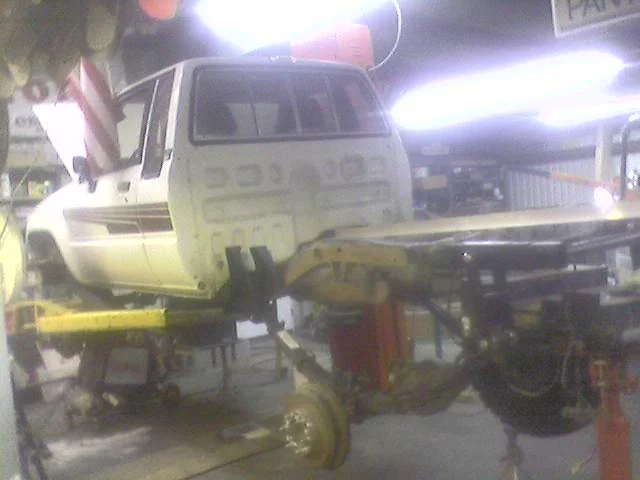

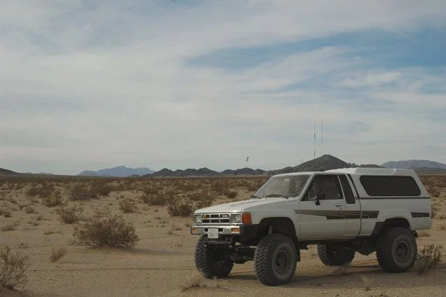

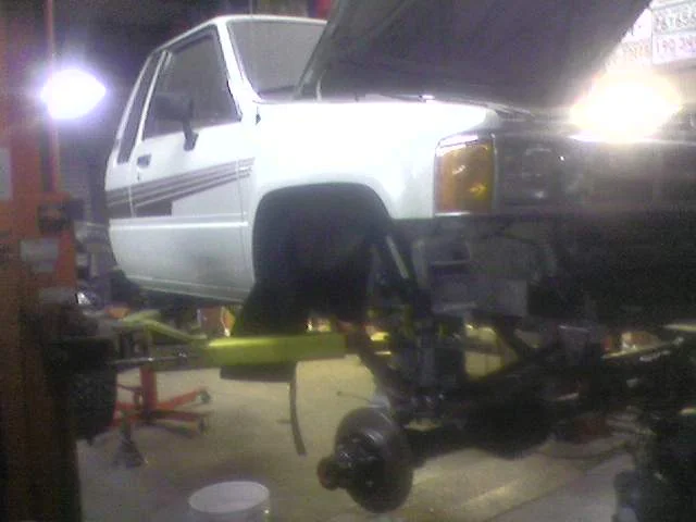

Snapped a couple more pics tonight. It looks tall because its at full droop, but according to my measurements, I'm at about 3.5-4.5" taller than stock.
Whats left before Im driving it again:
Rebuild transfer cases

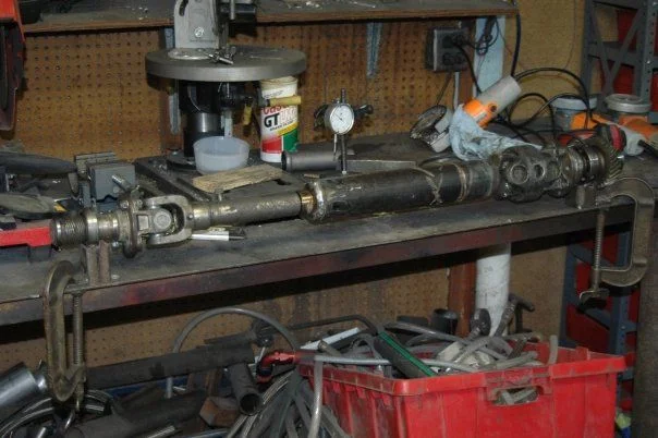

Make driveshafts
Make rocksliders
mount shocks
mount aux fuel tank
Mount Purporting valve
bleed brakes
Mount last 35" on the beadlock
Its almost there
Rolled the truck out of the shop thursday night.
Friday I was on the highway, and put almost 1,000 miles on it by Monday.
Overall im pretty happy, but I have a few problems:
Pitman arm is too short, and the box needs to be moved. It won't turn lock to lock, pitman arm hits the spring, and the drag link end hits the tie rod.
Rear springs are too soft (stopped by deaver, and Jeff is going to rebuild them for me, needs 2-3 more leafs per side to make a 14 leaf pack).
4wd shifter lever snapped off.
Only getting 13.5 mpg at 75, and 17 mpg at 55. I got 16-18 at 75 with 4.10's and 31's.
Need softer bumpstops (thinking timbrens in the rear, and S-10 blaster bumps in the front).

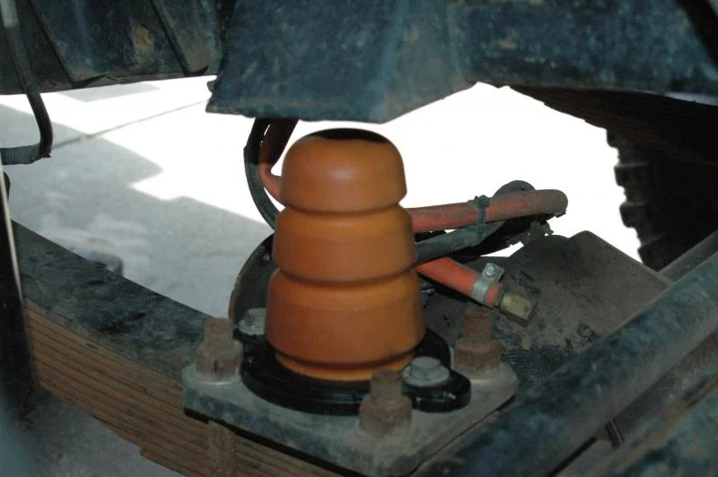

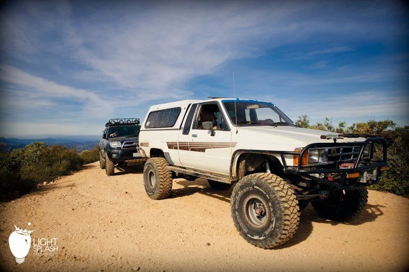

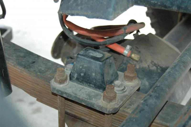

Started working on the old girl again this morning. Managed to squeeze in a few minutes to install a set of much-needed bump stops. Pulled off the old hard polyurethane bricks, and tossed on a set of modern micro-cellular compression bumps. Whats crazy, is that even thought the microcellular is taller, it compresses further than the old ones.
Hopefully I'll get the time to toss in a replacement transfer case today, and rebuild the steering box in the next few weeks.
Great truck. love the low SAS! did you have any issues with using High steer? I know some have problems when they do a "low" SAS

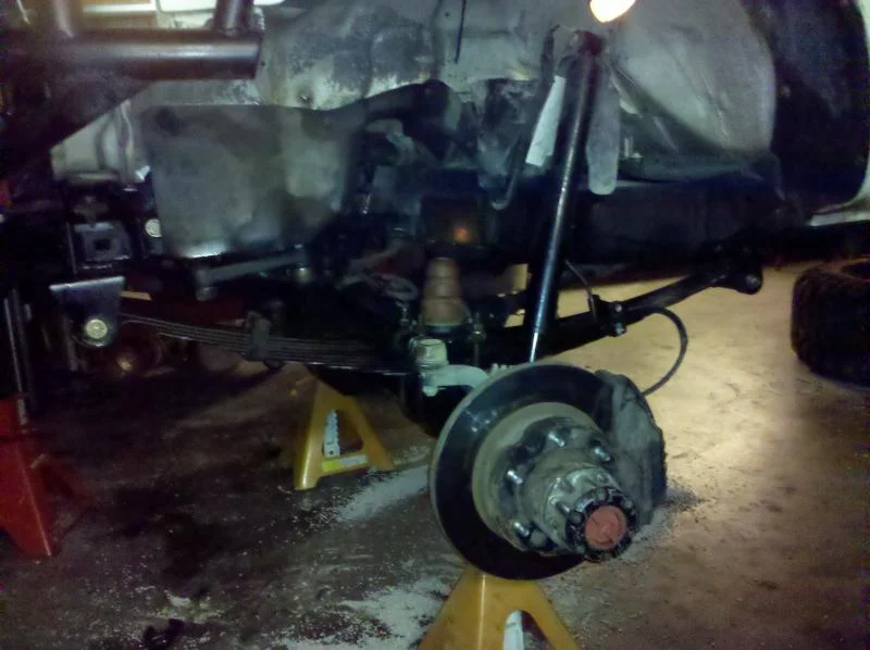

Its tight, but it fits. If I did it over again, I would have installed a 1.5" drop hanger instead of a 1" for more clearance.
On full compression, the tie rod and drag link hit the frame. Then also at full compression the steering box sector shaft and pitman arm tie rod end hit the spring.
Plus, I set the box too close to the frame, and the threads from the tie rod end hits the frame.
As you can tell, I have about -1/16" clearance in every direction. But it works.
I'll try to get pictures of the clearance later this week.
