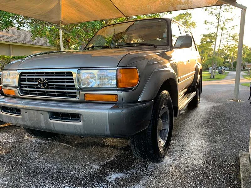

Here are some pics of it now:

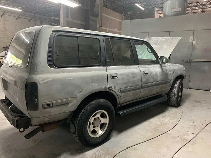

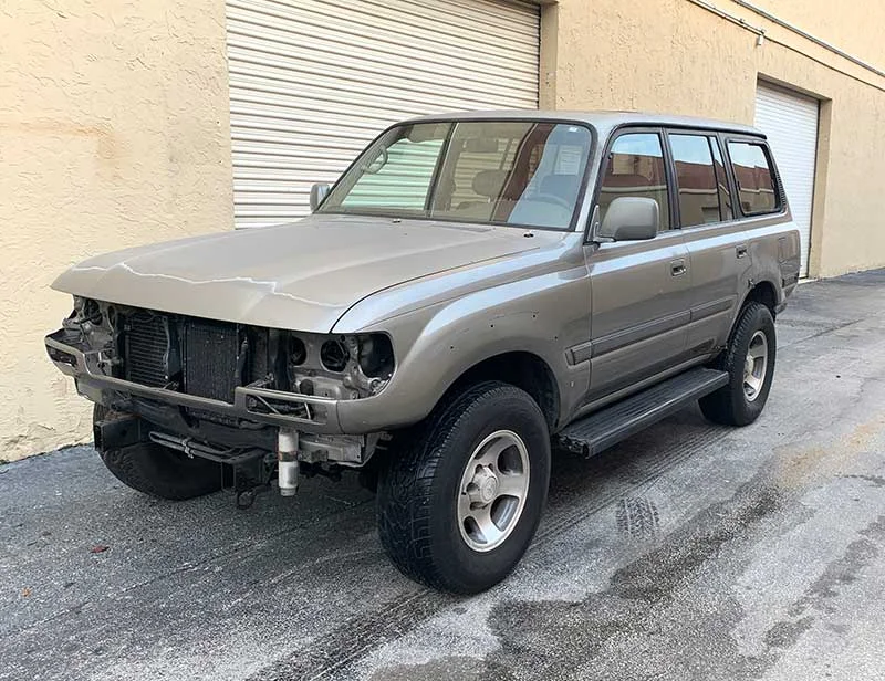

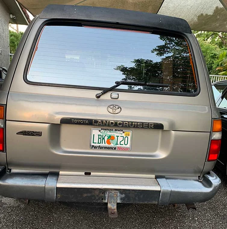

I spent about 8 hours this weekend taking off bumpers, fenders, etc to get it ready to drop off at the paint shop. I'm going to stick with the stock Sage color since doing a color change was going to cost me $6-8K. By doing some of the work myself, the paint is only going to cost about $2K now which is reasonable.

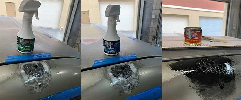

After removing the rear wind deflector I found some rust and decided to POR-15 it and cover up the holes. So the wing is not going back on. Luckily, this was the only rust on the entire truck.
I also decided to remove the roof rack and rails. The nutserts we're in good shape and not rusty, so I sanded down the area to the bare metal, filled them with JD Weld and POR-15 over them. The paint won't look perfect over them, but it's good enough for an old truck. Who knows, I may end up putting a big roof rack at some point and you'll never see them again.

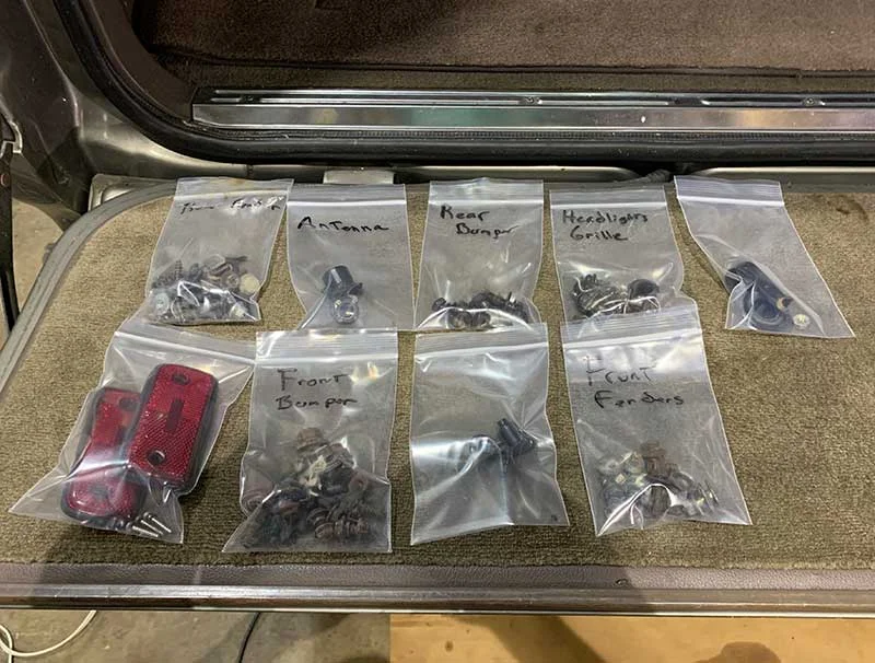

I usually end up with lots of extra nuts and bolts when taking things apart and putting them back together, so this time everything went into a labeled baggie and will get filled with some apple cider vinegar for a few days to clean them up.

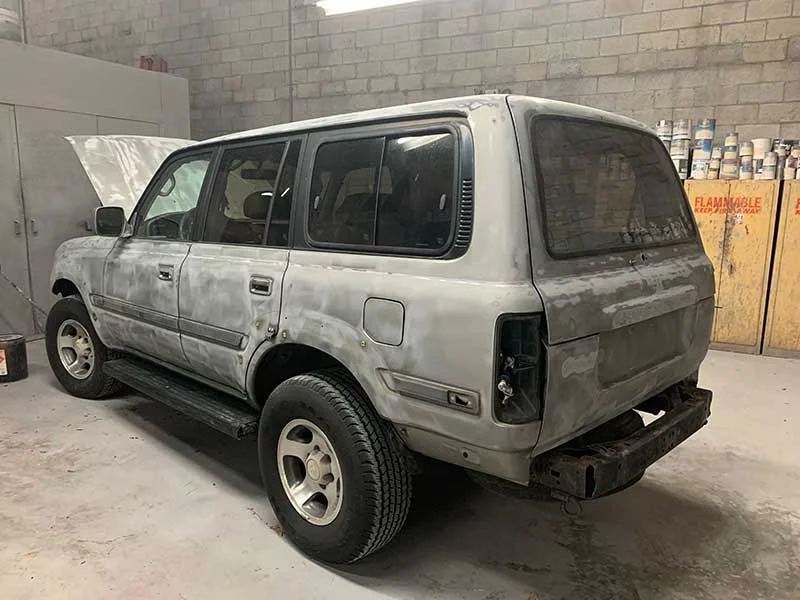

She's off to paint and should be done by the end of the week. In the meantime I'll order a Slee front bumper which appears to be in stock and a 4x4 Labs rear which will take 6-8 weeks (unless someone has one for sale).

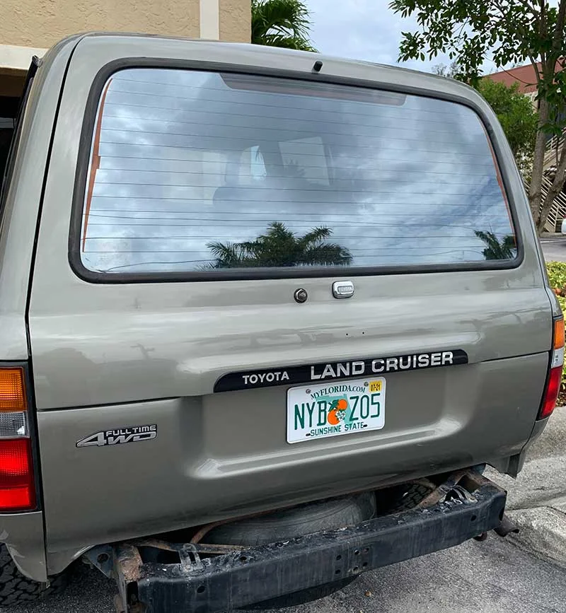

Land Cruiser is back from paint and it looks great. It still needs to get wet sanded and buffed. I attempted to do the rear hatch prior to installing the new badges, but it appears it's going to take longer than I anticipated. I probably should just have paid someone $400-500 to polish it, but I kinda wanted to try it myself and learn how to do it. I spent about $150 on sandpaper, polishes, pads, etc. I'll most likely end up f**king it up and then paying some to do it right. I never learn...

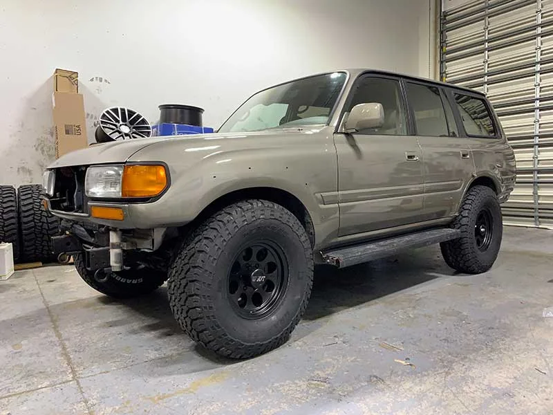

Local shop mounted my wheels and tires (Mickey Thompson Classic III / General 315-75-16), but they were too backed up to do the Ironman 2" lift, so I'll have to bring it back next week. It looks wayyyy better with the wheels on already.
I spent about 2 hours wet sanding and polishing the rear hatch before installing new badges. I"m hoping the hood and fenders are a little easier since they don't have as many curves. I'm doing 2000 then 3000 by hand, followers by M105 and M205 on a polisher at 1500rpm. I also tried my Porter Cable DA, but it didnt seem to work as hard at the polisher.

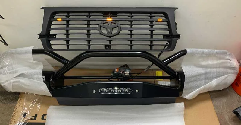

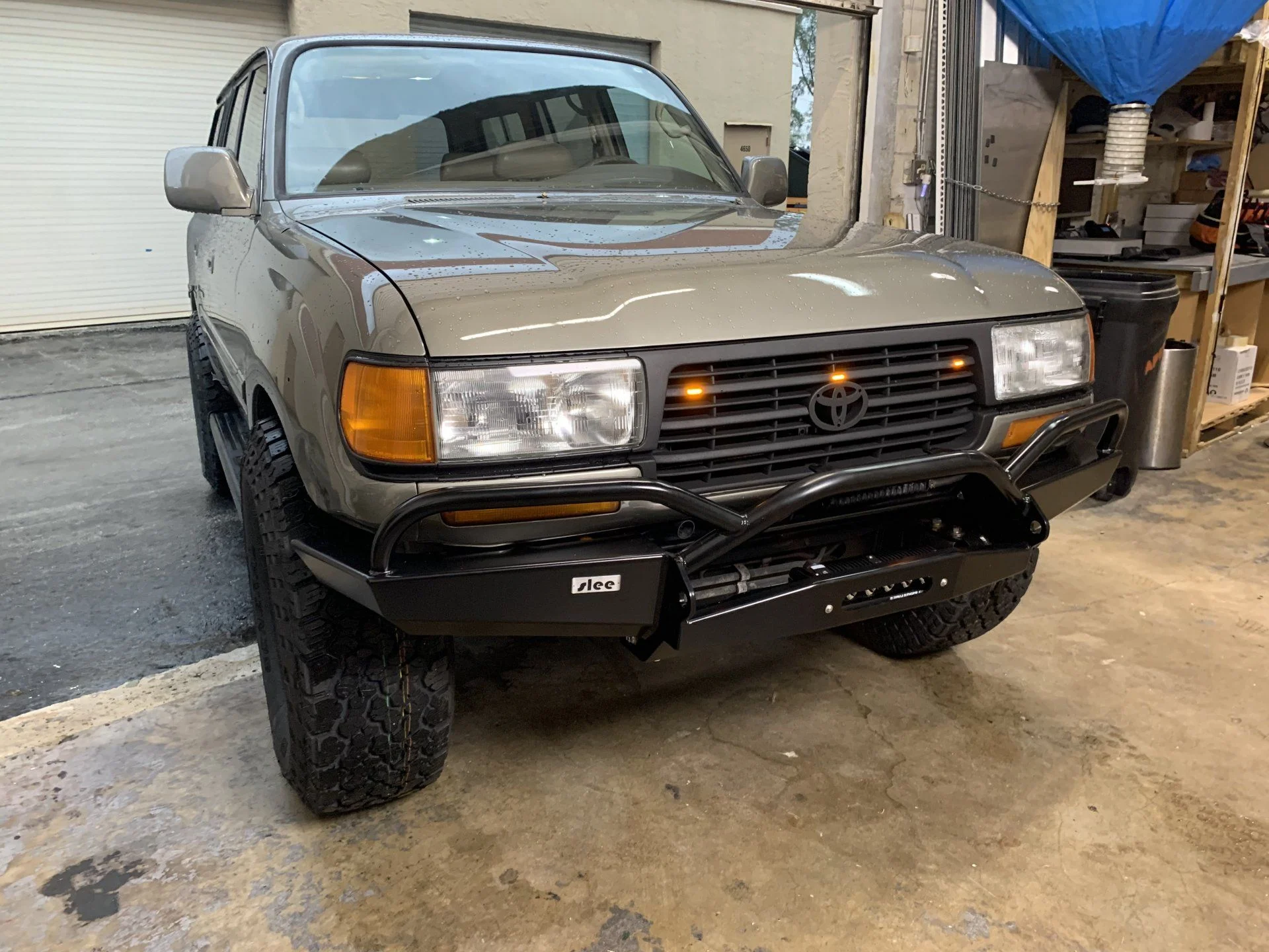

Look at what UPS dropped off this morning! I've purchased much more expensive bumpers for previous trucks, and this is the best packaging I've seen. Great job Slee.
I painted the grill black and managed to integrate some amber LEDs like some of the new TRD trucks. It took a few hours to make it look like it came like that from the factory, but I think it was worth it. The LEDs we're a little too bright at first, so I added a small diode to drop the voltage to about 9.5v.
The winch area received a 10" Rigid Radiance light bar. I tried installing a 10" E-Series which is brighter, but the 2 rows of LEDs didn't look right in that small opening. The single row of larger LED reflectors of the Radiance is about the same height as the opening, so it looks pretty good.

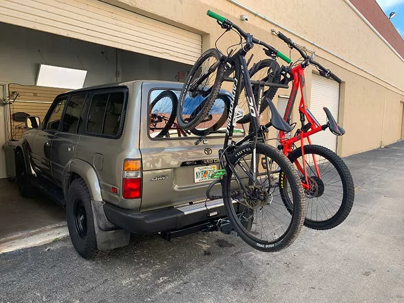

I installed a Curt hitch which bolts to the rear frame. It was by far the easier and non-problematic thing I've done on the LC. Took probably 30 mins. I can now install my brand new NorthShore NS4 bike rack, which took about an hour to assemble. So far I think I like it, used it over the weekend with 3 bikes and it was a breeze to hang the bikes and then open the tailgate. It's a little heavy (50lbs), but it's still lighter then all the other vertical racks I looked at.
The previous owner had butchered some extra holes in the rear bumper where the 4 factory hitch holes were, so I decided to do something about it. A Rigid SRQ Backup light fits perfectly after cutting through the thick ass steel.

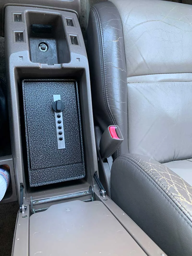

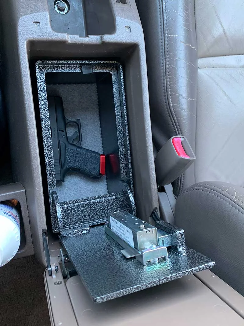

I also installed a Fort Knox pistol safe in the center console after reading on here that it fits perfectly. I can now safely lock up our stuff when we're out on the trails biking. It also fits my G26 and G43 just fine. Not sure if it would fit a 1911 or G19, I guess I'll have to try.

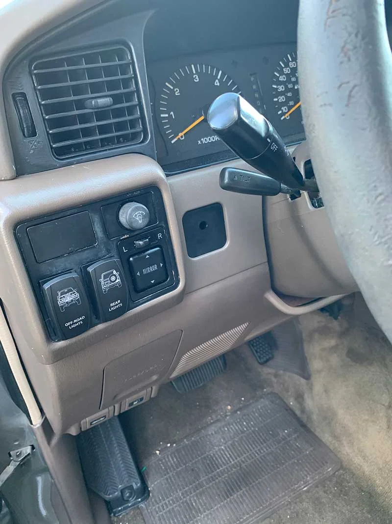

I then wired up the front Rigid 10" light bar and rear Rigid SRQ using the CH4x4 switches. Somehow this took me half a day.

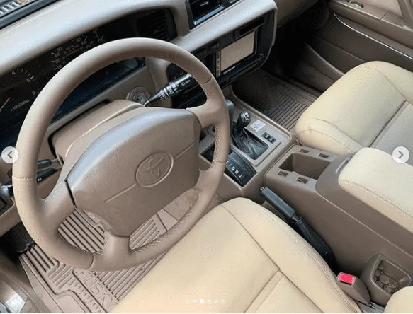

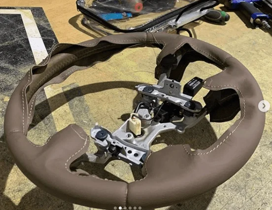

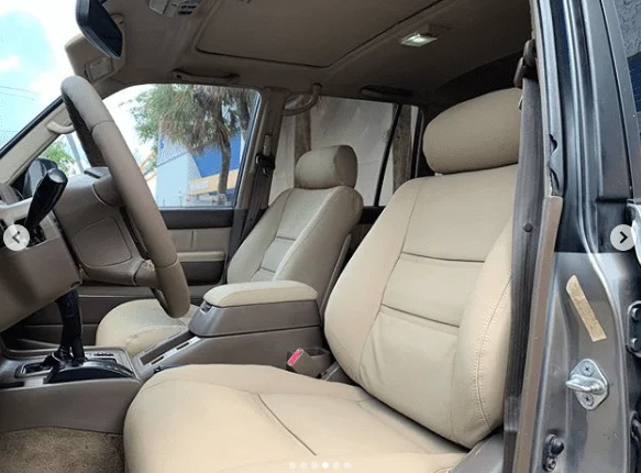

I got a bunch of stuff done prior to our trip, but the most important was to get the leather done as there is no way the wife and kids we're going to ride in the torn up leather interior. I had received the front seat covers from Lseat.com weeks ago, but my local upholstery shop had been swamped with work. They eventually got me in and did an amazing job. They also re-upholstered the steering wheel with some Lexus leather that matched the closest. They said the quality of the Lseat covers was ok, just a little dehydrated, and to keep applying lots of leather conditioner to them to soften them up.

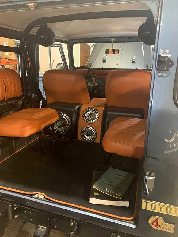

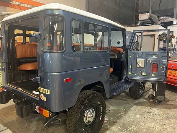

This beautiful FJ40 was also in there getting a $30K interior/stereo done:

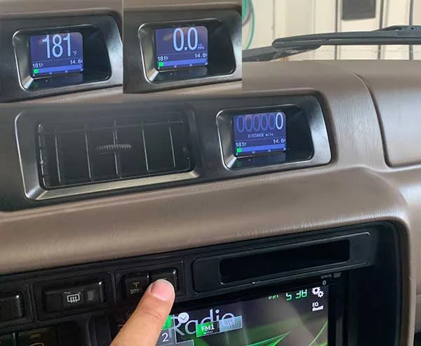

I also got rid of the clock and replaced it with an OBDII gauge that I took apart and soldered the switch to my antenna up/down button that I no longer use (put in a fixed antenna). This allows me to flip to MPG, TEMP, SPEED, RPM, etc as well as read codes and clear them. It's pretty neat, but it didn't come up with this myself, I saw it somewhere on here in an older post.
