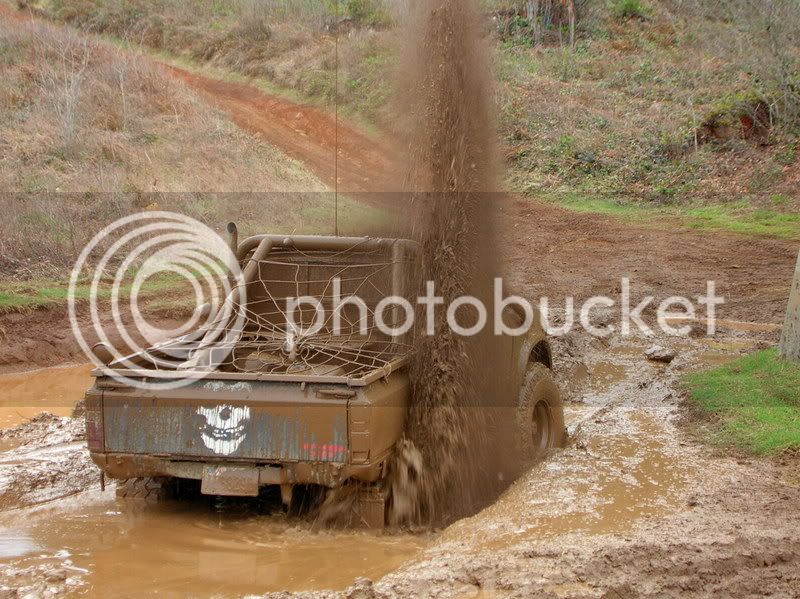

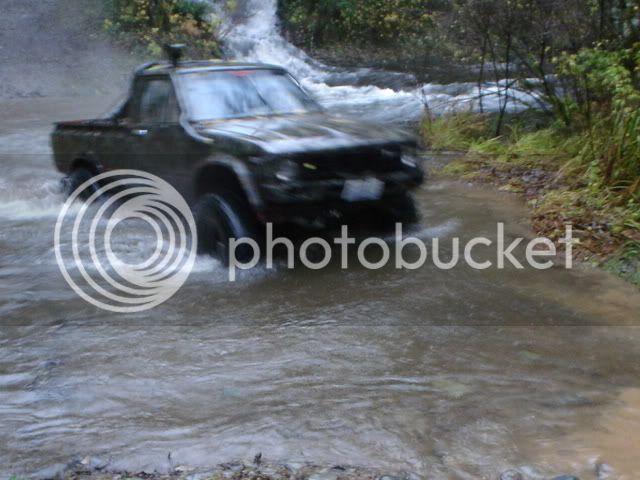

meet the meat mobile
this one kinda shows the smoke in action. it was nippy that day

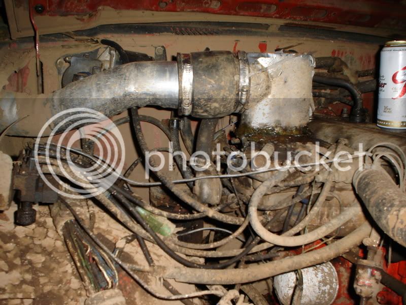

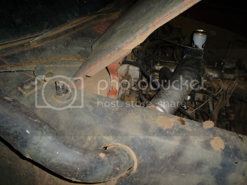

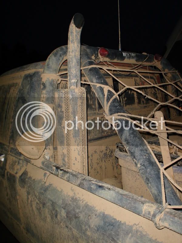

and in case you wondered about what the intake looks like: ( btw this is gonna be eliminated, i am currently fabbing a oil bath/water trap filter that will be much more efficient. cause currently i have a filter i cut into a 3" circle i inserted in there)

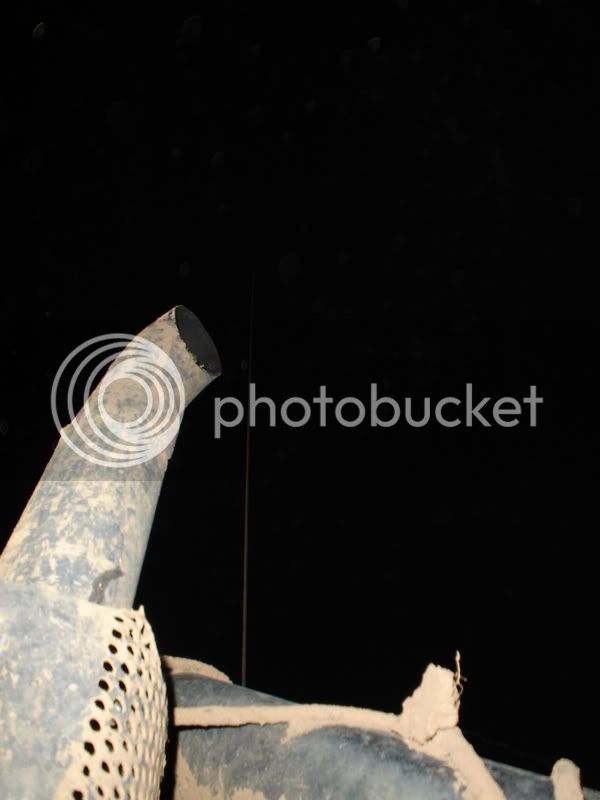

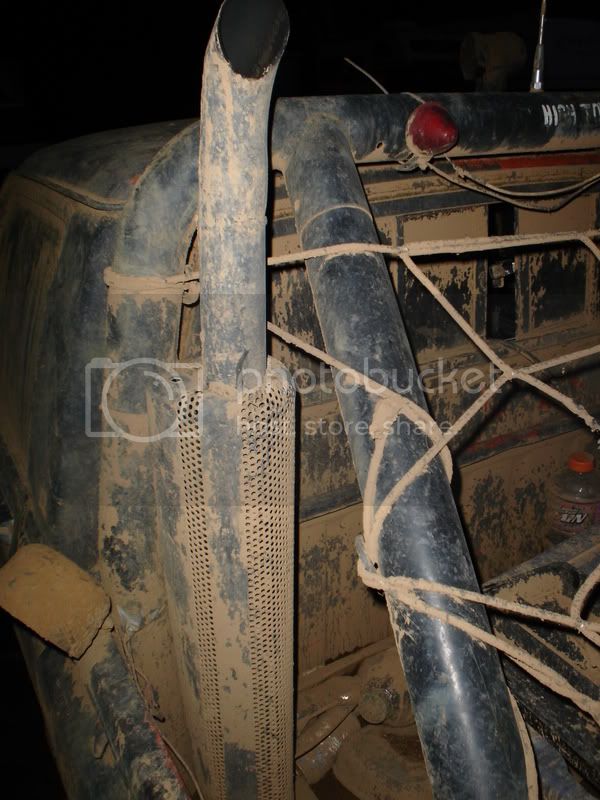

i used 2.125" pipe for the stack. bent it myself. used a ford truck heat shield.
the snorkel is made from 3" pipe i bent my self

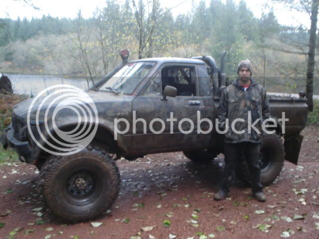

has a 22R bottom end with a 20R top end.
weber carb.
stage 2 cam.
the frame rails have been scientifically altered and injected with high density PNW mud.
the intereior was too nice when i got it. so i gutted it and sold it. ( didnt see fit to paint it crusty brown)
has 2 worn out blue seats.
35x12.5" TSL SSR's
linclon locked the rear :hillbilly:
and a 4 inch lift
with no power steering with drag link setup
rest is stock stock stock

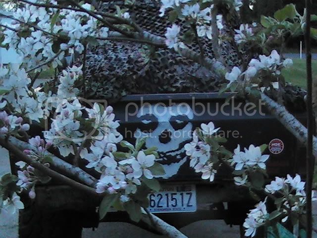

i painted it camo. made a stencil from dead leaves.
i used toilet sealer. the o ring wax thing you slap between the pipe on the floor and the toylet
and hell no i dont wash that truck. i let mother nature take its course in that department.

it held up good for a while. maybe 20 hours of driving.
then it seemed to break down and never really was solid again.
its not there any more.
i cut out a rubber mat. the kind you stand on if you have foot or ankle problems.
its almost like memory/space foam.
i cut it into the shape of the carb. that worked better, but eventually wore a hole in it.
so now i slapped a bunch of FIPK on the adapter and carb. let it dry, and now put it together. it seals real good now.
i took out the choke and filled the hole with the FIPK

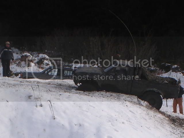

note the ty raps on the upper radiator hose.
i was out on the trail and the clamp decided to leave its home.
once it started steaming, i realized this.
so i filled it with what i had in my truck and what i had in my bladder.
then zipped the ty raps on there.
it has worked so good, they are still on there.

Thats freakin awsome. I love that truck. Really like the art on the tailgate. It just seems to fit.:beer:
Yeah, I meant to comment on the Misfits thing :D
thanks guys. :D i painted it that on there with a stencil i made out of heavy gauge cardboard.
i like the misfits alot, and i thot it was only right to put it on my favorite truck.
