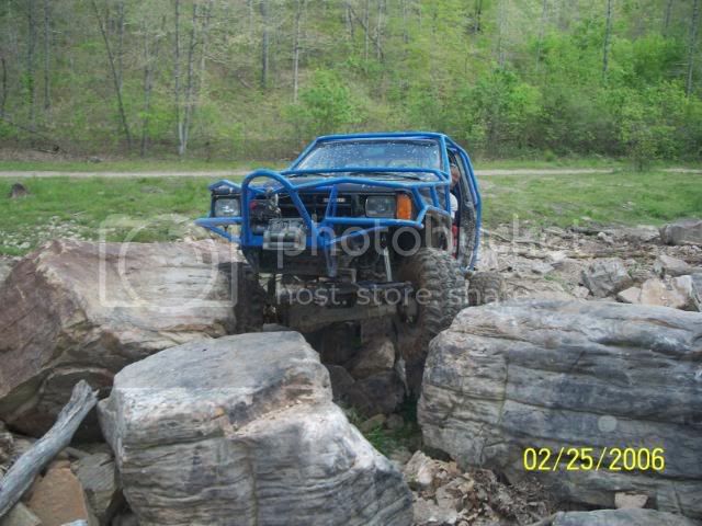

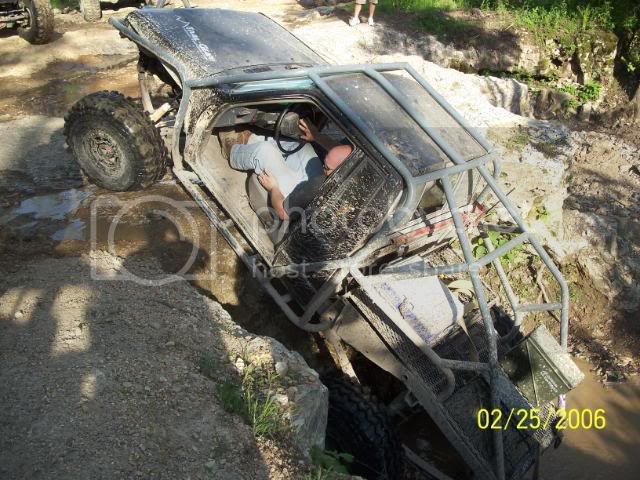

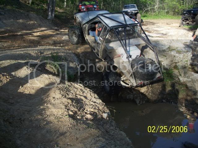

I just got back from FlatNasty last weekend. Here are a couple video clips, and a couple pics of me and my Arkansas buddies.

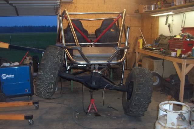

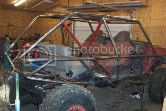

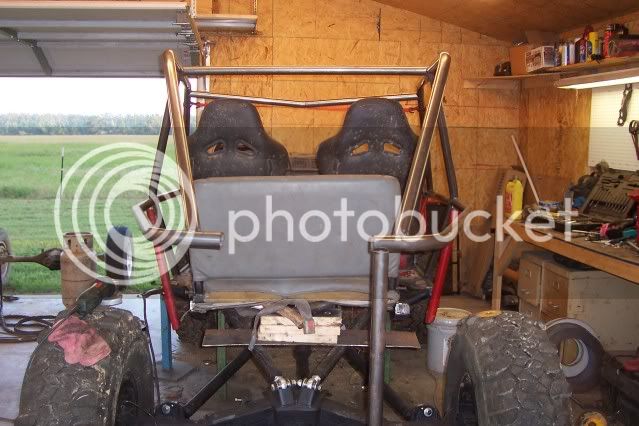

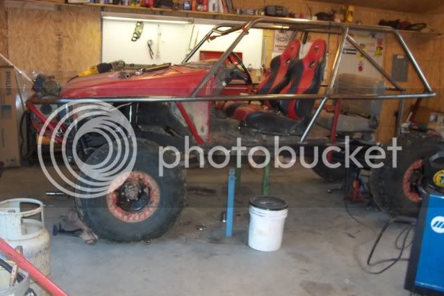

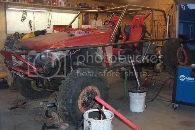

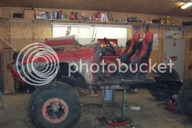

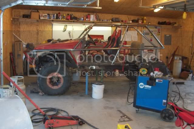

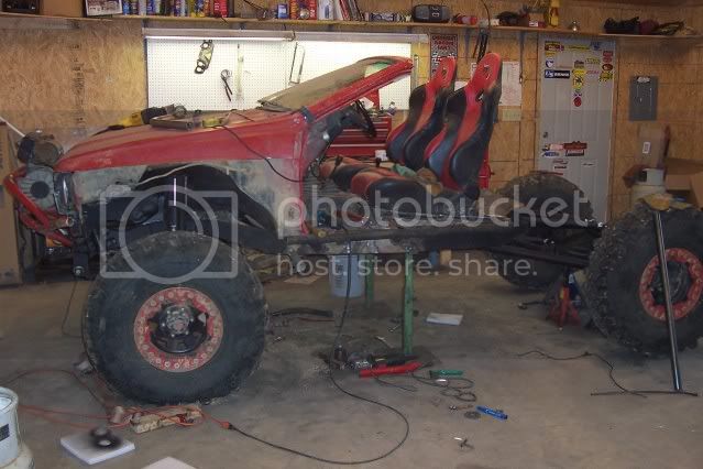

Hers a few pics of its current condition. Pretty soon I won't have a rig left, becouse I just can't stop cutting it away. There is some Bling in there as well. I really need to get this jigsaw pizzle together, Its not moving along fast enough. I'm ready to wheel it now.

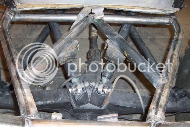

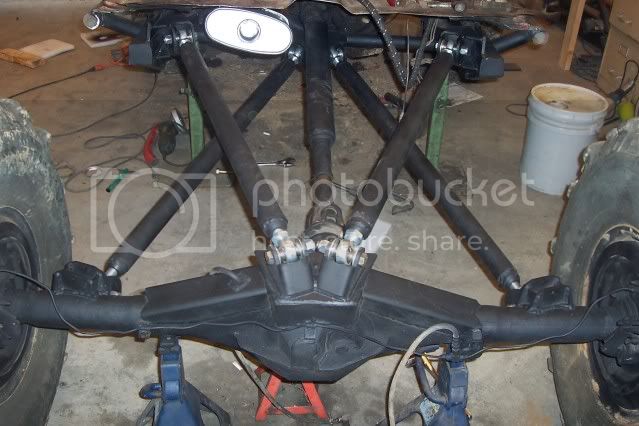

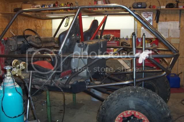

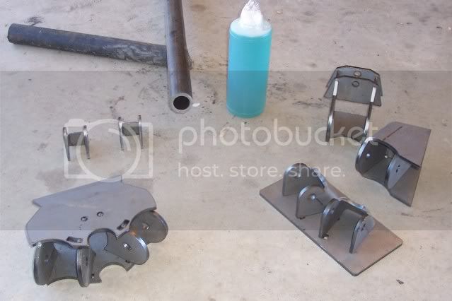

Well I bolted up the links after tryng to figure out exactly where I wanted my muffler.

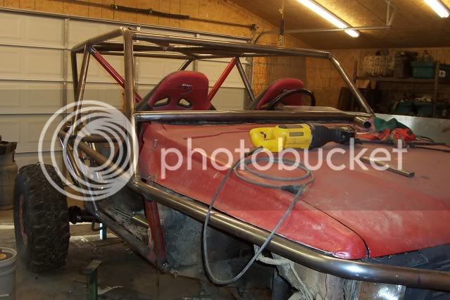

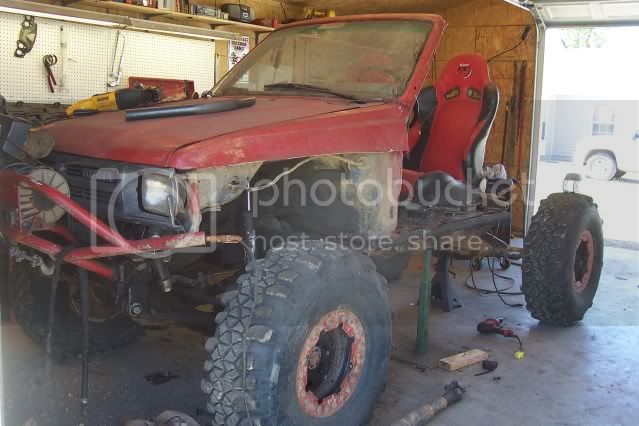

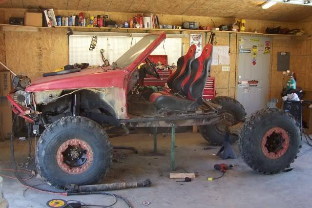

Then I starred at it for a while and decided to mod the windshield a little. Here is my version of a chopped top toyota.
Then I decided that a flip forward windshield may be more my style. Now I can give the jeepers that cool wave. :D

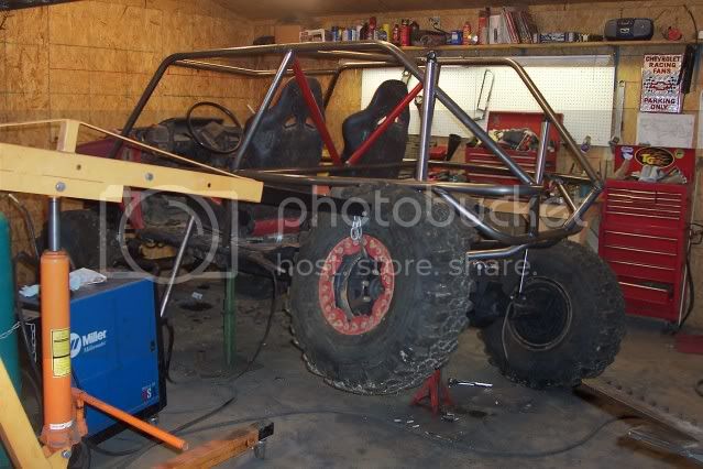

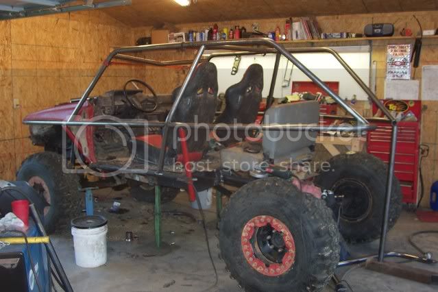

Ok here are some pics.
I like the overall shape this thing has. I like it from the rear as well. It wound up being quite a bit narrower that I had desired, but it works for me, and there is still enough room in the verry back for one of the large propane tanks.

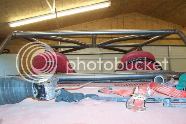

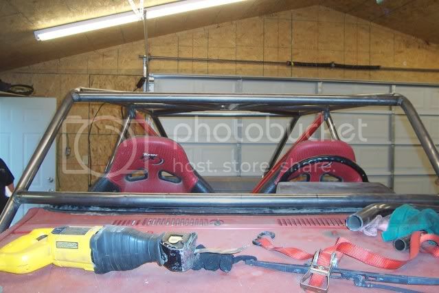

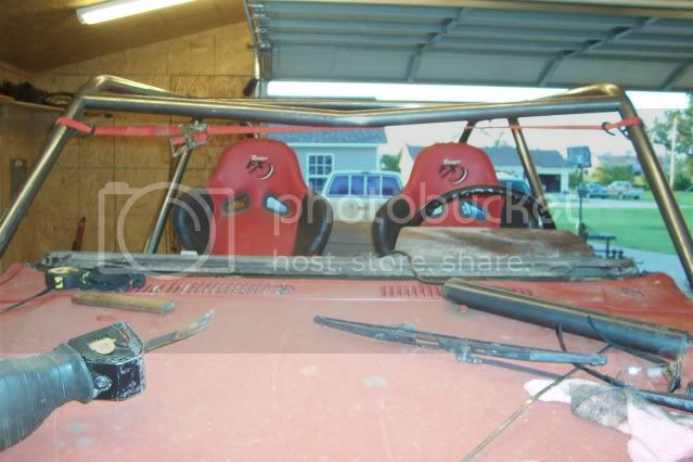

I ran out of gas for the welder (2nd time already this year) so I couldnt tack up the crossmembers I built. I used a bungee strap to squeese the center cross brace from poping out. I used a ratchet strap to get the upper a pilliar tie kinda sitting in place. I'm unshure of this particular pice. I always liked the single bend look that some buggys have but I'm really thinking it might hamper my vision when looking up through the windshield area. I may just have to play with the notches a little to rotate it up into the a pillar bends some.
