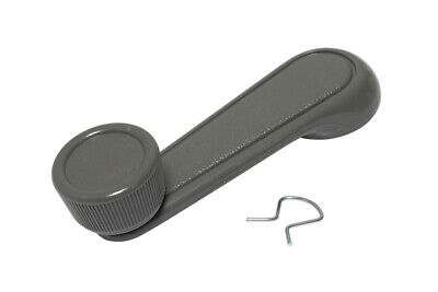

Looks like regulator, winder handle and a few minor bits are all you need.
Partsouq shows left side regulator as unavailable.
I'm guessing coz Aussie driver side regulator is the only ones that get worn out

There are cheap aftermarket options around.
$80 bucks?! Tell him he's dreamin.
