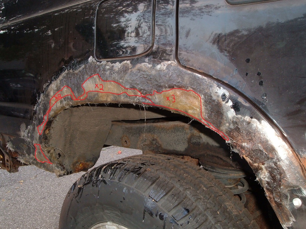

Getting it home and looking it over it needs alot. Canadian winter Ice snow and salt hurt it .. Lower control arms rusted holes both sides Rear panels above the wheel wells rotted rear side bumper behind again rotted

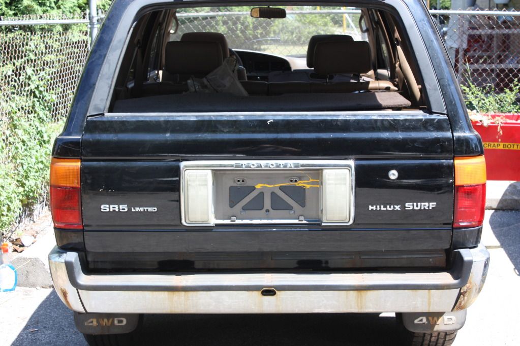

Tailgate rusted out at the bottom
Drivers side rear
duct tape is on there from 2 days before covered do to grinning metal and rain coming

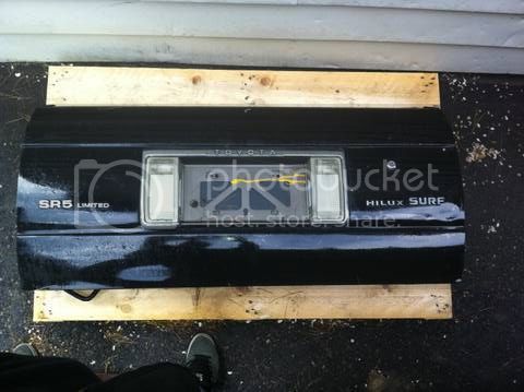

Found a used Tail gate on kijiji website $200 no rust same color 1 very small dent
So After Taking out most of the "guts" of the old door and changing the Lock on to the new gate and a mess! of wires Both been cut before and the 2 wire sensor that go's over the lock is now a 3 wire sensor ..everything works but putting the window up from the lock ..Have to use the switch inside the truck instead

The worse area was the rear wheel wheel areas started from the chrome trim were dirt sat and the mudflaps The tailgate i guess had the water holes at the bottom plugged with dirt too The rest of the rust is small bubbles at the doors and fender @trim Which come spring with be replaced with aftermarket I eneded up getting used A arms from a southern state for $50 plus $50 shipping which was better then the $350 each the dealer wanted

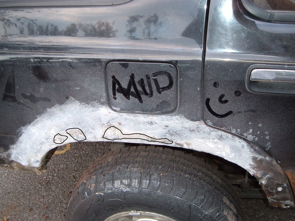

So today was nice out I grabbed a wire wheel for some finshing prep work cleaned off the metal and started the fiberglass work The holes i filled in a few layers of glass first then threw over a layer leaving a bit of a indent to be filled later with dynoglass (green filler and fiberglass mix This is before sanding
Not the best job to do outside with no gloves ( hands were stick as heck) ..done glass work many times ..in a shop Anyways I let it harden Grabbed a electric palm sander and 120 grit to knock down the high spots and get it flat leaving just the low spots and feather edging around the work
Tomorrow i might have time to finish the rest of that area and start on the other side with glass. I will post the finished

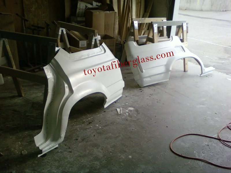

Yup seen them before Thanks! rather just fix the few holes with a few layers of matted glass then a whole 1/4 panel of glass and gelcoat Theres a auto scrap yard up the street that has all metal 1/4 cut outs But it's not that bad and i'm looking at what i got on the cheap
