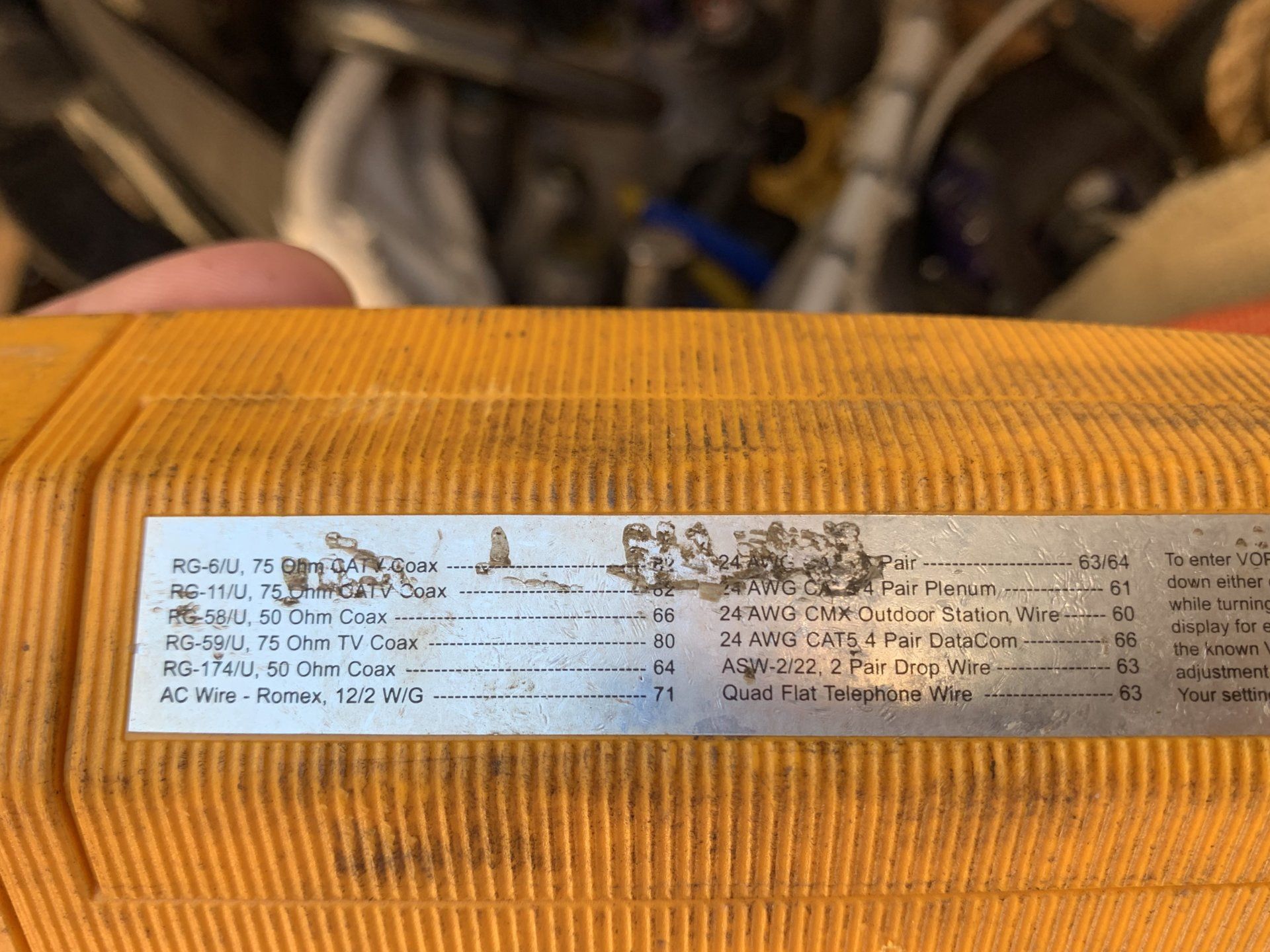

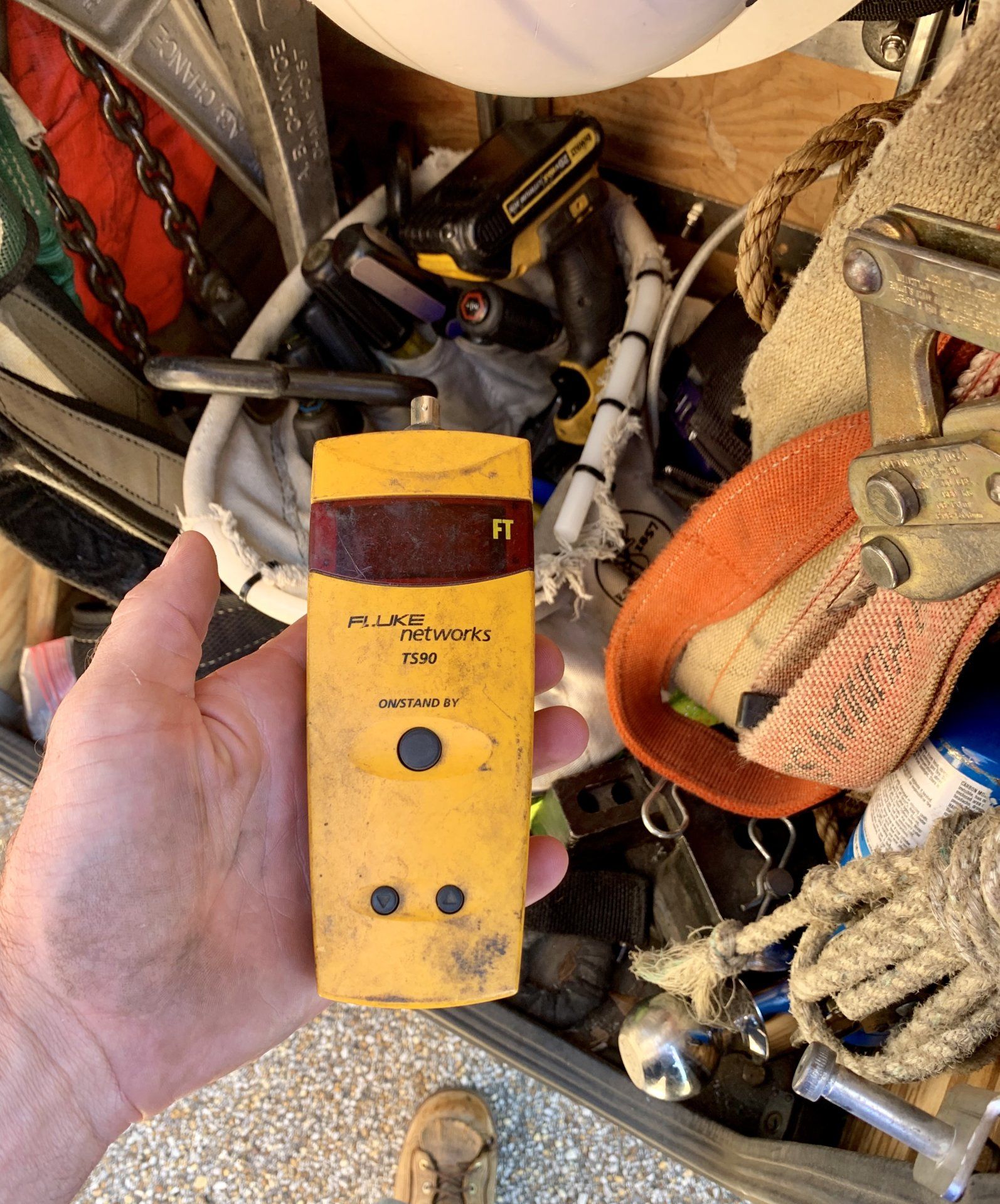

These cheapie TDRs work good to find footage to fault if that’s what you want to accomplish:
Thanks for the info and that tool looks like up my alley! Here's the info on my cable.
