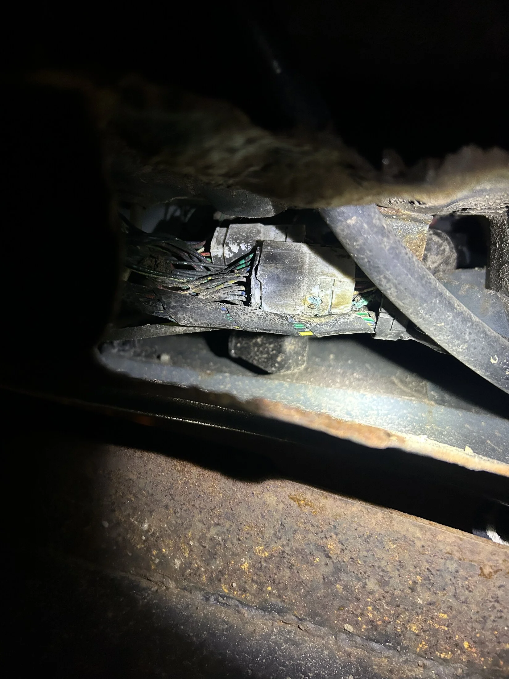

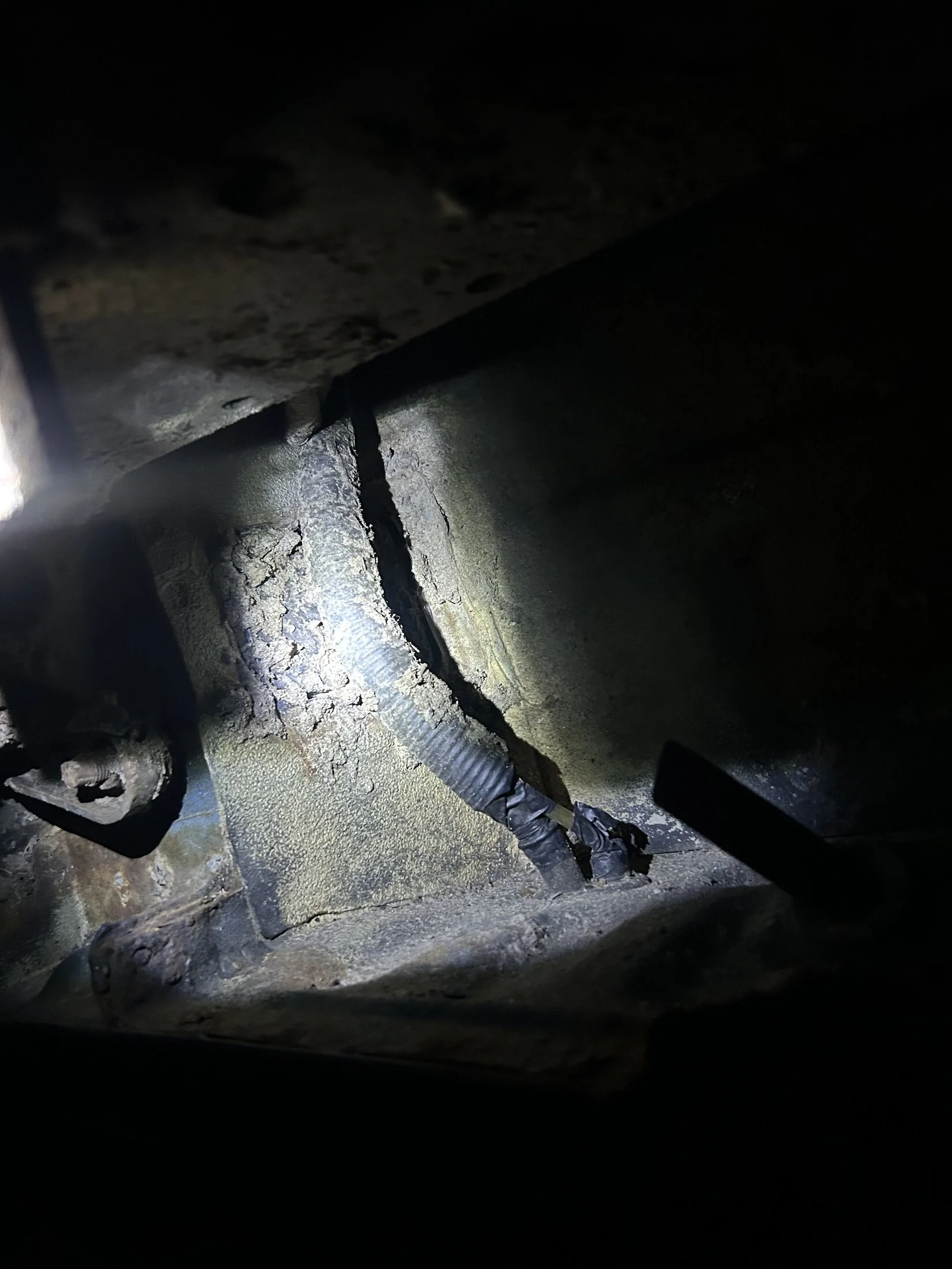

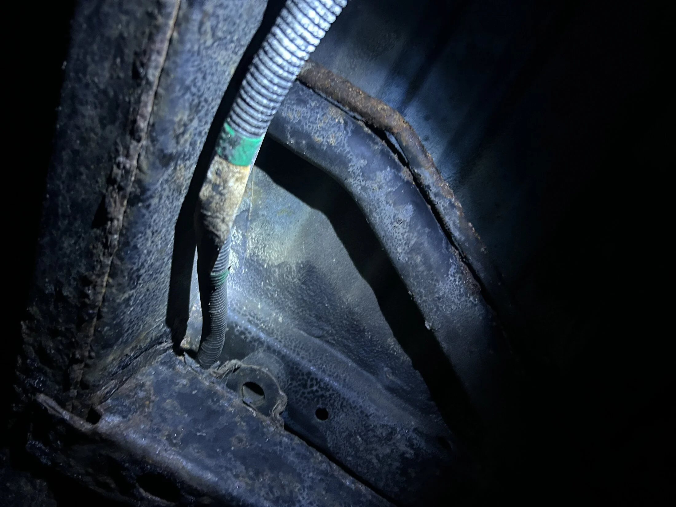

Requesting assistance in sourcing a wiring harness on my '94
Oct 10, 2024
39
93
PA
Attached are pictures of a corroded connector and wiring harness on my 94 LC. It is triple locked, US spec. I'm looking for a PID on where exactly this harness routes and whether or not it is available to purchase anywhere. I assume it's NLA from Toyota. It is corroded in a connector under the filler neck, in the left rear wheel well. Thanks in advance for your help.

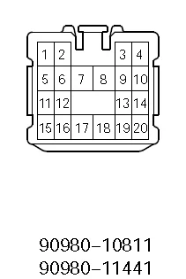

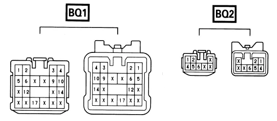

Those 2 connectors are called out in the EWD as BQ1 and BQ2. I'm assuming you're referring to the 20 pin connector BQ1. The female is 10810 and the male is 10811. The EWD does not have a picture of the male side with the corresponding part number.
If you download what @OGBeno suggested, along with the FSM and EWD for your truck, you can search part numbers and associated pins for each connector.

Thank you very much, I'll do this! Sorry, by "PID" I meant "positive identification".

I happen to be a dealer technician, just not for Toyota lol. I'm a BMW dealer tech. I was going to replace the entire harness but I'm sure it'll be easier to just cut out the corrosion and repair it. It's kind of in a pain in the ass spot but I'll get it done here soon. Just need to order the new connectors from Toyo and splice them in. I didn't realize the fzj80 FSM was available in the resources so I just downloaded that and I'll probably tackle that next weekend. Thanks for your help and insight.
