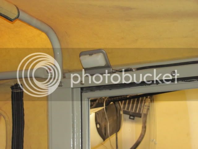

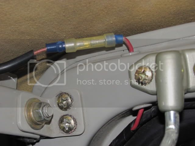

I really never discovered exactly where the Room light was located on the 66 FST the OEM heater switch covers the room light location and since the PO had used the light switch wire red with black stripe to wire the aftermarket cigarette lighter....So I just wired It to the battery side of the ignition switch ran it up through the windshield frame thru the insulated hole and drilled and mounted the hard top dome light into the top door bow.

John I had to add the red wire to the windshield wiring loom so It was never was there, I saw a later style bows with the later style dome light on the "B" pillar thats is what gave me the Idea :idea:
SOR list the early dome lights 1958-9/73 the hard top I have of the about same vintage 66-71 as my 40 had the dome light .
