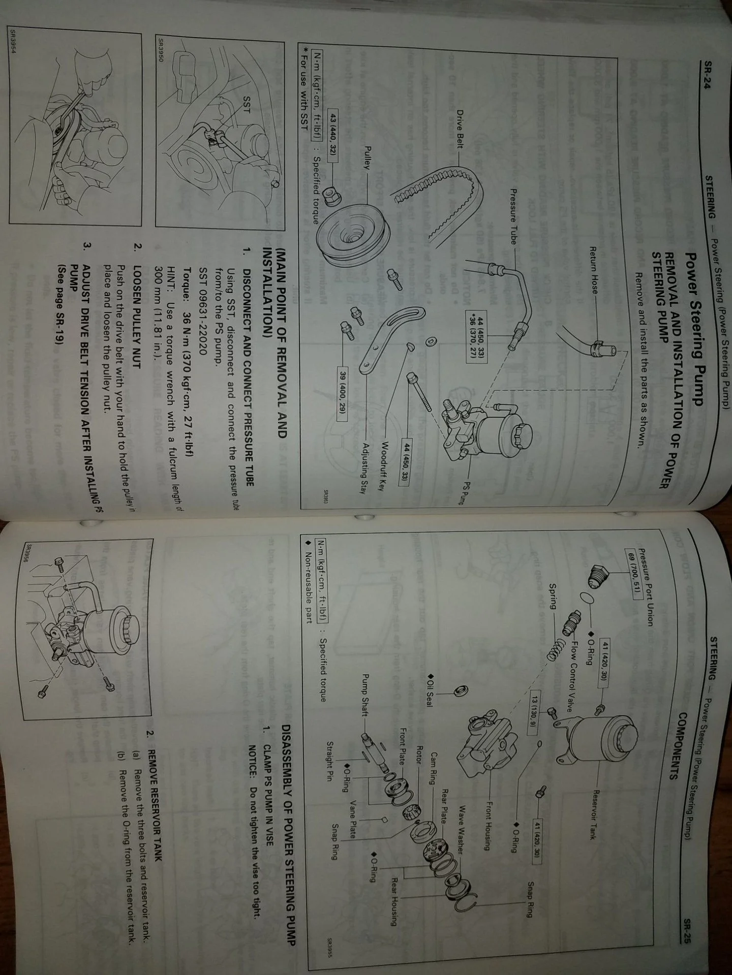

Thank you...I appreciate it.Mordka, I can take a pic of the FSM later today when I get home from work and post it here, but it should be fairly straightforward.
