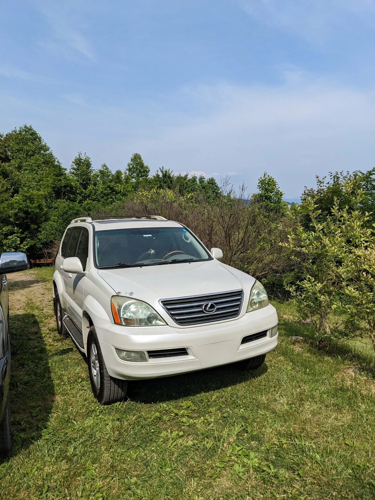

Hello all! I'm the excited (first time) owner of a new old 2007 GX470. I've never owned a 4x4 before and would describe myself as "mechanically interested" but a complete n00b. I enjoy reading up and learning, but I can't do much work myself and certainly don't know all the considerations that go into making parts/configuration choices.
I purchased this 470 knowing the rear differential was almost certainly shot. I was able to confirm it with a local mechanic yesterday.
