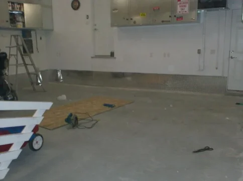

I got off my rear yesterday and attached the tread plate to the garage walls.
You likely can't see from this photo but there are lumps and bumps caused by the forms when the foundation walls were poured and to make the baseboards hang evenly I wanted to knock them off.
So I used a chisel and hammer - no problem
And as discussed above a dollop of spare adhesive that was lying around. This is just to stop it from making that tinny sound when hit, the screws will hold them in place. I put three on each panel.
I used some 1 1/4" wood screws to secure the panels to the wood in the top of the foundation walls. Three per panel. The aluminum is soft enough that a wood screw goes right through.
This pic likely looks the same as before - but now the panels are attached to the walls.

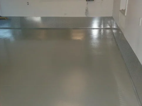

Paint
Moved everything outside yesterday to paint the floor.
Did a good sweep and go dust on the camera lens apparently.
Got all the supplies ready. The paint has been sitting for about three years since we painted the floor at work so the solvents had separated and floated to the top. I didn't have a stirring thingy for the drill and so got a workout - man that stuff at the bottom was thick! I masked off the baseboards with some 2" tape and added the "part B" to the "part A". Once the two parts are mixed you are committed. If you don't spread it you'll end up with a solid bucket of paint. By the time I was done I could tell it was getting thicker. I didn't use all the paint - in fact only a little more than half. I started with 11 gallons and have 5 left after two coats. The fresh concrete absorbed some of the first coat and required another.
The label on the cans said a few interesting things. "NOT for residential use" and also no mention of concrete as an application. This is the stuff our paint rep gave us and it has held up great at the shop so I'm not worried about the concrete application. As far as residential use goes, I suspect it is mostly about the fumes as the are quite potent. I used a mask with VOC filter and could not smell it. But it did drive the wife and kids out of the house despite locking the garage to house door before starting and opening the man door and window in the garage for air flow. I would have opened the overhead door but for the outside temperature being below the recommended minimum for the paint. As it was I had to crank up the heat to maintain a good temp. The temp and the age of the paint/ lack of proper mixing led to a slow cure. The label indicated dry to touch at 4 hours but after 11 hours it was still sticking to my fingers. So I covered the Harley and cranked up the heat to leave it overnight.
This morning it was still a bit tacky in places but dry enough to walk on. I'll leave it all day and move the bike and stairs in tonight. This is about as clean as this floor will ever be.
