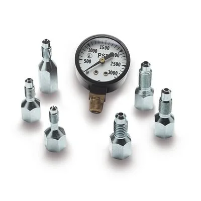

I decided I would adjust the LSPV before replacing the brake lines. In researching a solution to setting the rear brake pressure, I came upon a neat brake pressure gauge with a set of adapters from Summit Racing. It is part number SSB-A1704 for $45.95. I removed the bleeder from the RR caliper and installed the proper adapter and gauge. A friend applied the brakes (engine running) and I found that I only had 300 psi at the rear. After adjusting the LSPV, I had 800 psi at the rear and 1500 psi at the front. Close enough! IMHO, this the the only way to really know what that LSP valve is doing to your brakes.

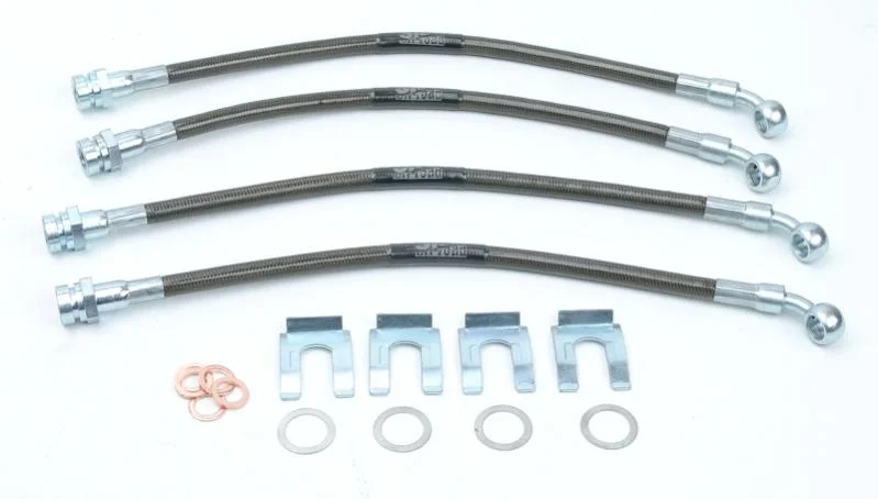

My first error was in ordering a set of braided lines from a firm in Californina that shall remain nameless. After removing the RR line and attemtping to install the new one, it became obvious that the end of the brake line that drops into the tab on the axle would not seat. The hex on the line was too large. I called the tech service number of the company and they informed me the "Oh yea, sometimes you have to grind out the openings to get them to fit". I returned the lines and discovered Christo sells brake lines. Should have looked there first.
In a couple of days I had my new lines from Christo. They are top quality and fit perfectly.
