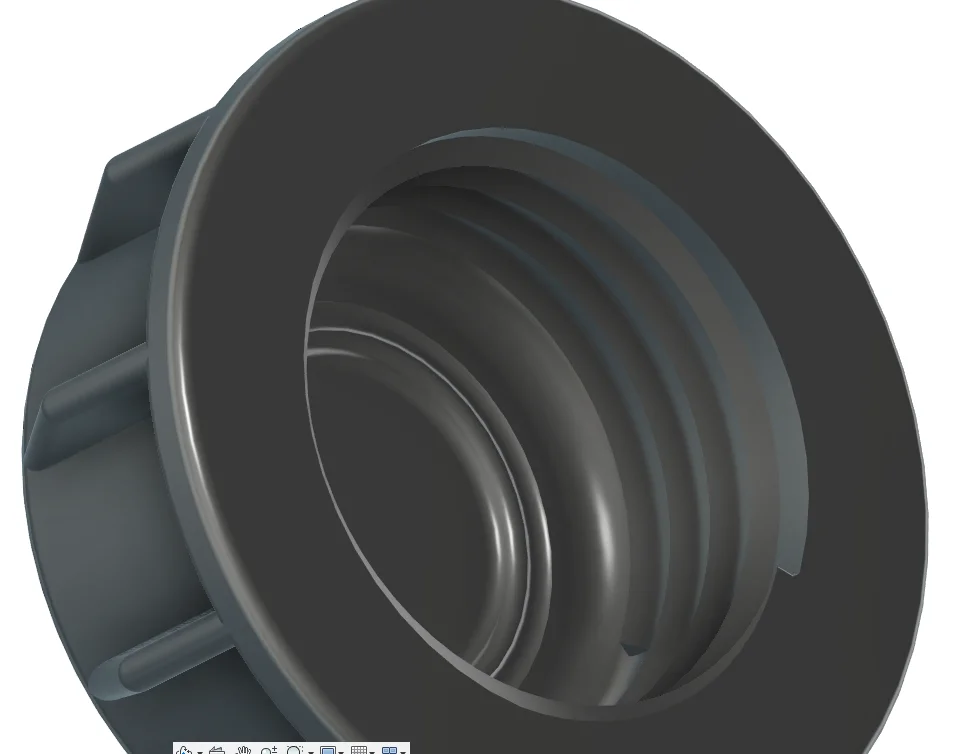

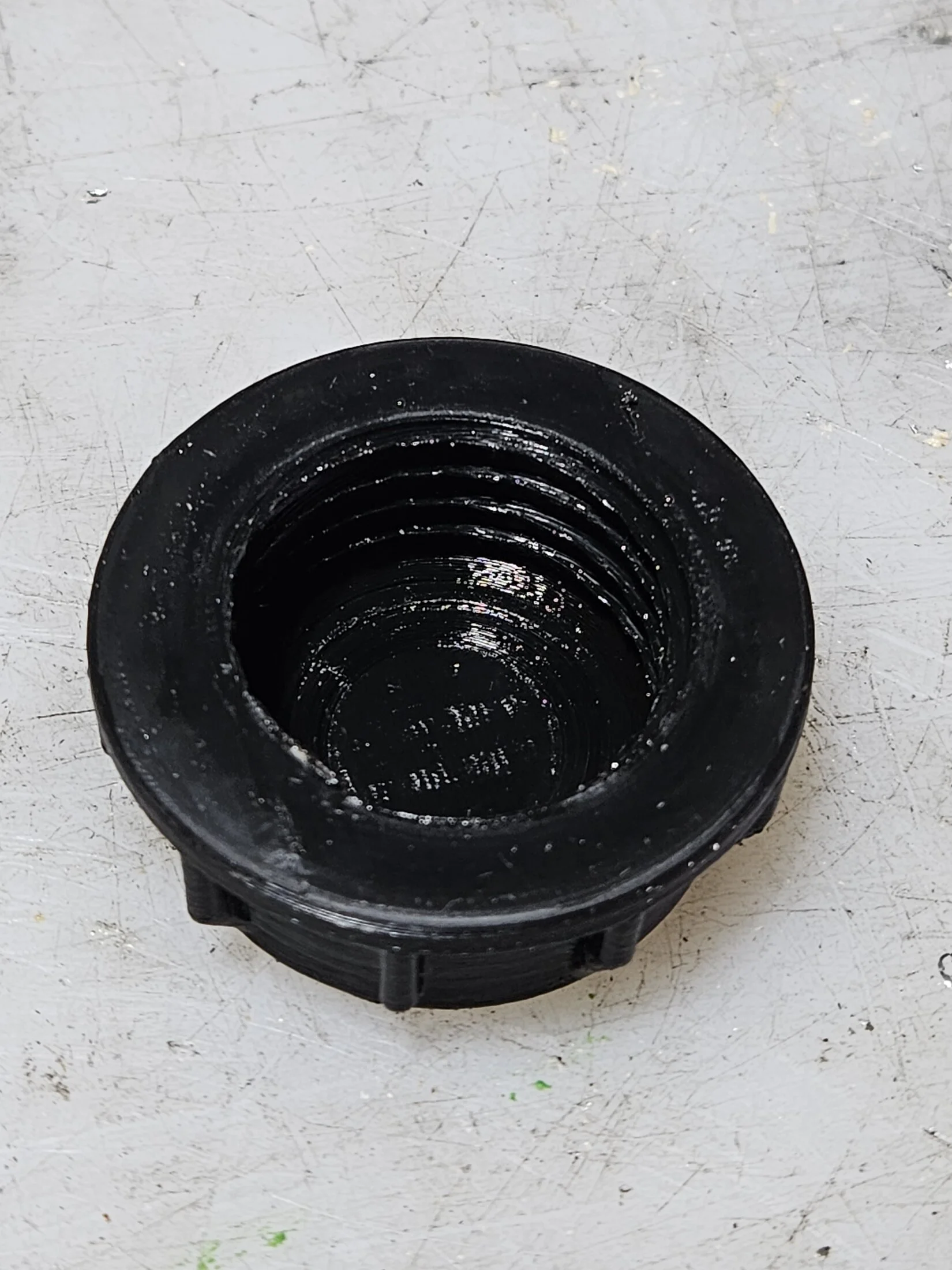

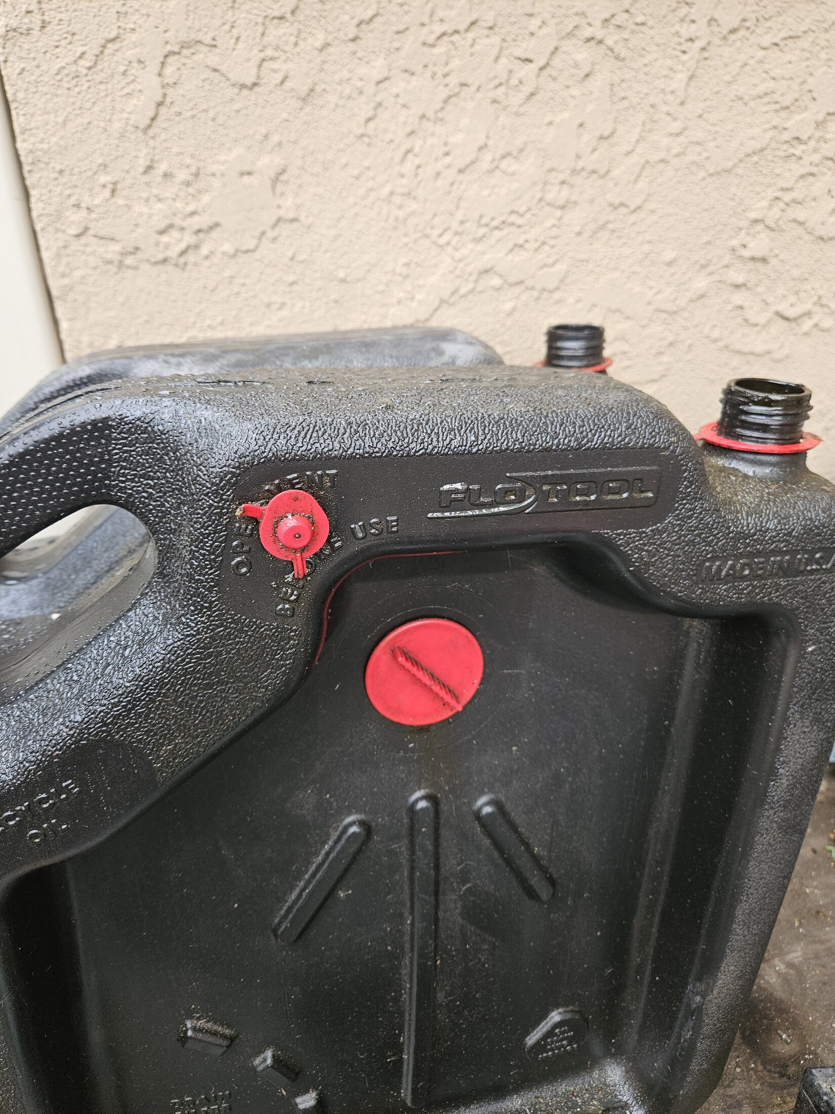

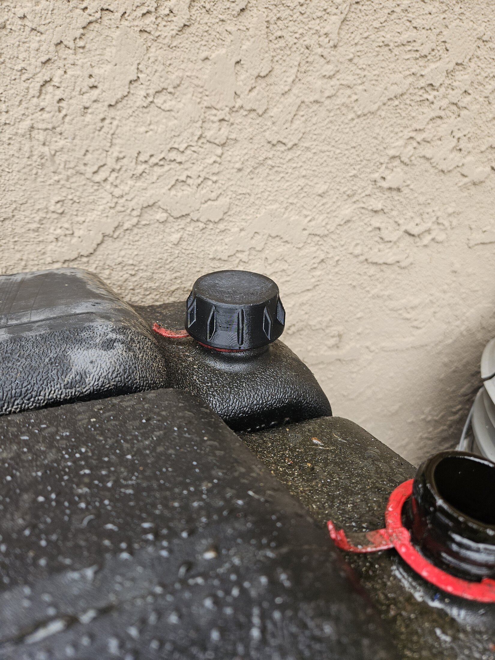

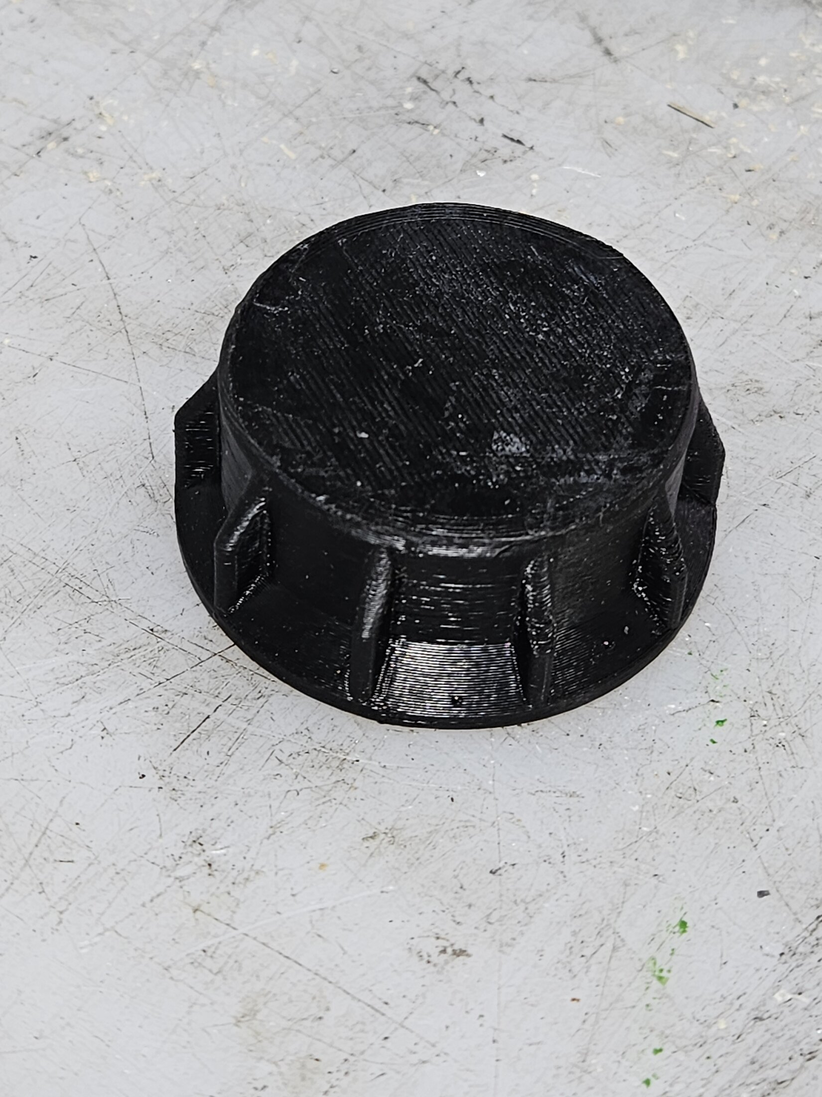

I have these 2 Flotool oil containers. Actually, like many of us, I have had many of these over the years. Each one has suffered a cap failure. I would typically try work with it, use hose clamps to get a better seal, suffer through the drips,, etc... but would eventually capitulate and buy an entire new container because Flotool doesn't make replacement caps. I head there would some other brands but never ordered any to confirm and they cost almost as much as a new container. I decided no more, enough is enough, I am going to solve this once and for all. I designed and 3D printed a new cap. I just installed what is probably my 10th revision and I like it. It grabs a lot of threads allowing you to really tighten it. I turned the can upside down with an 80 series worth of oil in it and the cap did not leak. I am going to print up a second one.
I got to thinking, maybe others could use this? Flotool containers are usually around $15 with sales tax, Walmart sells the generic version for around $12 out the door. I figured I could sell these for say $3 it could help us keep our oil drain pans longer.
If anyone is interested, I can print up more and bring them to the next meeting. Let me know.

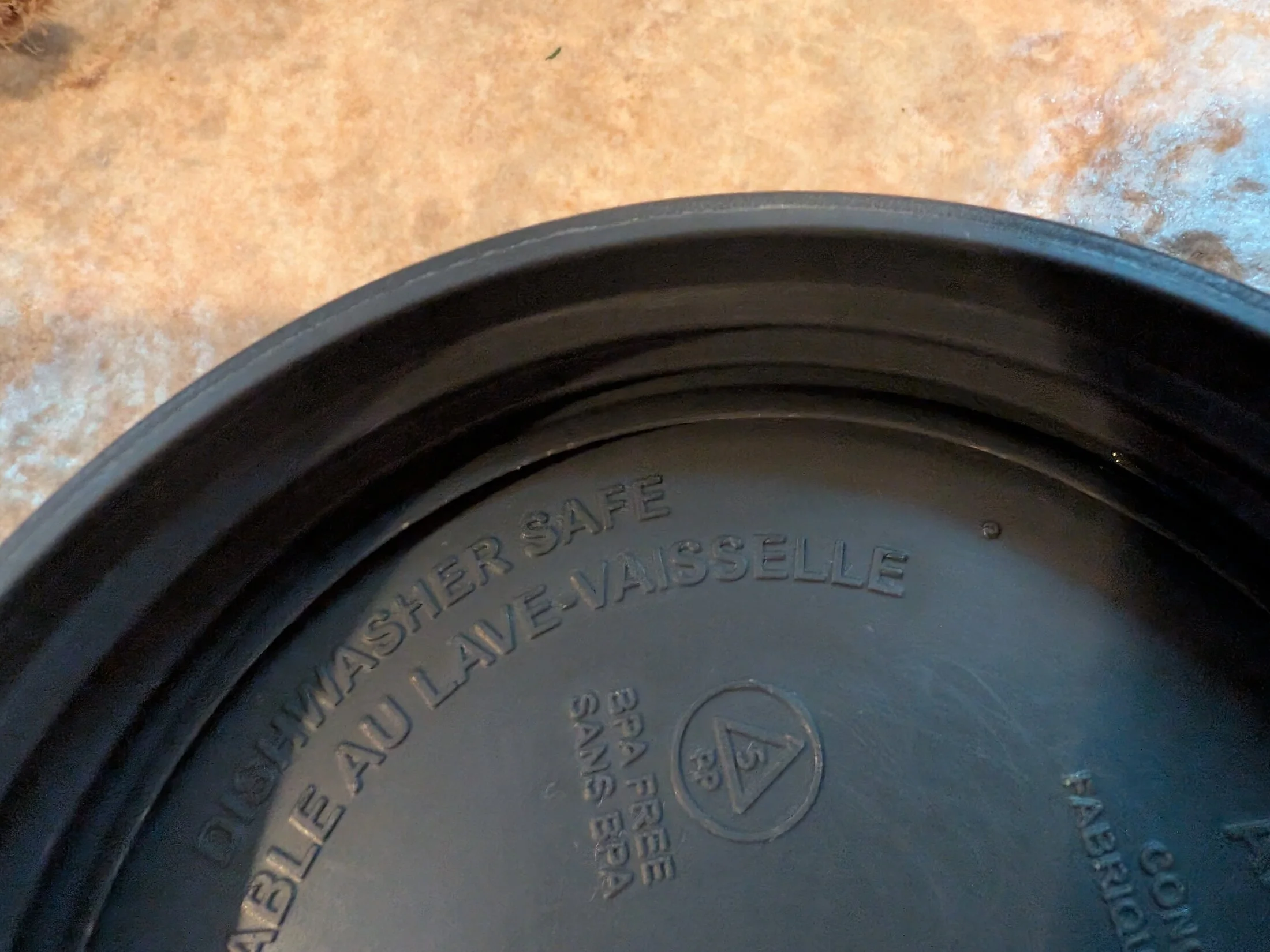

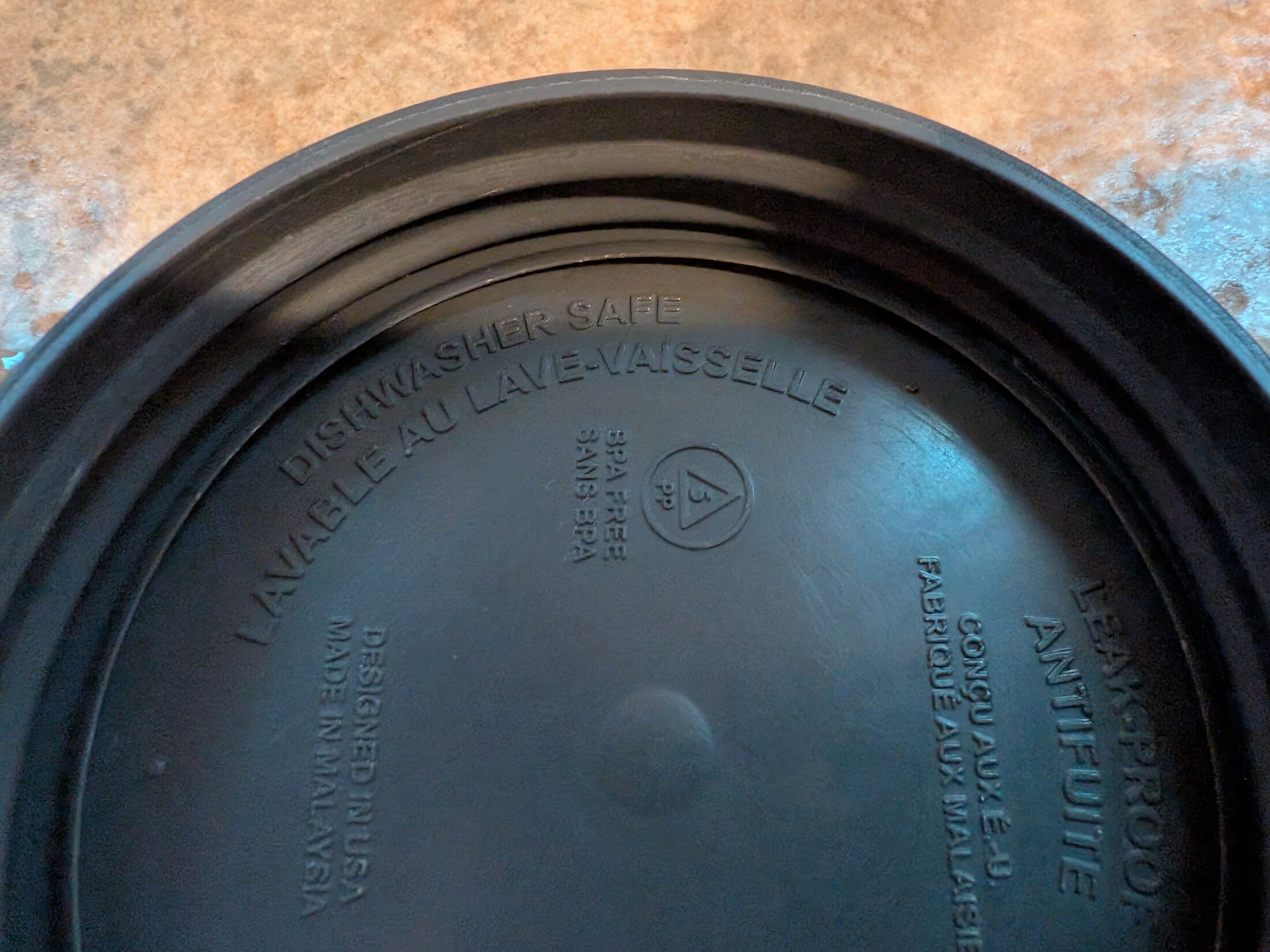

Nice! Does your version have an angled sealing surface? I use caps for Mason jars and noticed that the plastic caps have an angled sealing surface that really creates a great seal with minimal thread grab. It looks like this would use the flexibility of the material to create an integrated gasket that would allow for some flex and such and not lose seal.

I tried to emulate these two ridges in the original cap. Actually I made them larger and more pointed. So far so good.
In my experience, it's the ability to sufficiently tighten that makes a good seal. I think that's part of why the original caps fail. You tighten them to try to stop the dripping but the plastic is so thin it tears.

Maybe printing with a polyurethane filament? My printer won't play with the stuff so I haven't tried that material myself, but my friend in Valley Center says it's fantastic.
I have never tried printing polyurethane either. These are out of ABS.

Would you be willing to upload/share the files so other can print it themselves? It's really awesome that you made a replacement cap and I'd rather fix what I have then put it in a landfill.
Otherwise, I'd be interested in buying a few from you.
Not sure what size I need for mine but this is so cool
Here's the .stl file.
