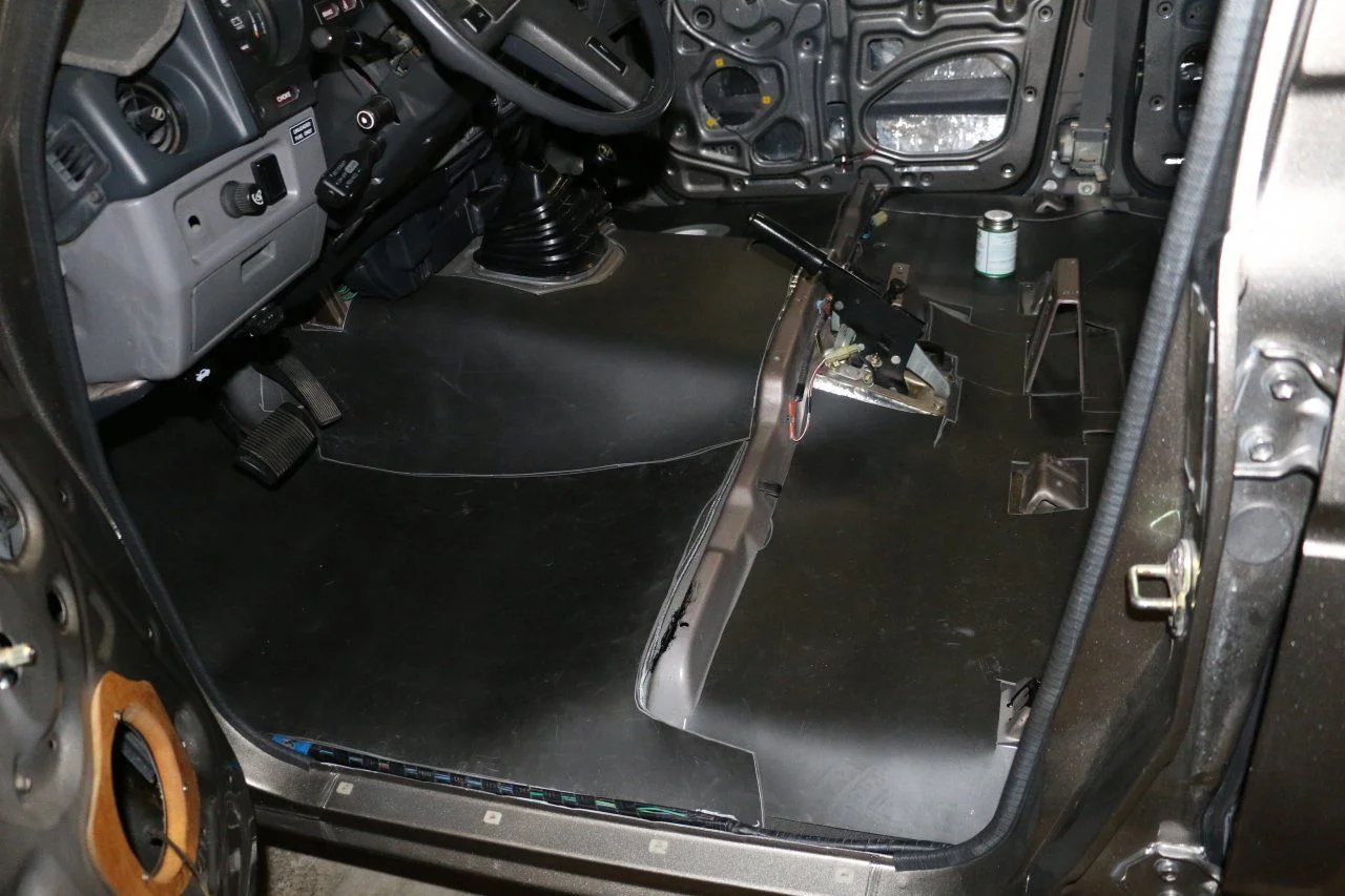

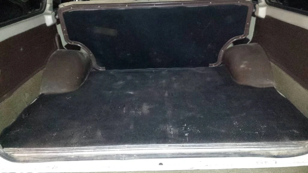

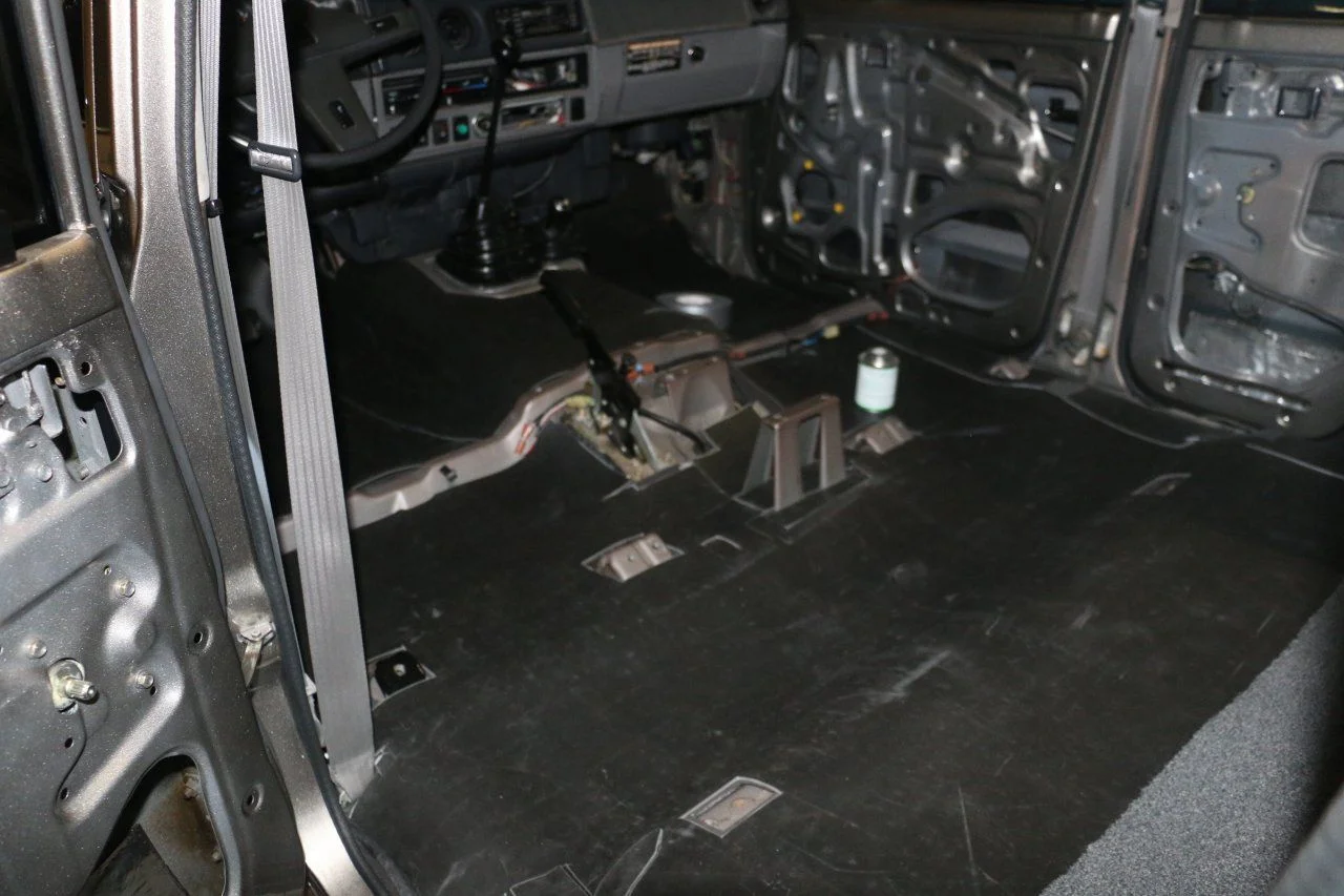

I'll get some shots this weekend...I just got around starting it...have the cargo area done....middle shouldn't be tough...the front still has me nervous. The closed cell foam / MLV part of the process has gone well.

1/8" mlv is the ideal thickness for the car....and you would never want to go thicker...stuff is HEAVY....1lb per square foot. For the most part its been pretty easy to work with, just have to take you time cutting to get it to lay down (stuff won't do compound curves. the rear carpet laid nicely in the back area...its 40oz so the weight and the rubber backing have seem to make it pretty easy to get it to conform...once I get the passenger sections complete I'll post some more shots.
couple of shots of the CCF and MLV. Hadn't finished trimming the front section...laid down even better, really conformed nicely.

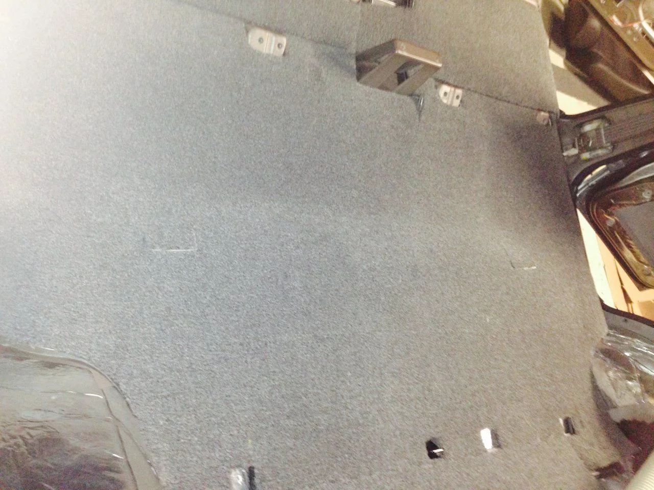

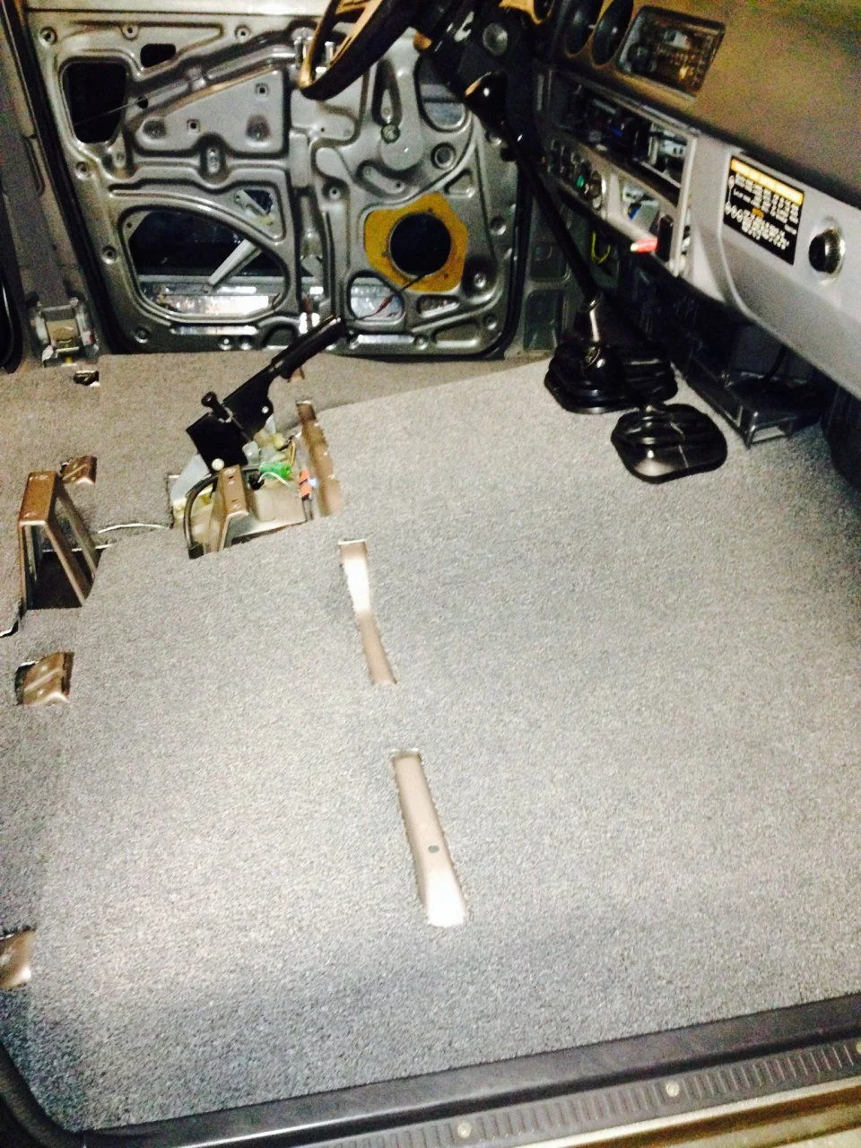

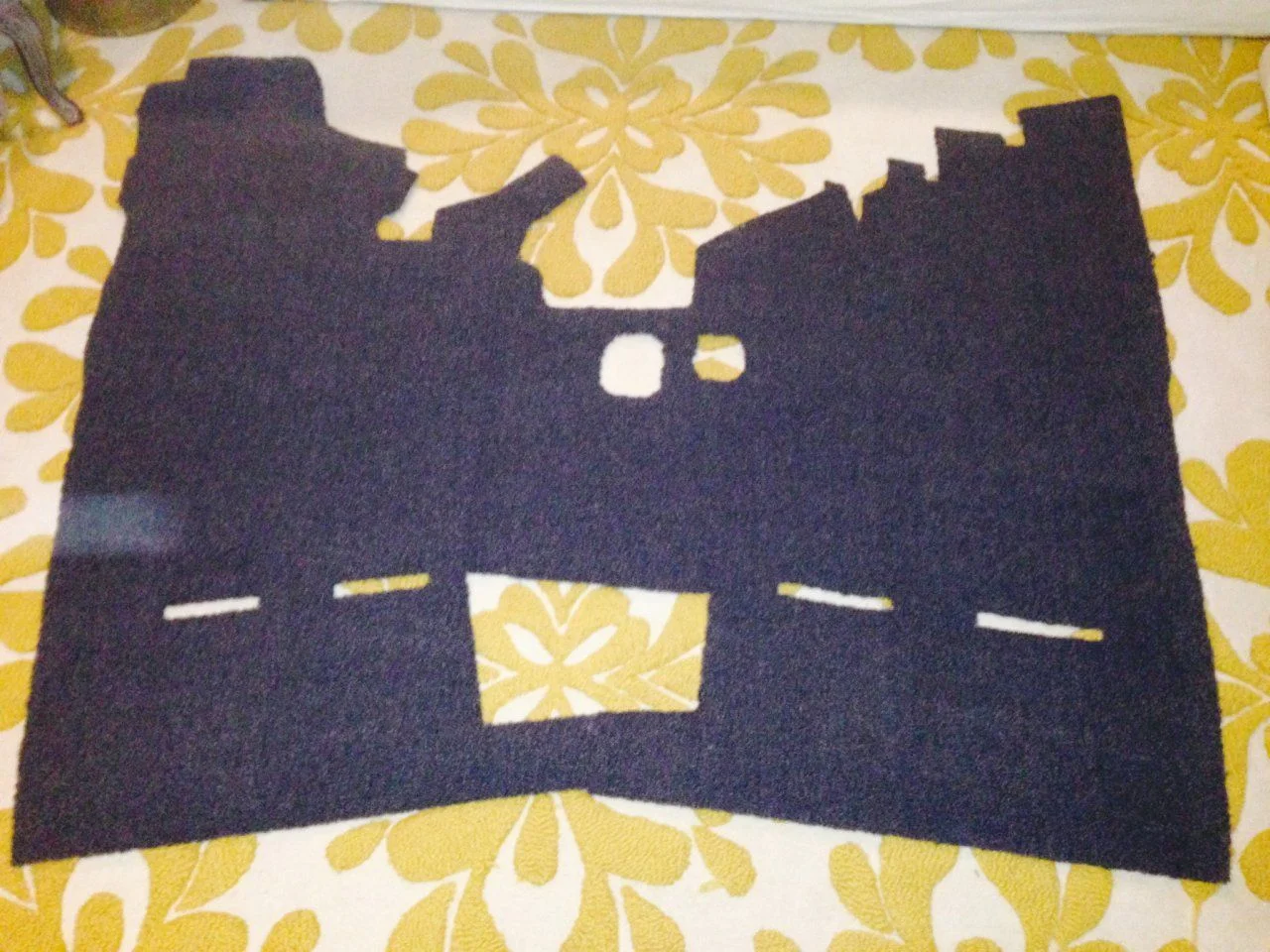

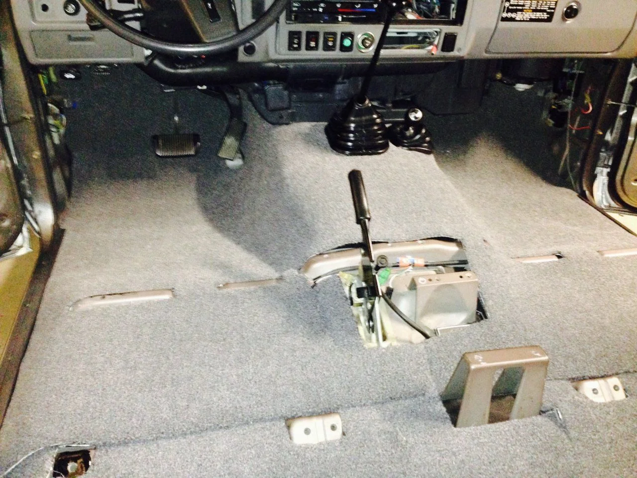

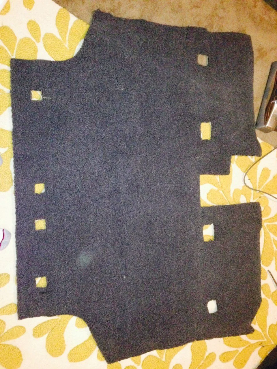

Marine grade 40oz with a rubber backing. http://www.marinecarpeting.com/boat...et-w-nuwave-backing-12-x-various-lengths.html Front and middle sections were pretty straight forward...the front took a while to make a template with butcher paper, transferred to the carpet...remeasure, cut, test-fit, cut, test fit, cut. Really happy with how it came out....the front is contoured even better now that its had a day to sit in there an "relax" a little. I was concerned it would come out looking cheap, but I have to admit, finished product is better than I had hoped...carpet itself is really high grade stuff...love it.
The installed pictures are much lighter in color vs the actual (closer to the color laying on the floor). So glad this one is done.
