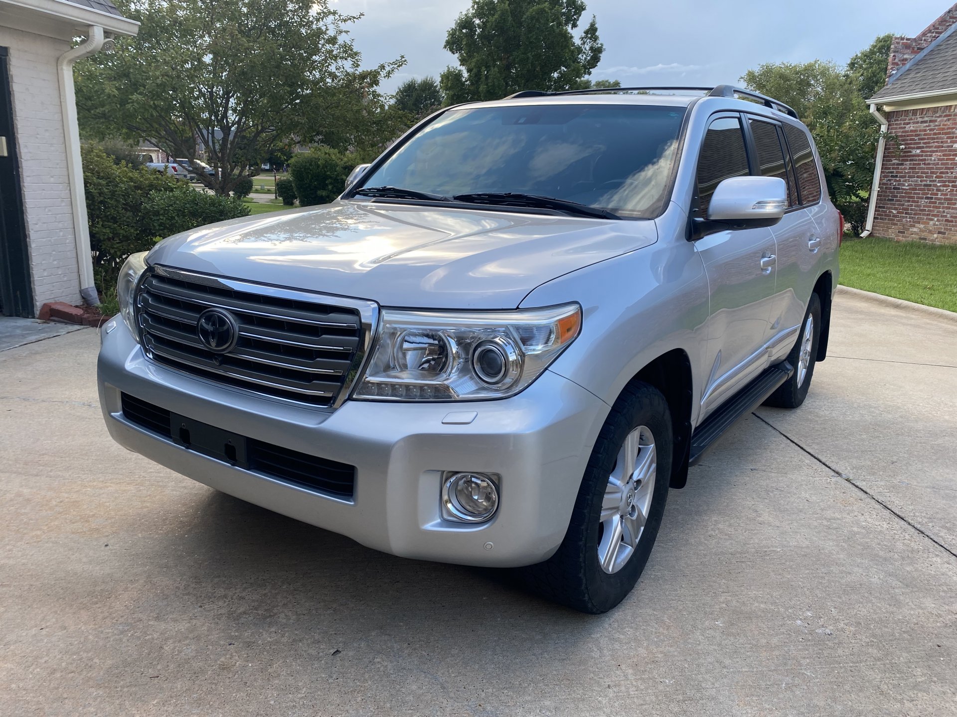

I’ve got a 2013 LC with 211k on the clock. It runs great. But, it’s really bouncy so I need to replace the shocks all around.
I drive 100% on the road so I’m looking for comfort. If anything, I prefer something that drives stiff rather than bouncy.
Should I replace with OEM or aftermarket? Any suggestions??
