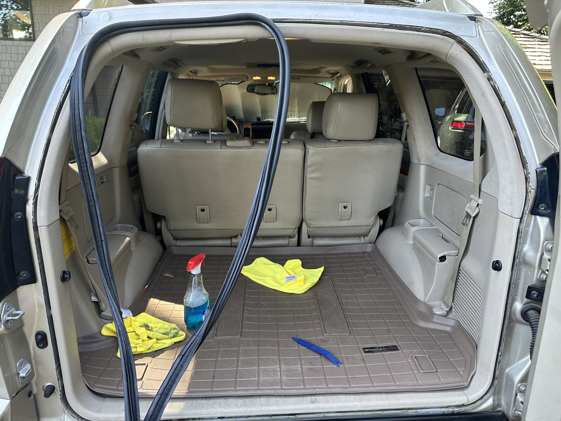

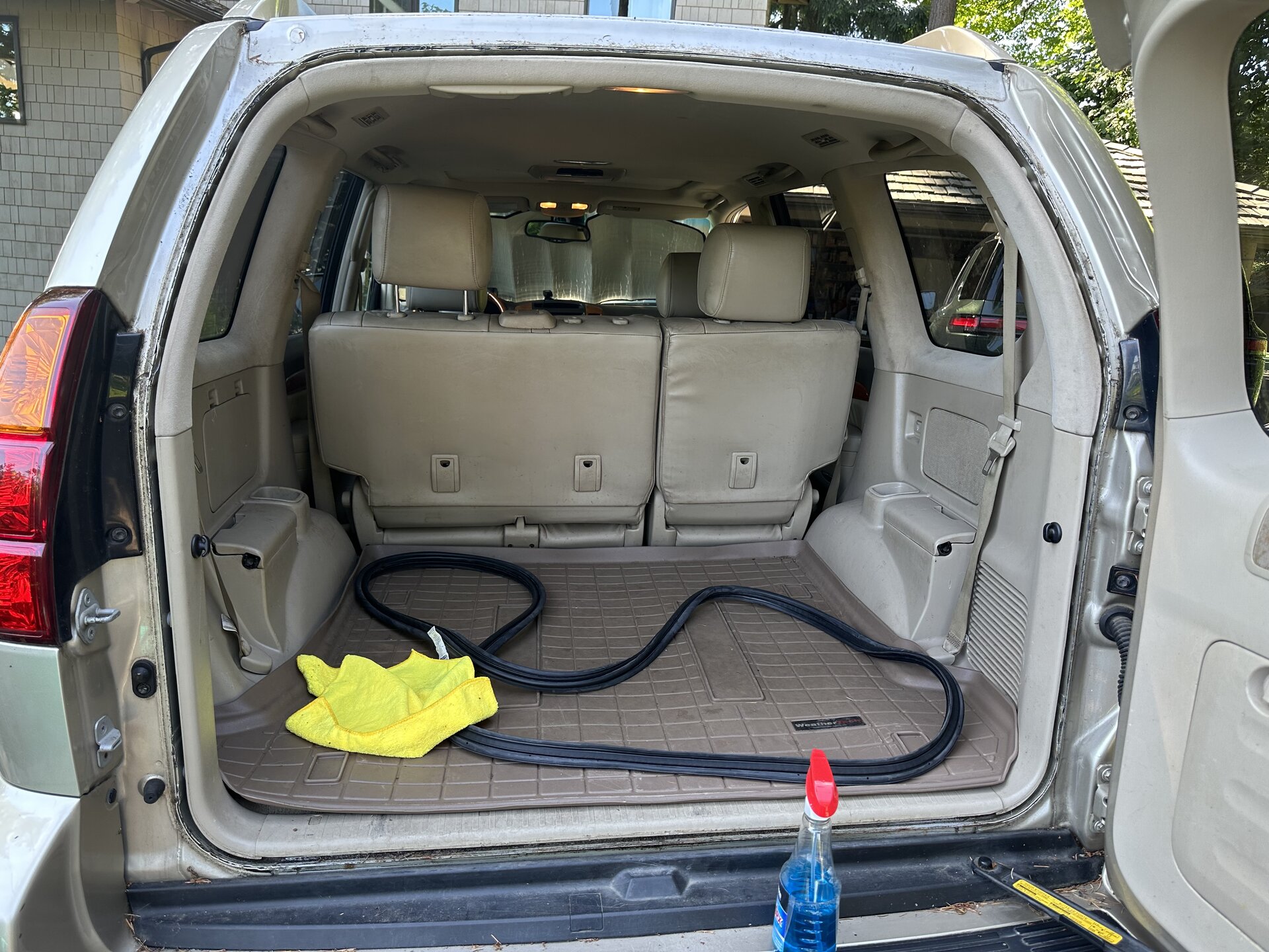

I tried tugging it out at the bottom and it _seems_ like it should come out all around - I just ordered the weatherstrip on eBay and will report back.
I did it - probably 20 minutes end to end and 1/2 of that was cleaning up the debris behind the trim. Entire piece pulled off very easy - there was some adhesive goo on the top edge where two pieces of metal were sandwiched together to make the seam. There might be more of that - I did get hit on the passenger rear quarter years ago and there was some body work so the shop might have pulled it off previously.

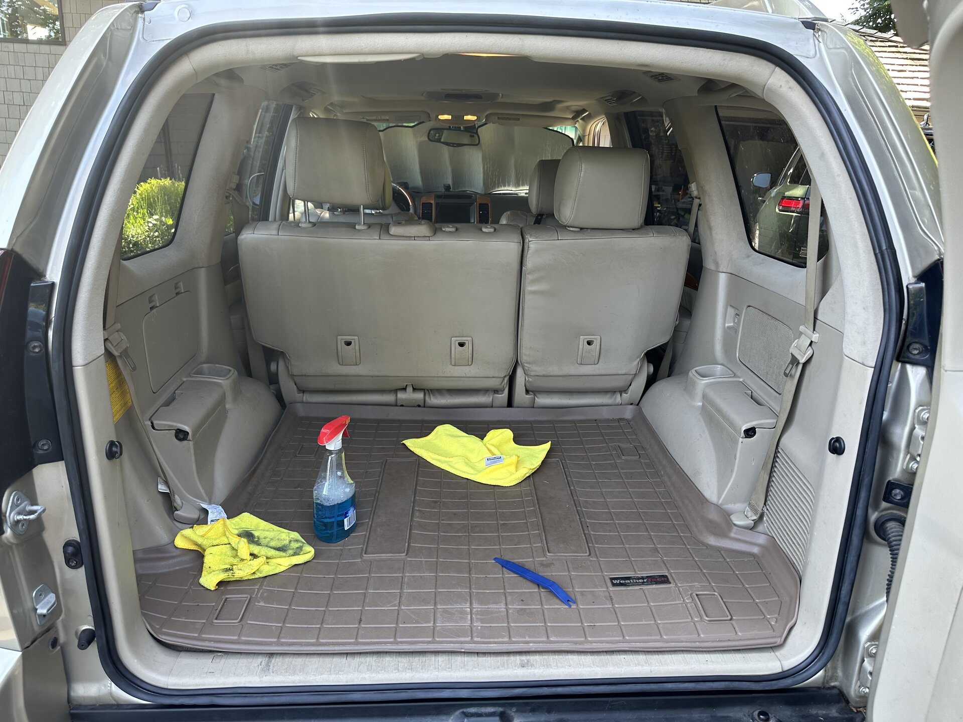

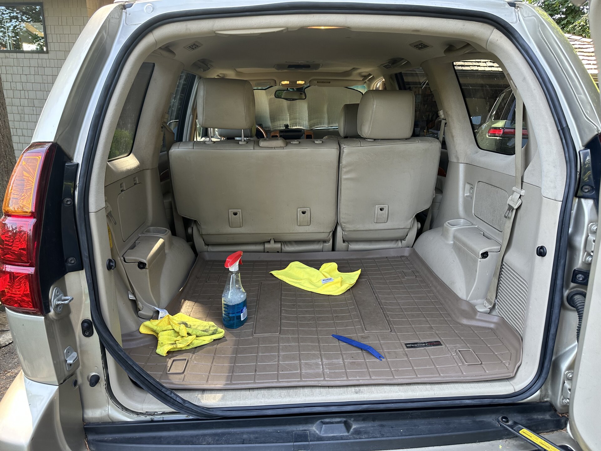

Pushing straight on, worked my way around...and I came up a bit short. Pulled off and - pulling moderately from the end as I pushed on a second time - it worked out well.
Proof in the pudding - door closed nicely and there's now a feeling of a nice cushioned seal being made.
