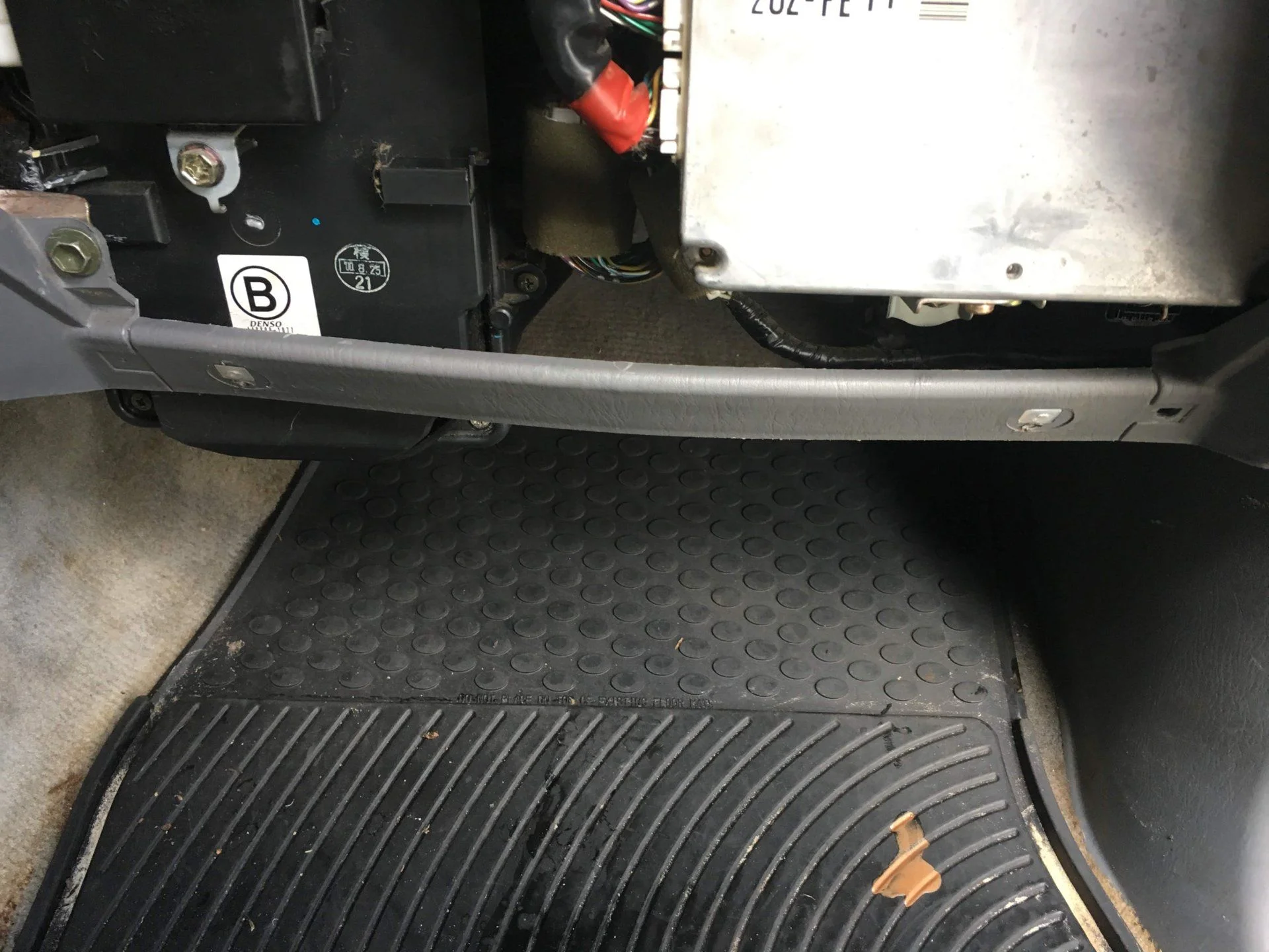

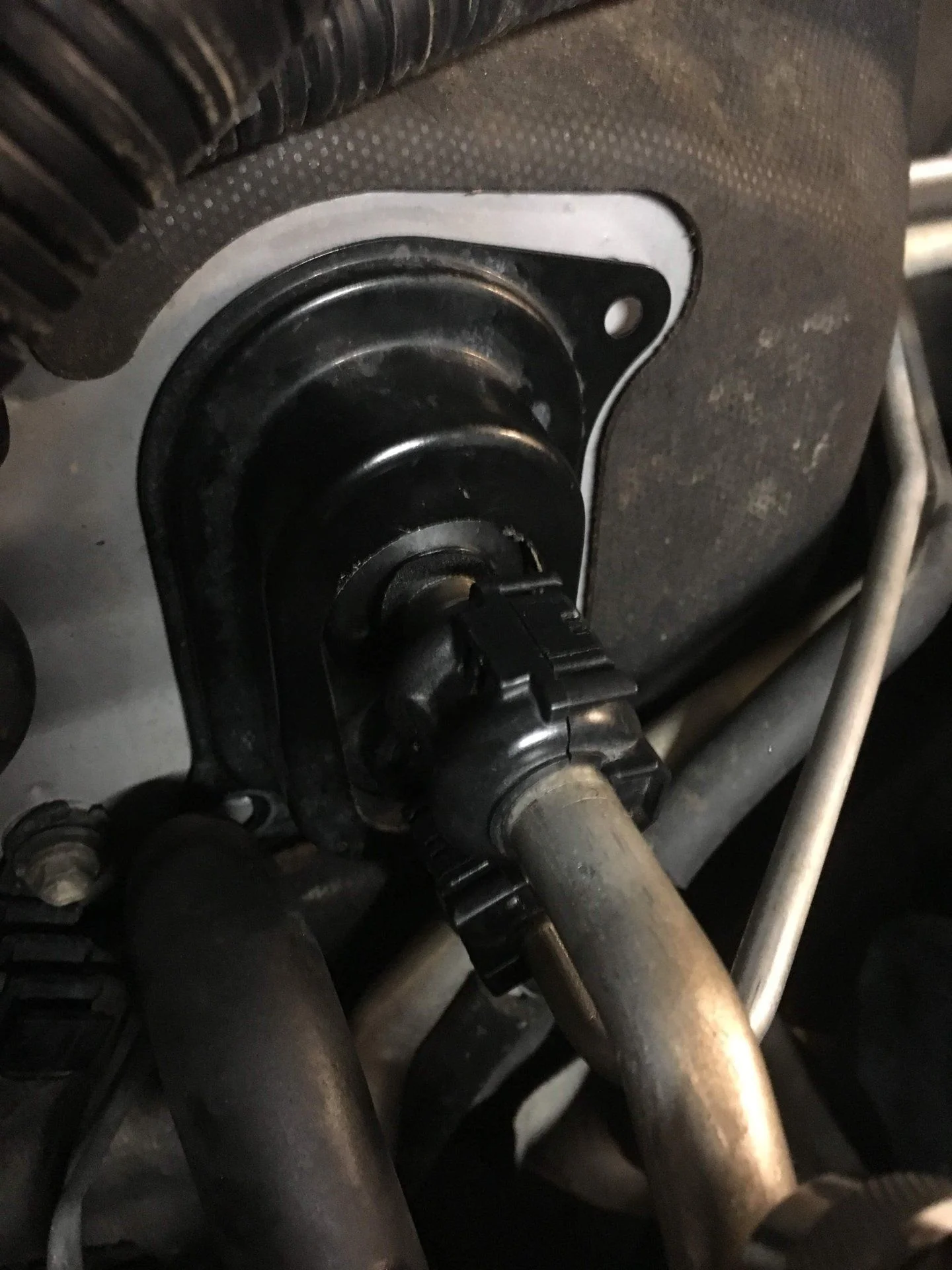

Start by un-clipping these plastic connectors. I used a dart tip to push down but any sharp object will work. Remove the metal cover, two alen screws and rubber plug.

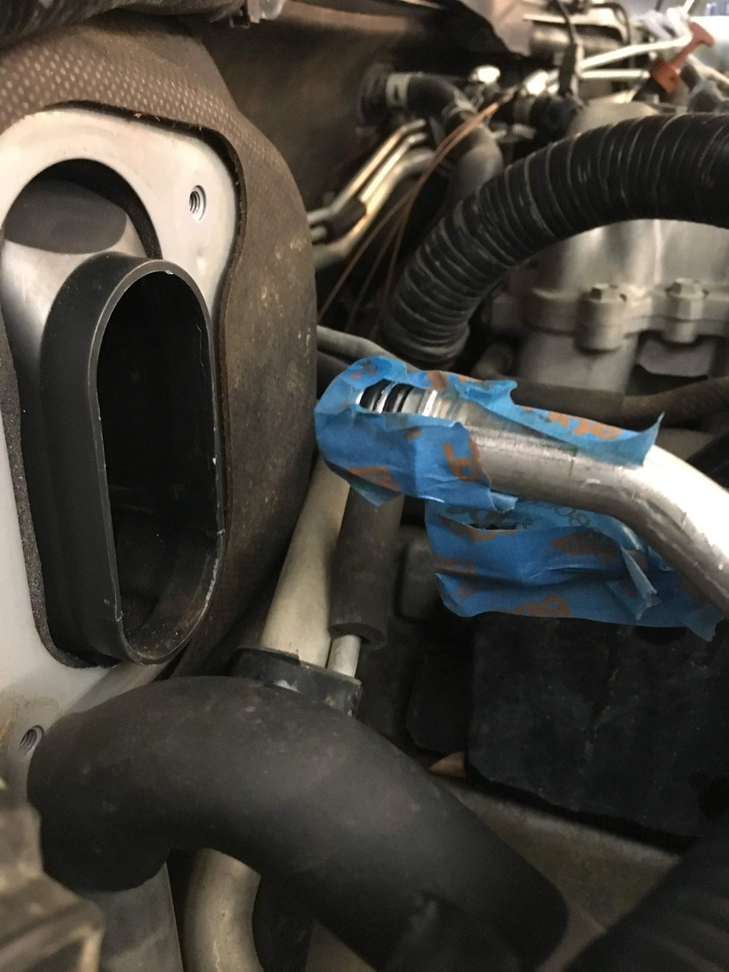

The o-rings looked dry on one side and i covered the lines to keep dirt out.

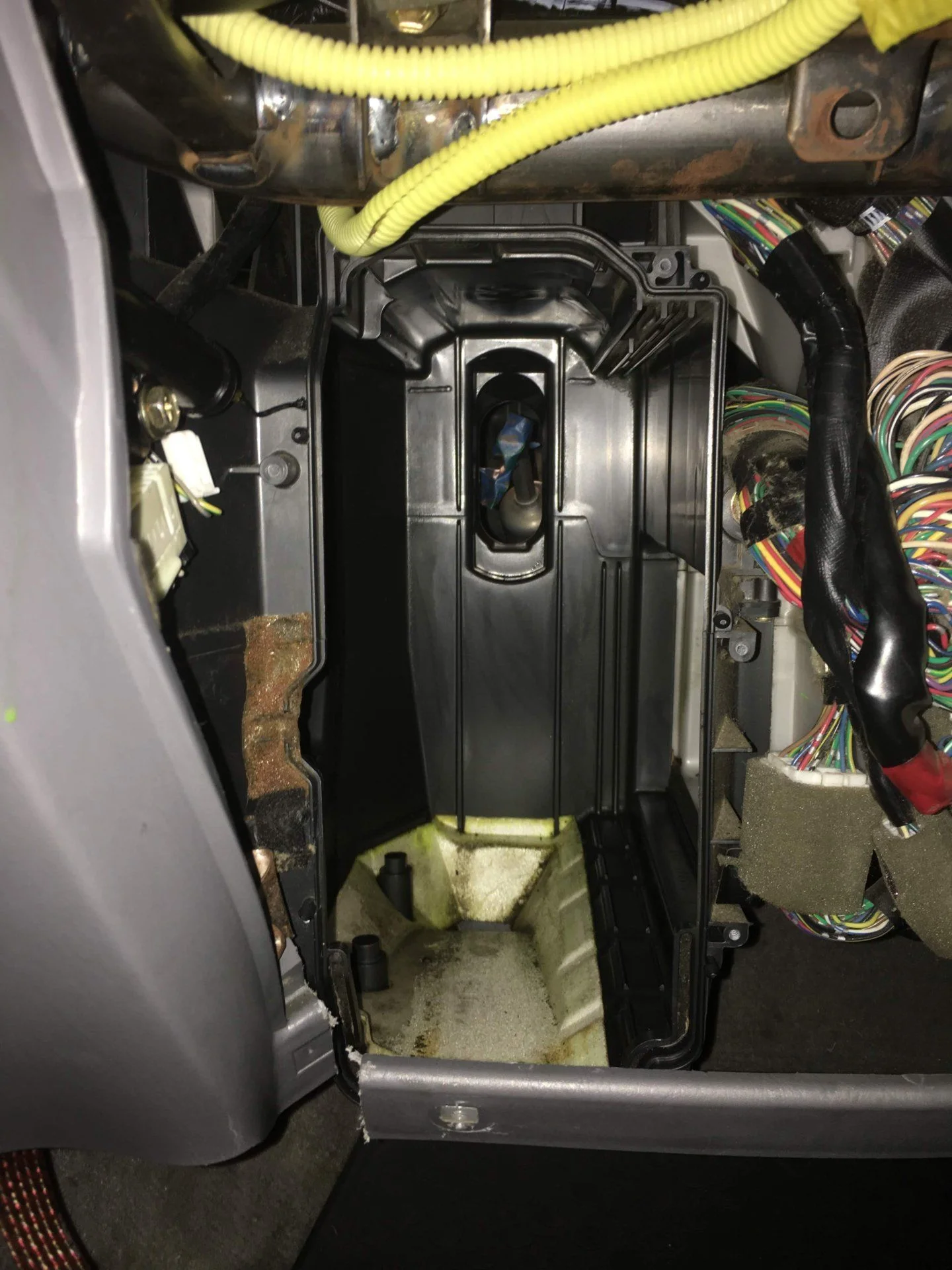

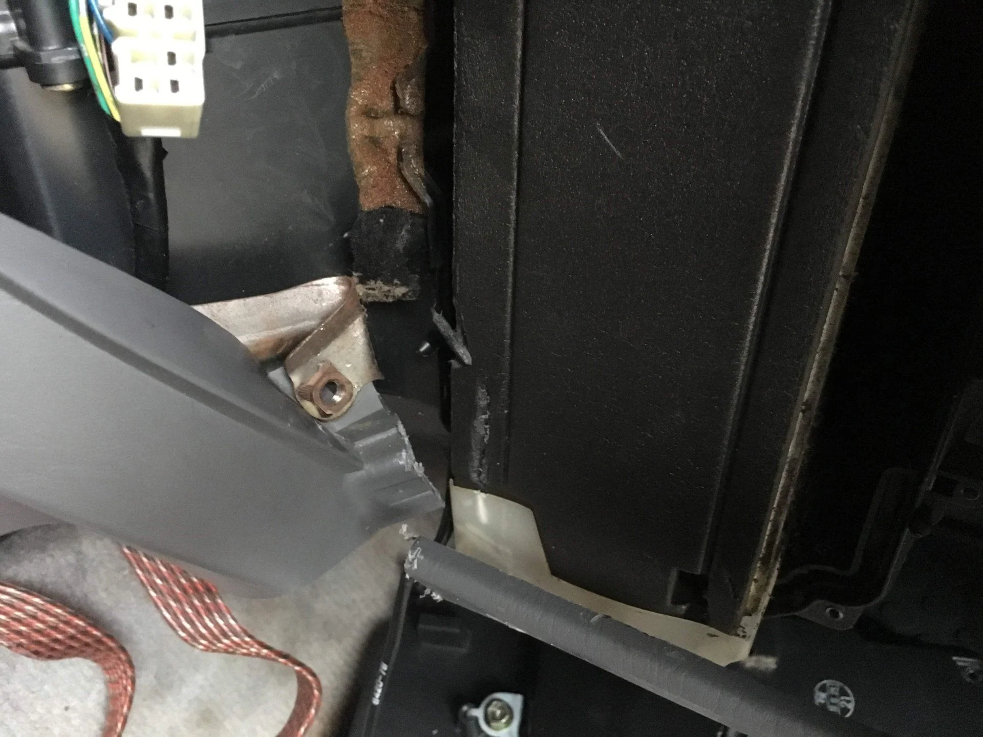

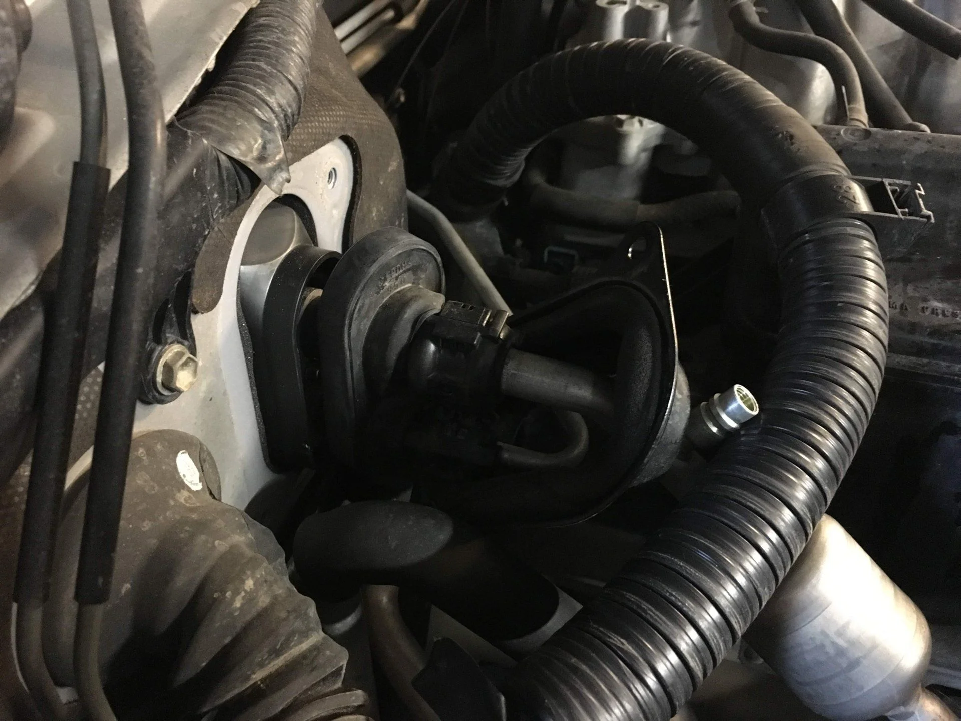

To the left of B there is a little indented line. Use a blade to cut thru. Remove the screw and bend the metal towards you. I used the same metal to hold the plastic. This will give you enough clearance to pull the evap straight out.

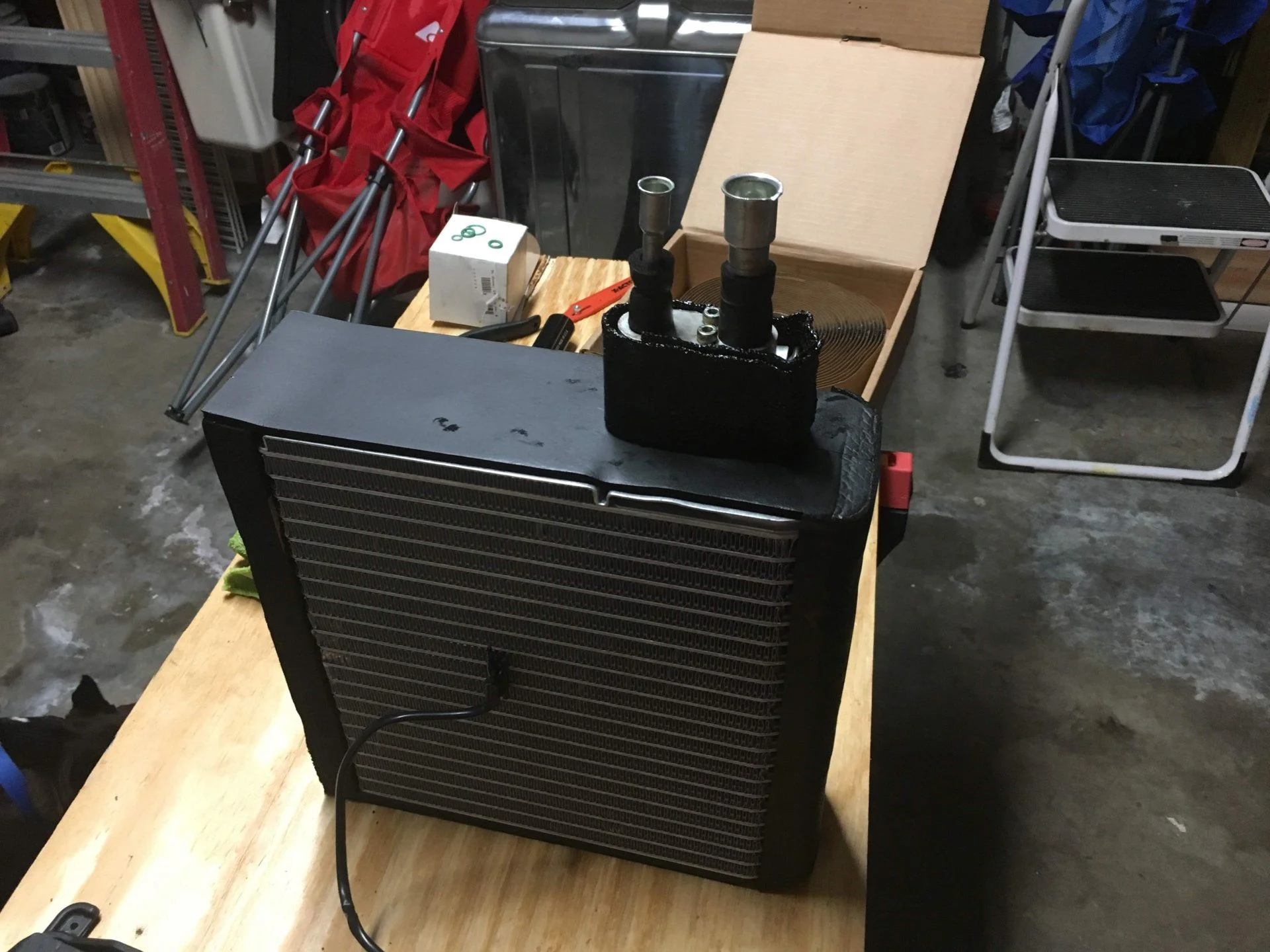

Remove the screws on the evap cover and unplug all connectors on evap cover.

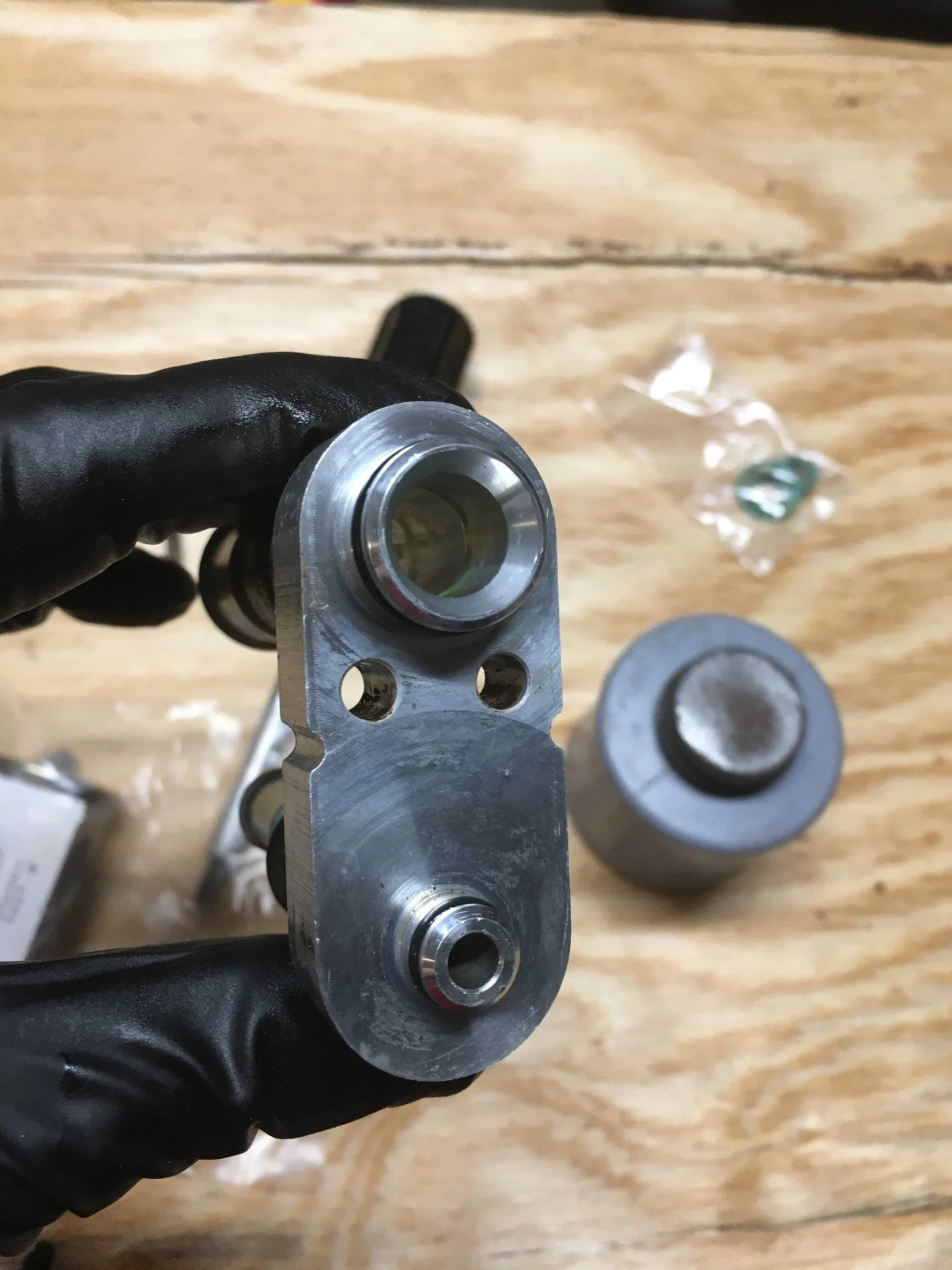

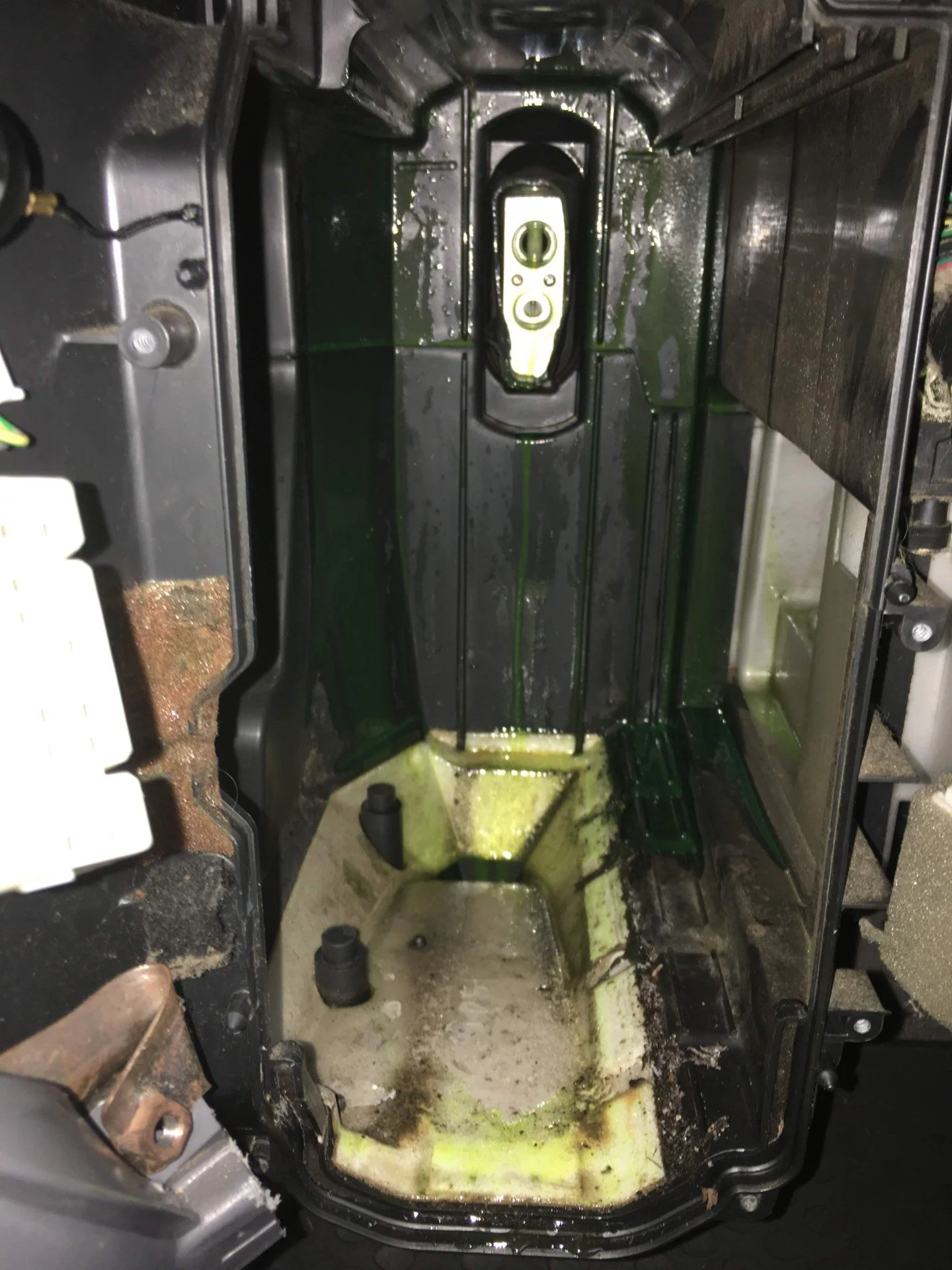

Pull the evap straight out. If there is pressure still you will get oil spray. In my case it was oil and the green dye i used to try and locate the leak.

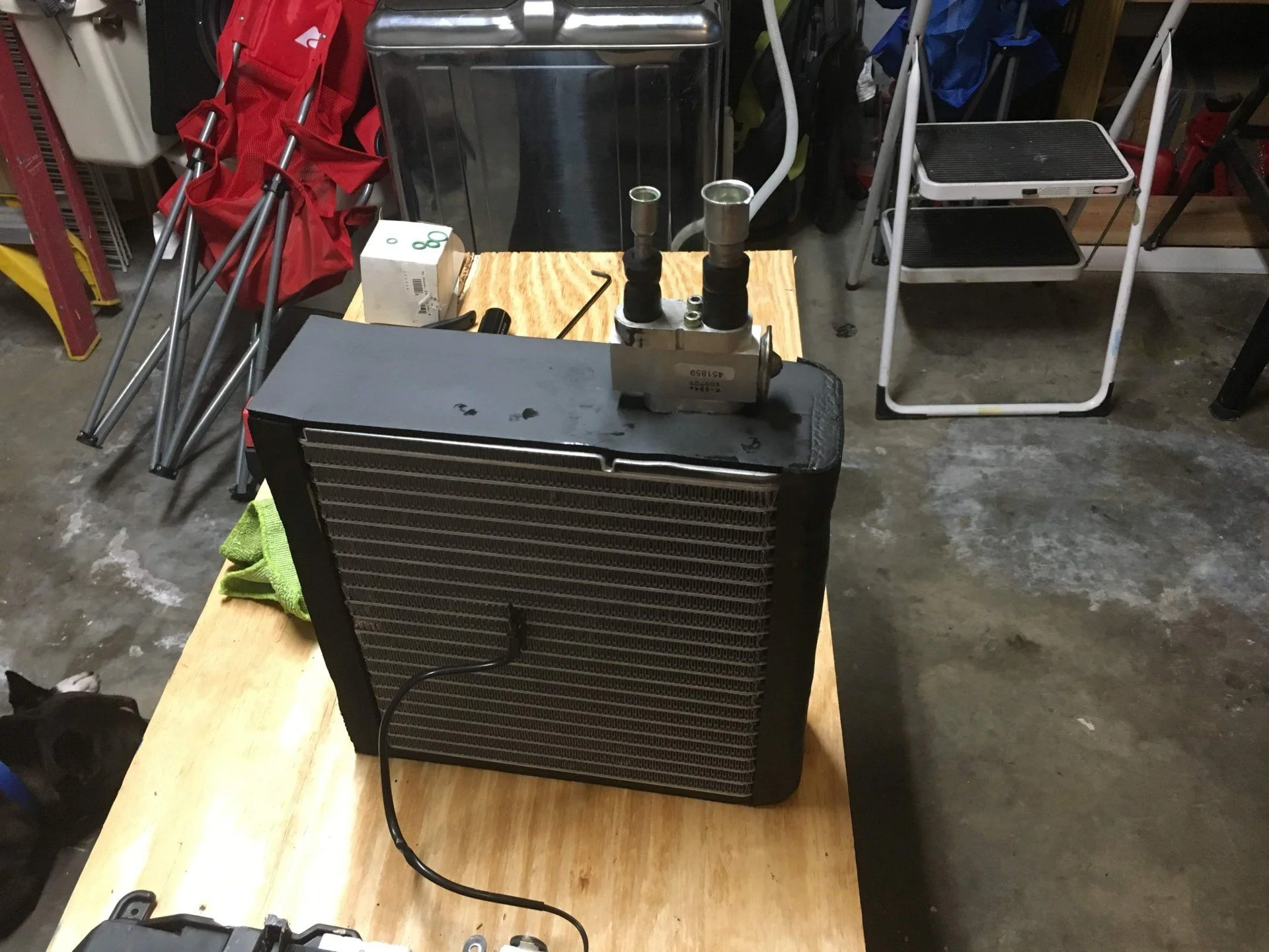

Clean it all up including the expansion vale and all mating surfaces.
Get it nice and clean. Clip the evap cable back on, connect the evap to the intake tubes and screw in. I used a little anti cease on the alen screws. Wrap the tape around the evap. Putting the evap back in with all connections was easy, you wont damage anything if careful.

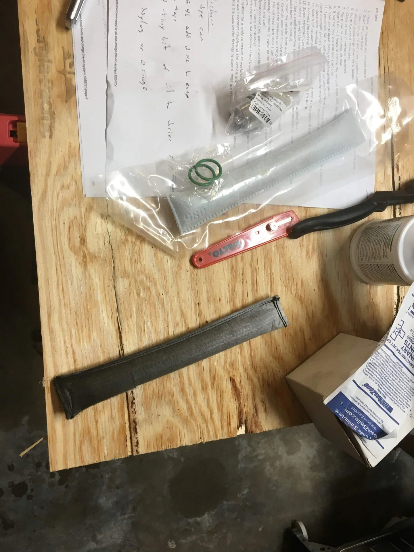

To replace the receiver/dryer just look under the condensor in front of the radiator. There is a 10mm alen head. Remove it and you will see a plastic filter and the desiccant tube. You may need to use long needle nose pliers and in a twisting motion to pull it out. Dont forget to add oil to the o-rings here also.
