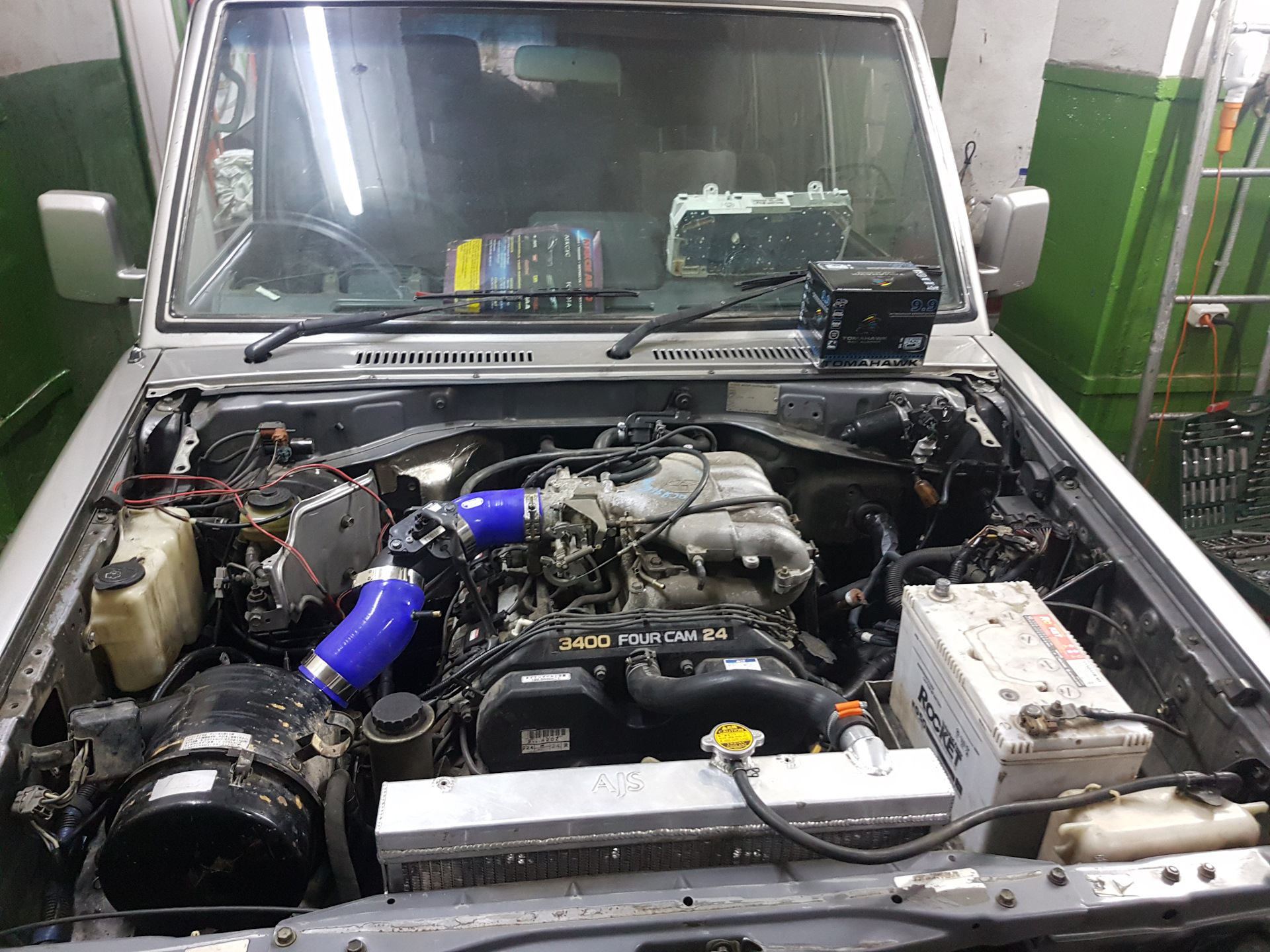

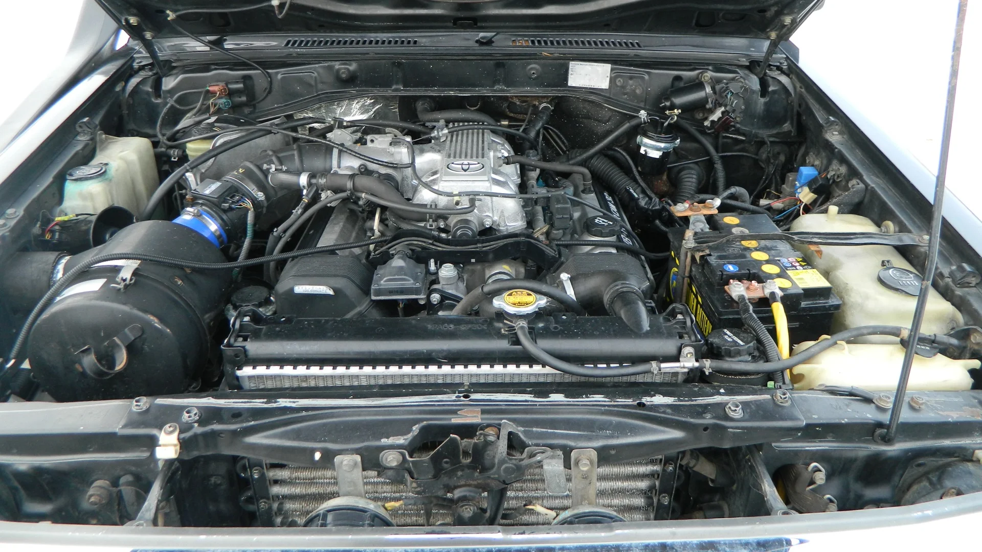

Prado engine bays lend themselves nicely to V6 or V8 engines. So for capable gasser swap, look to 1UZFE/2UZFE, 5VZFE. Those are pretty much all better than a 1FZ anyhow.
1UZFE in one for example:
5VZFE
