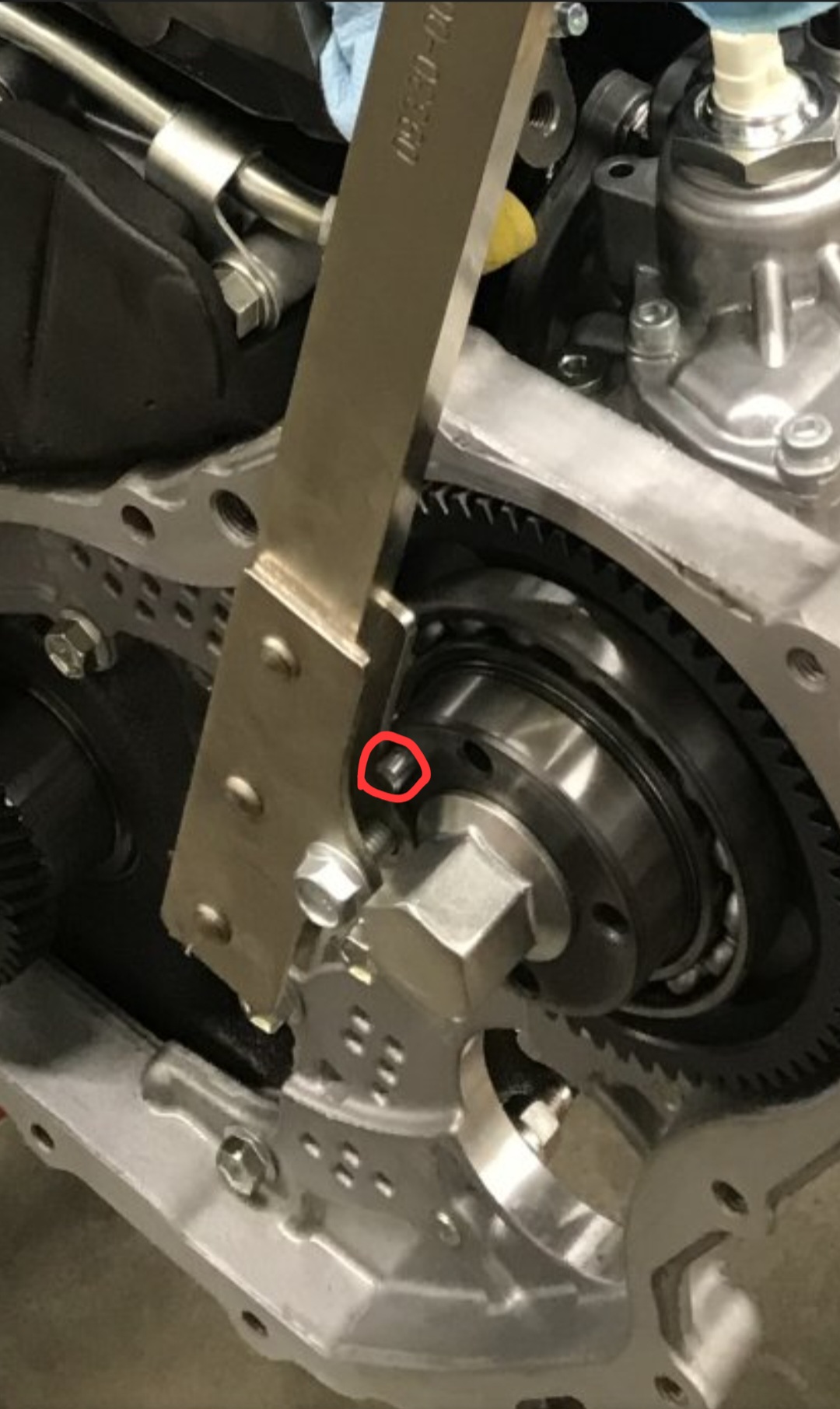

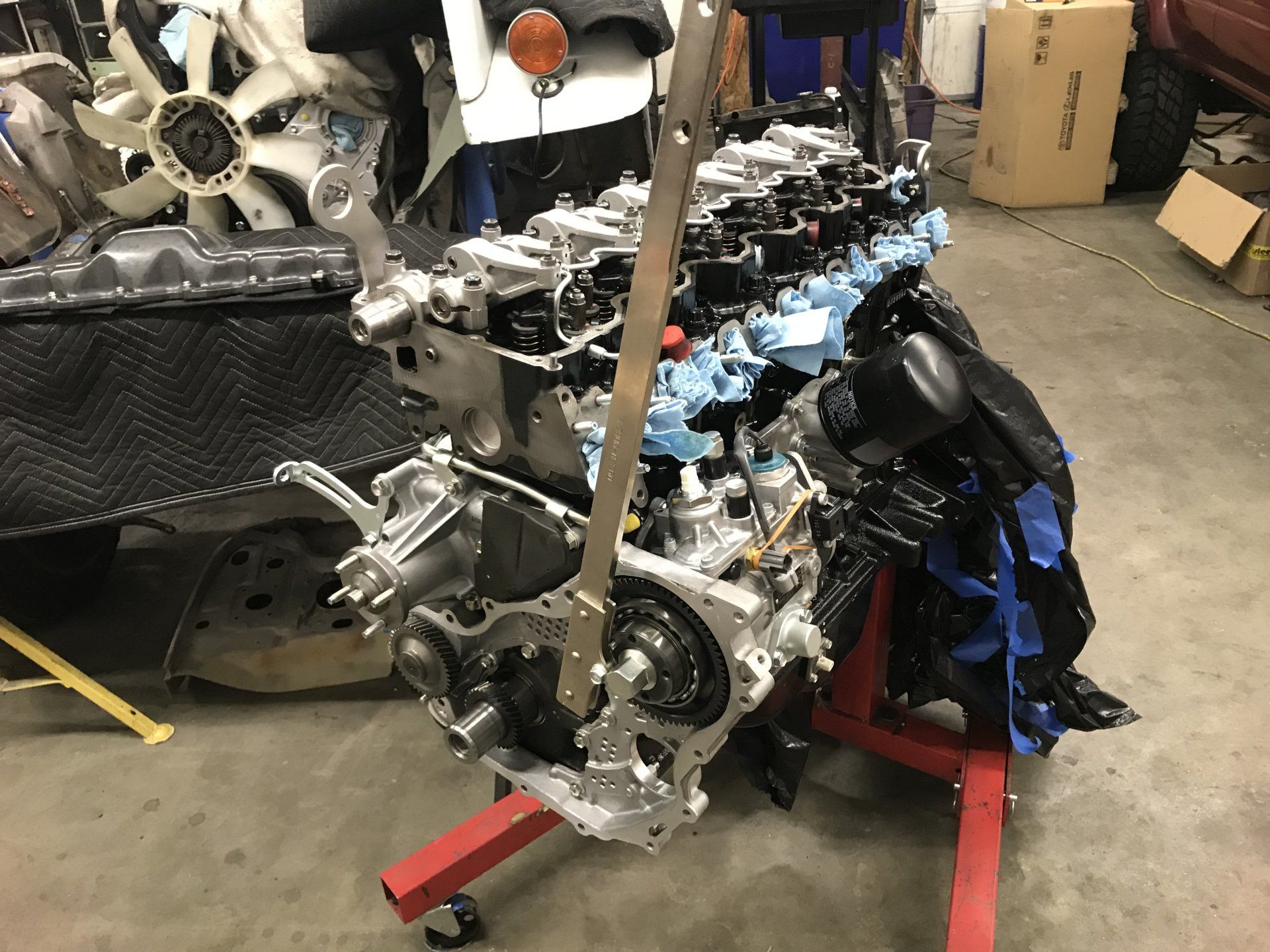

The SST is actually a very simple tool.
Easy to make one but iirc it was not very expensive. It is also a dual purpose tool, the other end of it has holes that match up to a wide variety of Toyota flanges such as pinions. So you can use it when torquing pinion nuts. And on that note, the SST is more useful when installing the pump so you can hold the IP shaft and get a correct torque on the IP nut.

Can you use an impact gun to remove shaft nut? I can't get it to budge with a breaker bar.
How are you keeping the pump from rotating when you’re getting the nut off? I even have the special service tool, but it only points at one point and it spins every time I try to turn the nut.
