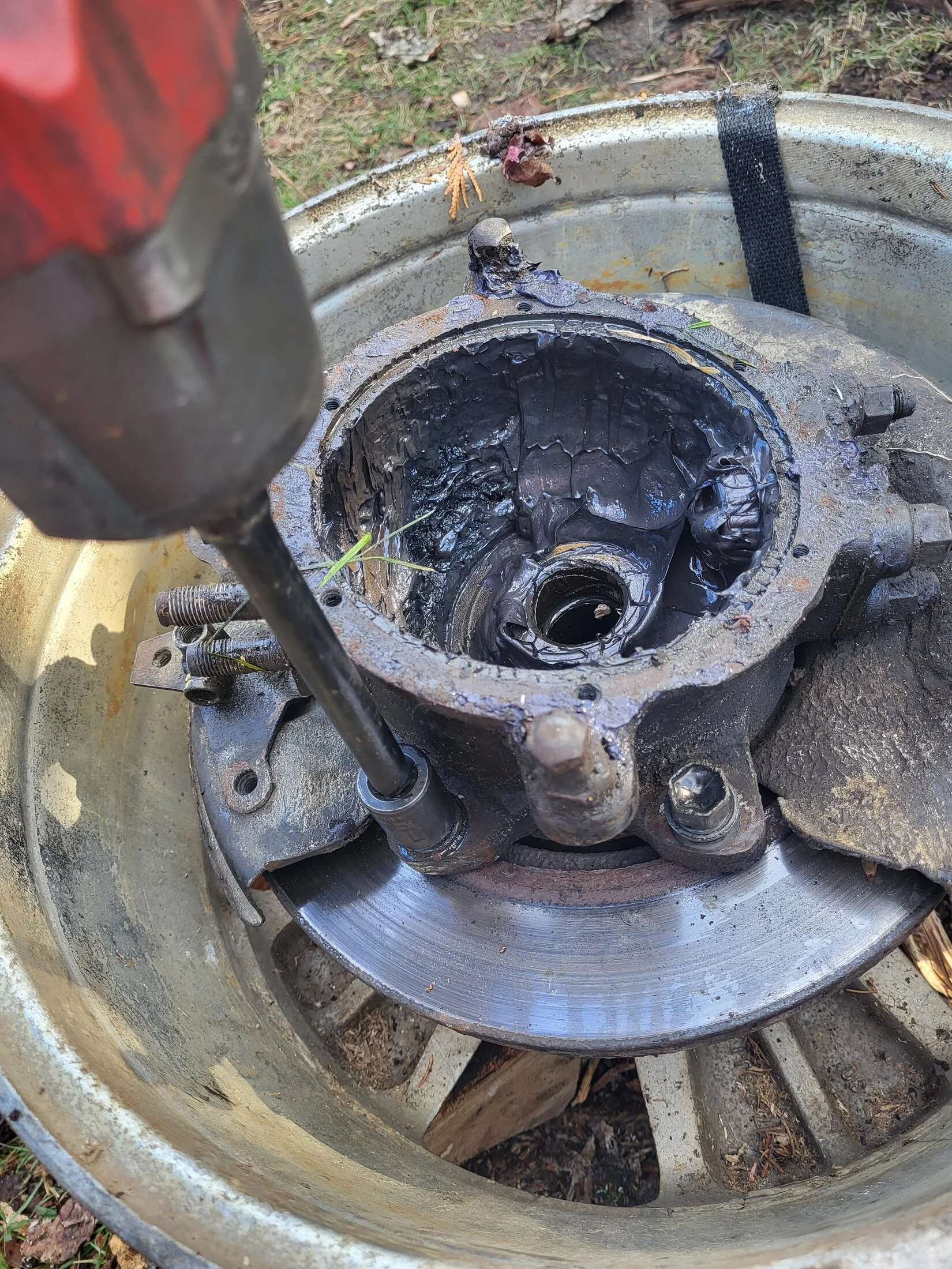

Removed the hub after steering and upper trunion, remove wiper seal.

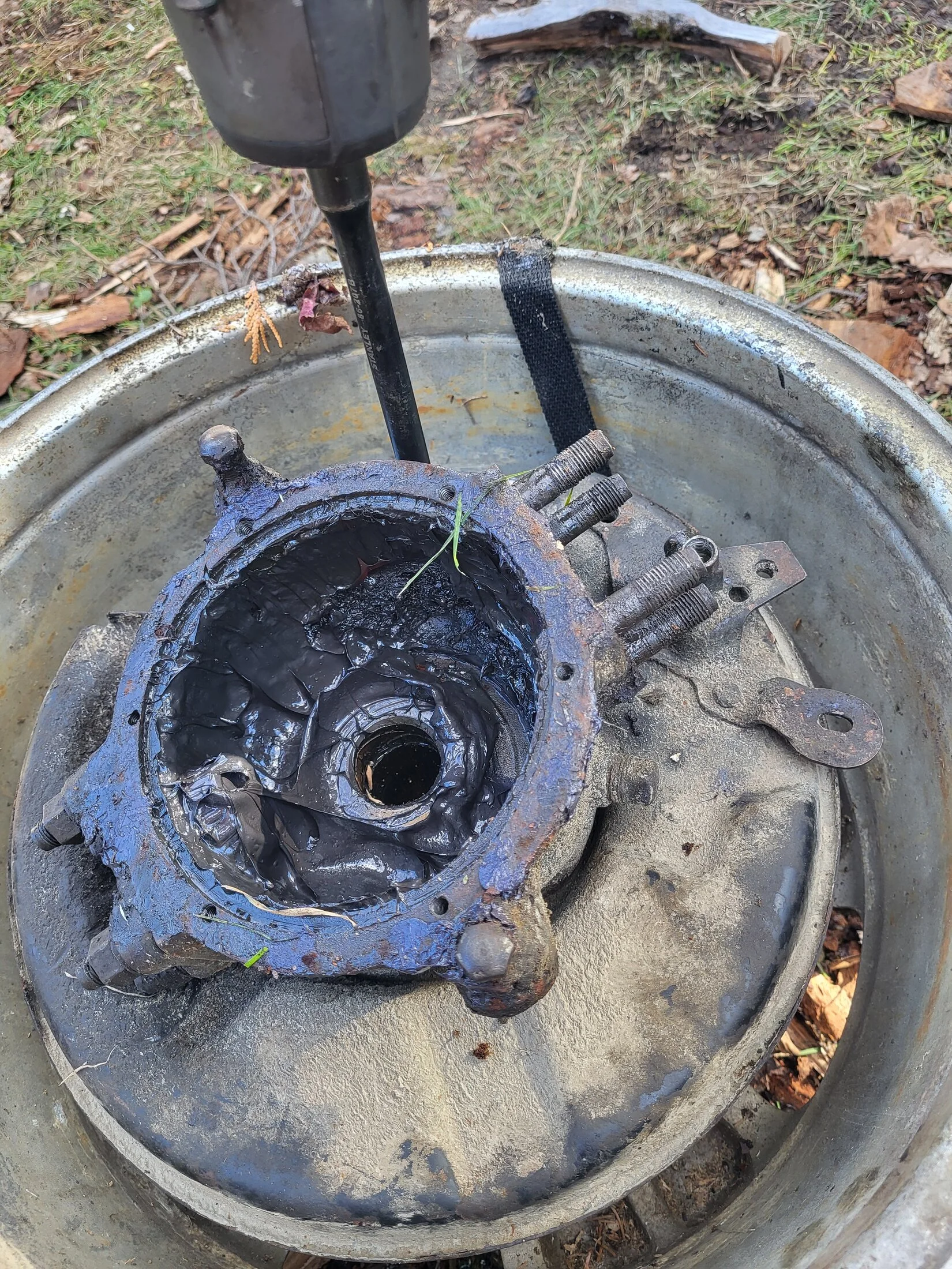

Used spare brake caliper bolts into bracket to force bearing off of spindle.
Tighten bolts, release, move across and repeat.

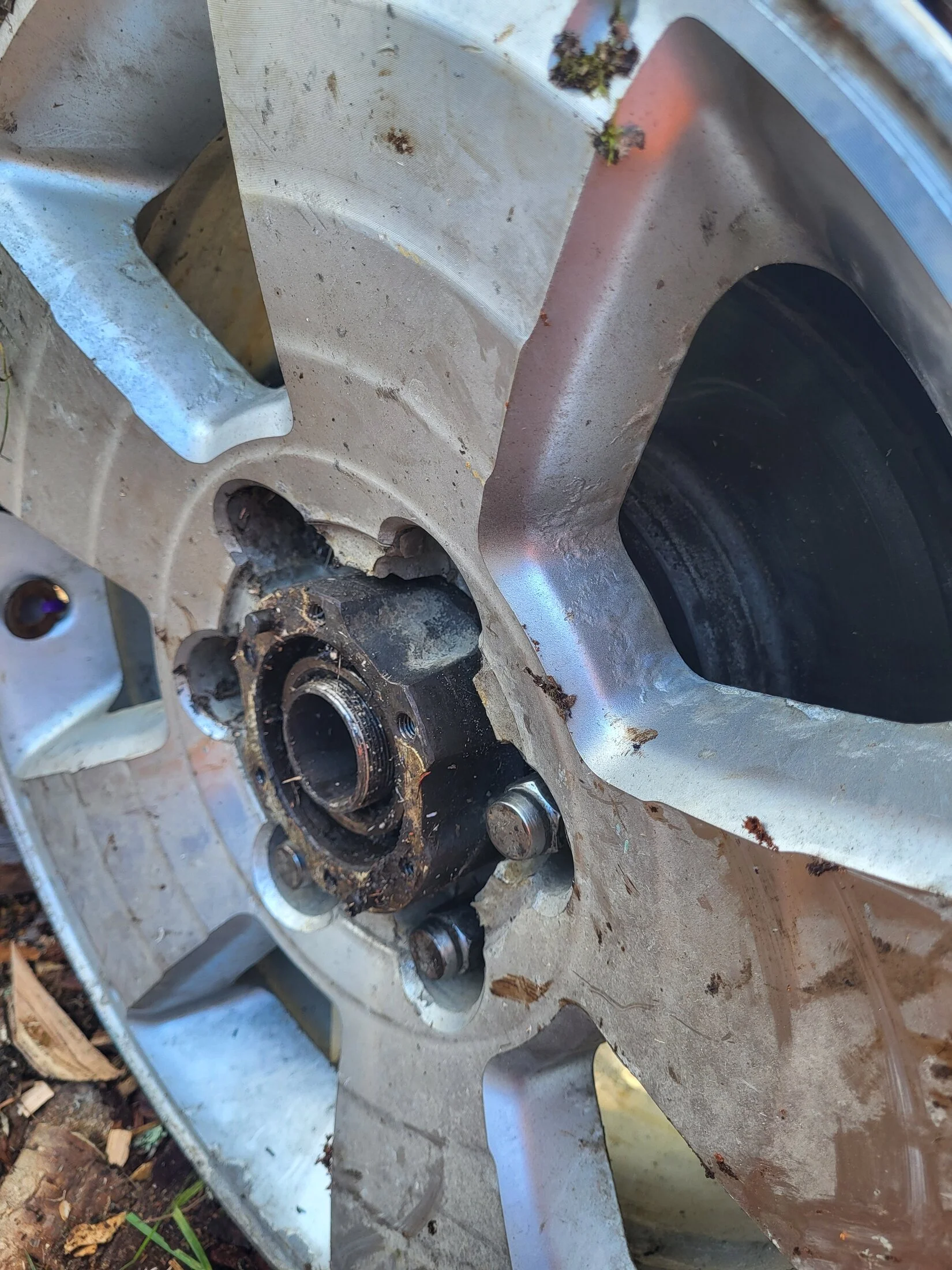

Bolted hub onto a spare rim. Rim is supported by some firewood for the sake of gravity.

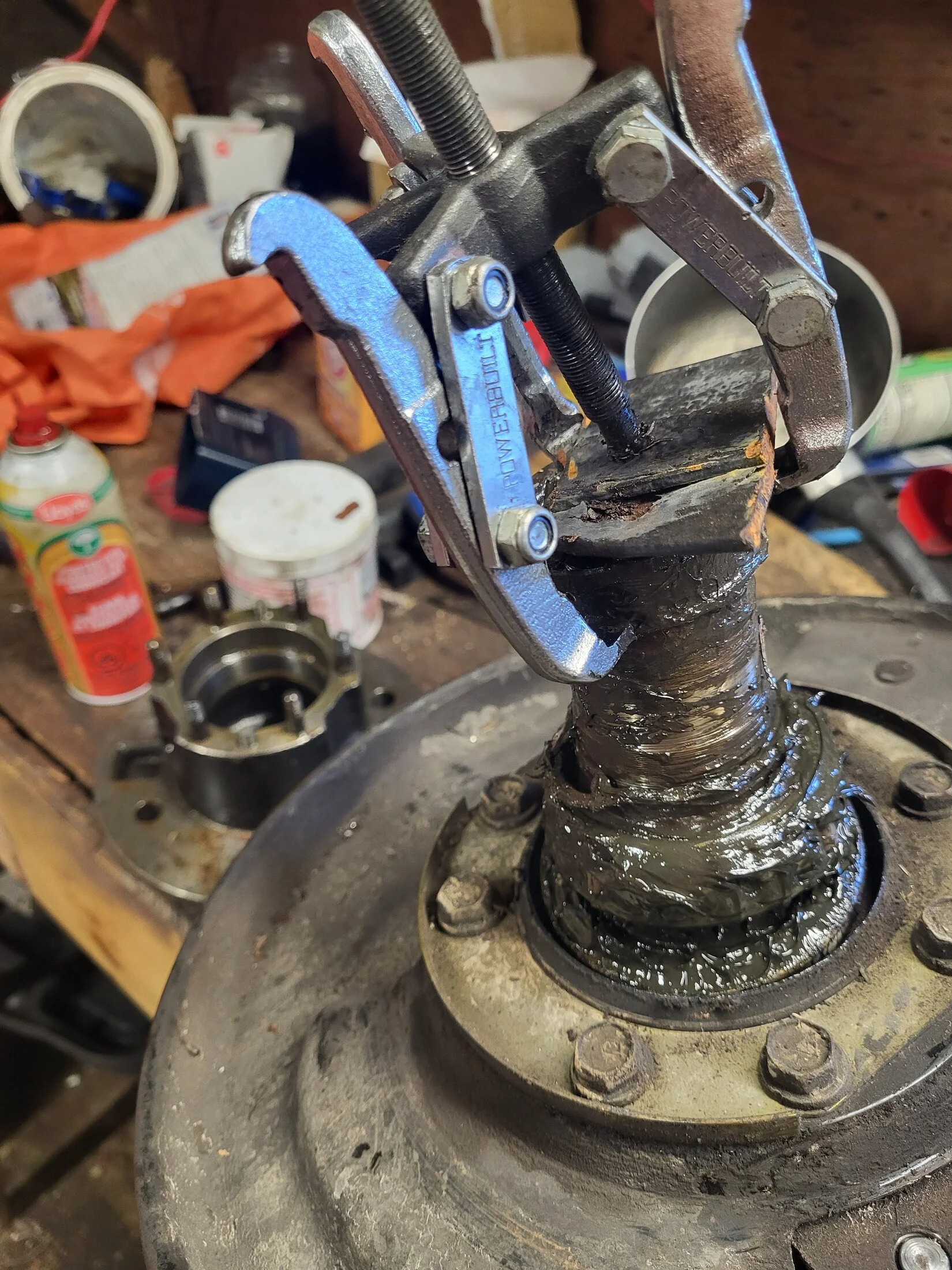

Finish off with a puller if required.
If you can't get the studs tight use washers...
