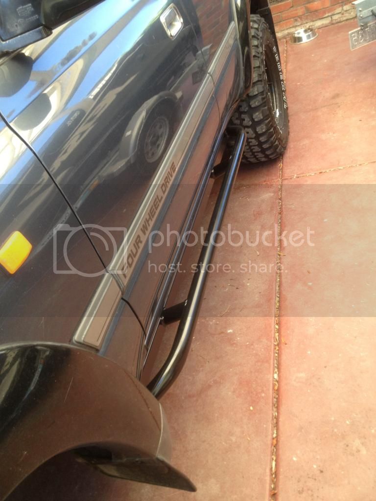

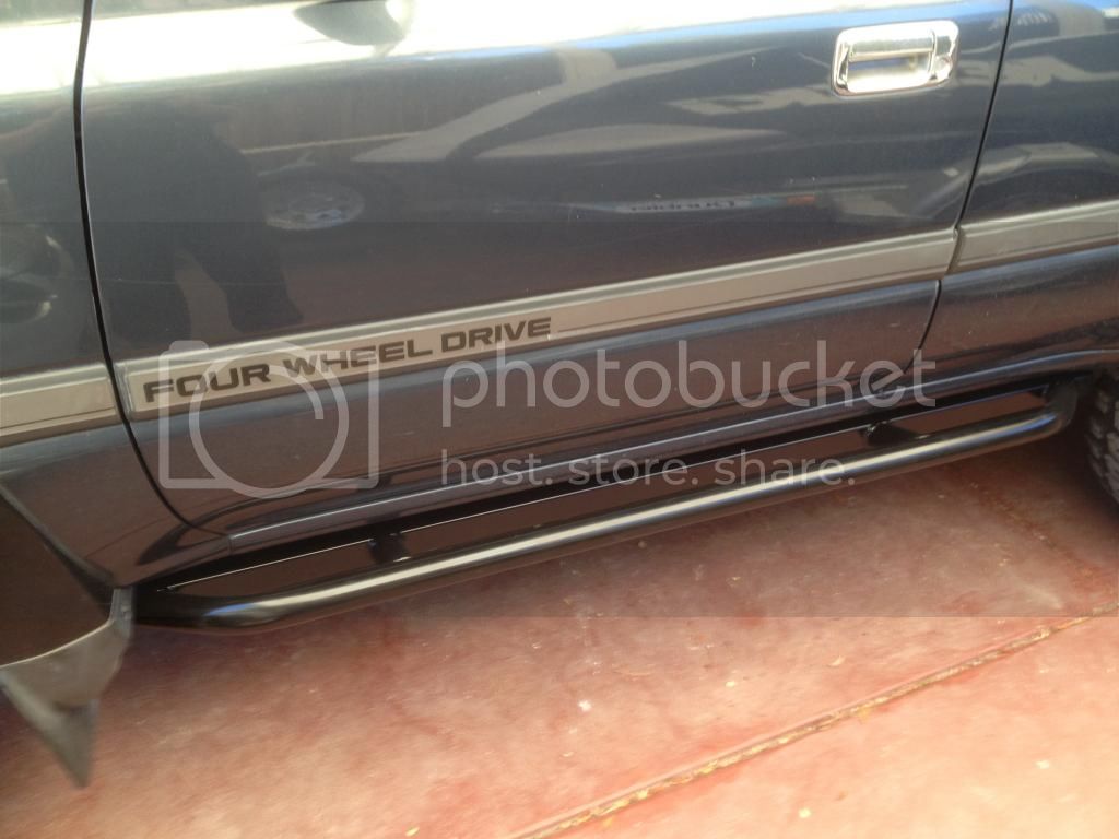

Fit something like these?
Paid for themselves last trip offroad going over a rock ledge.

Just my 2 cents but Bump It Offroad has two options, I chose the tube type sliders but had make lay the tube almost perpendicular with the ground as to act a a step as well as awesome protection, they run $725 powder coated or $625 unfinished as of last month anyways! Great choice among all that is out there. IMO!
I'm 6'3, 210 lbs and I stand on mine. In figure they won't break under your weight.
If you're not going to be doing any rock crawling, I would just spend ~$50-100 on running boards instead of buying $750 rock rails. I wheel my truck with the stock running boards. I wanted to take them off, but the :princess: said no.
