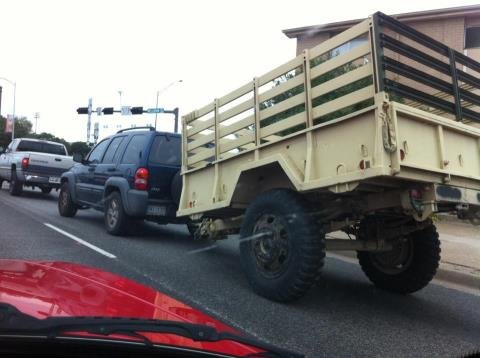

I hate to be that guy, especially after the entertainment from your chicken coop thread, but if you get the proper truck to pull it you won't care about the weight. Think about getting a smaller trailer, like an M101A3. Stolen from web:
EDIT: Versus this
m101-2520libby-jpg.235141
Everything about the 105 is super heavy. I have both 105 and 101 type trailers, no way would I pull a 105 with a suv. Get rid of the whole axle and tires, the landing gear and the surge brakes. You would still have a massive frame and over kill for what you could haul. Just seems like you would be a head, money wise and safety wise to sell the 105 and look for the 3/4 ton M101 series trailers.
I went to go look at a 105 for behind my 40 and 80. One look in person and I could see it was way to much for our trucks. Sell your's, get a 101 or something else.
