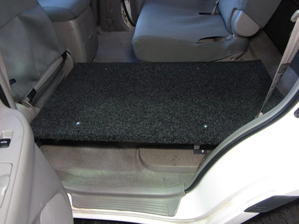

Tying to the floor was a puzzle to me for a time, but I landed on a solution that works well and requires no platform.
You can tie it down much more simply if you use the existing seat bolts and use them to secure a length of chain between the two bolts on teh side you intend to mount the fridge on. This gives you the ability to tie to any point between the two bolts using any link in the chain. In the rear you can use the seat anchor to secure the back. I do this with my National Luna 60L Twin.
My NL 60L Twin fits longitudinally behind the passenger seat, despite being 21 inches tall.
By mounting it on the floor, you'll also give yourself more room to open the ARB's lid that unfortunately hinges on short end, so the lid pops up pretty high. If I were you I'd want it as low as possible.

yeah I leveled mine using a lazy mans method. Not difficult to do....
