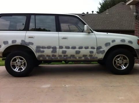

Well coincidently I ripped off one off one of my flares over the weekend. I have been going back and forth about removing them all and doing the bed liner option... On the fence.. I like the look but also know it's only a matter of time before another one comes off. Just need some input on whether to or not if anyone has done it before and has liked or not like it. I know there are threads on it but I'm curious on how it holds up (color) in the AZ temps. Thanks!!

There are a bajillion little holes if you remove all the cladding, but work doesn't seem to deter you.

I have read there are somewhere around 110 holes to fill :eek: , doesn't sound fun to me.
I am getting ready to get my whole truck lined here, hopefully before the end of the month. I have a friend who is going to Rhino line it. I had heard numerous stories of not being able to line the cladding so I contacted Rhino directly. They say it will absolutely stick to the clear coat and may not stick to the bare plastic unless you completely encapsulate the panel. Depends on the chemical makeup of the plastic if it will stick or not. If it is on bare metal then it needs to be primed, cant remember which primer they suggest except for a very expensive "spot weld" primer.
162 counting the roof rack and roof ribs....
Couple of days worth of welding.
I'm an idiot, though. Knew I preferred a Poverty Pack appearance, but reason didn't enter the equation when the "perfect" LX came on the radar, 4 hours away, after many, many months of looking.

did you mig weld it? Big holes to fill without warping the metal I'd think

They're huge slots and holes, way too much to fill, so used body nails and MIG.
Wouldn't do it again, either. Prefer flareless, becoming less a fan of the previously planned liner, and paint deserves a better finished priduct that what I was capable of filling.
Should've swapped door skins or skinned the inner panel.
