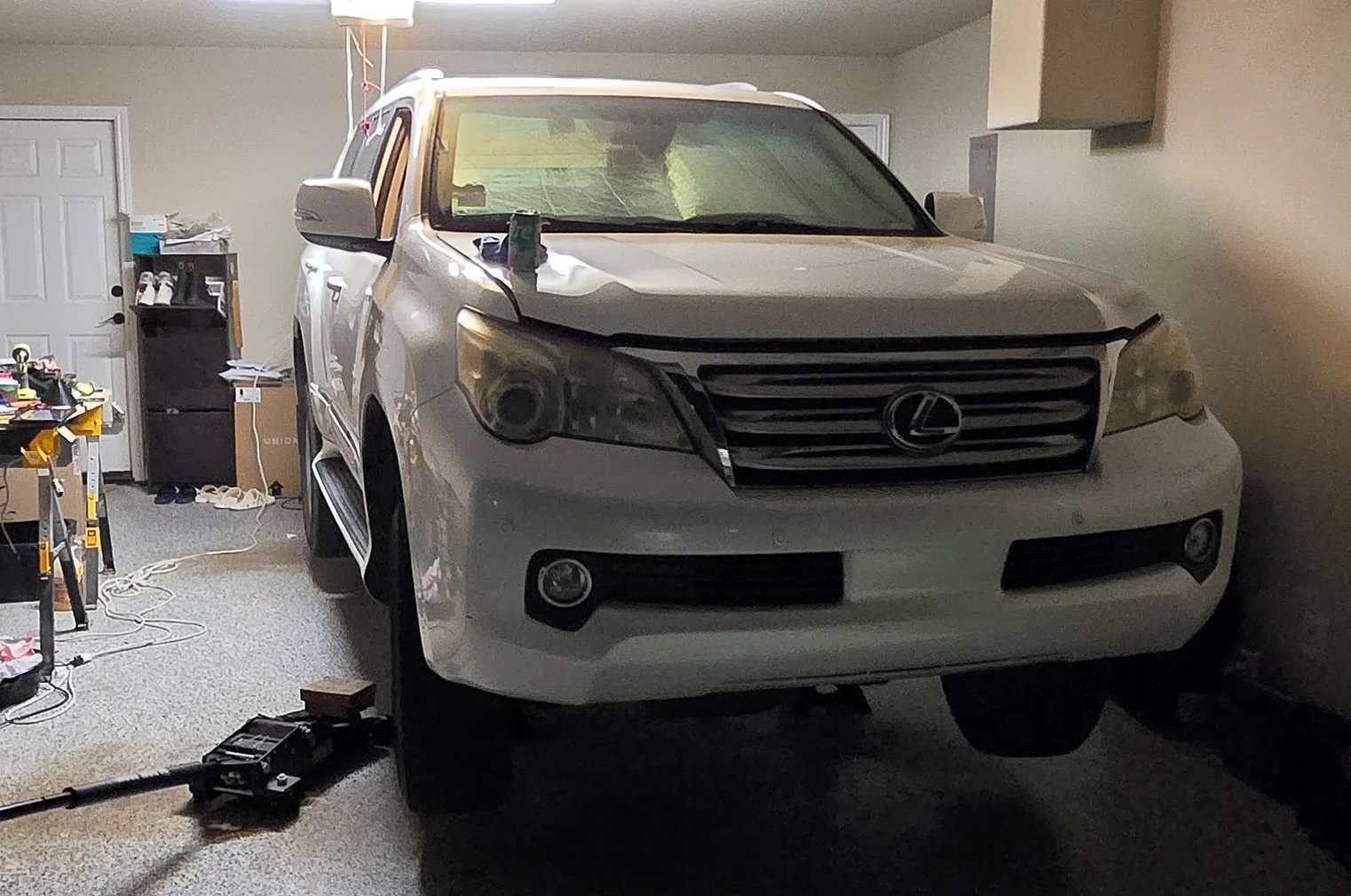

Finaly decided to rebuild the transmission
2012 GX460 100K onboard overheat coolant one time at vail,CO
The vehicle has experienced multiple transmission error codes (2714, 0761, 0896) and has undergone transmission line flushing and fluid replacement. Despite these measures, the reverse gear has deteriorated from a cold-start no-reverse condition to a slipping condition, especially under load or when turning. Faced with a $7500 repair quote, I have opted to perform a self-rebuild and am currently sourcing a transmission rebuild kit.
Hey guys, any recommendations for transmission rebuild kit brands?

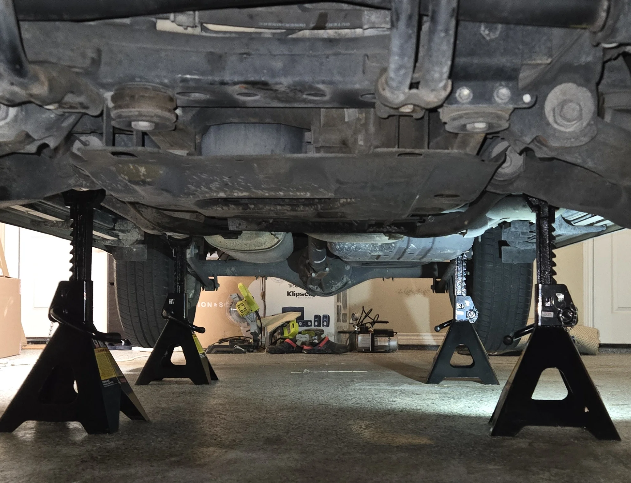

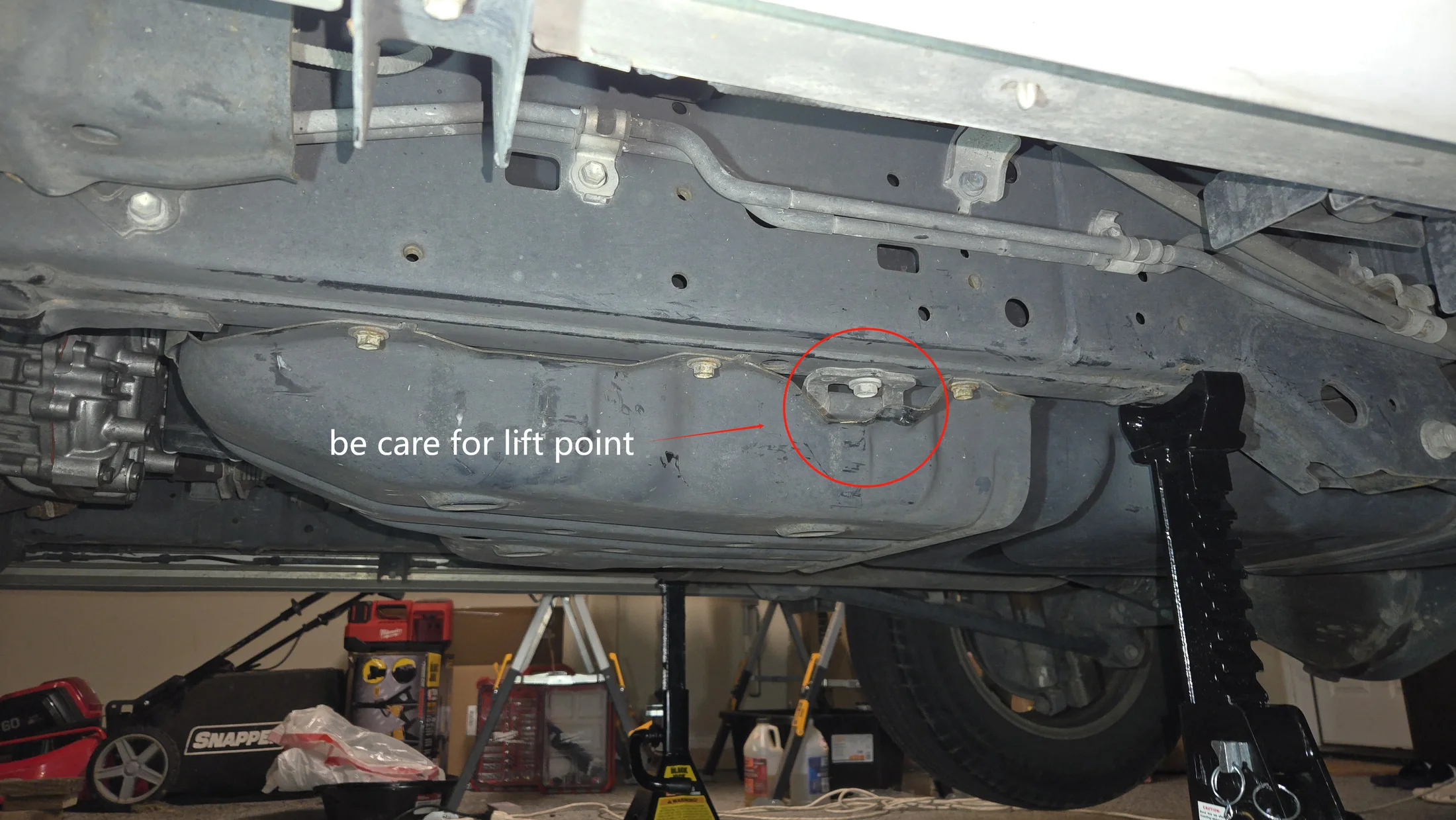

be careful for driver rear side lift point

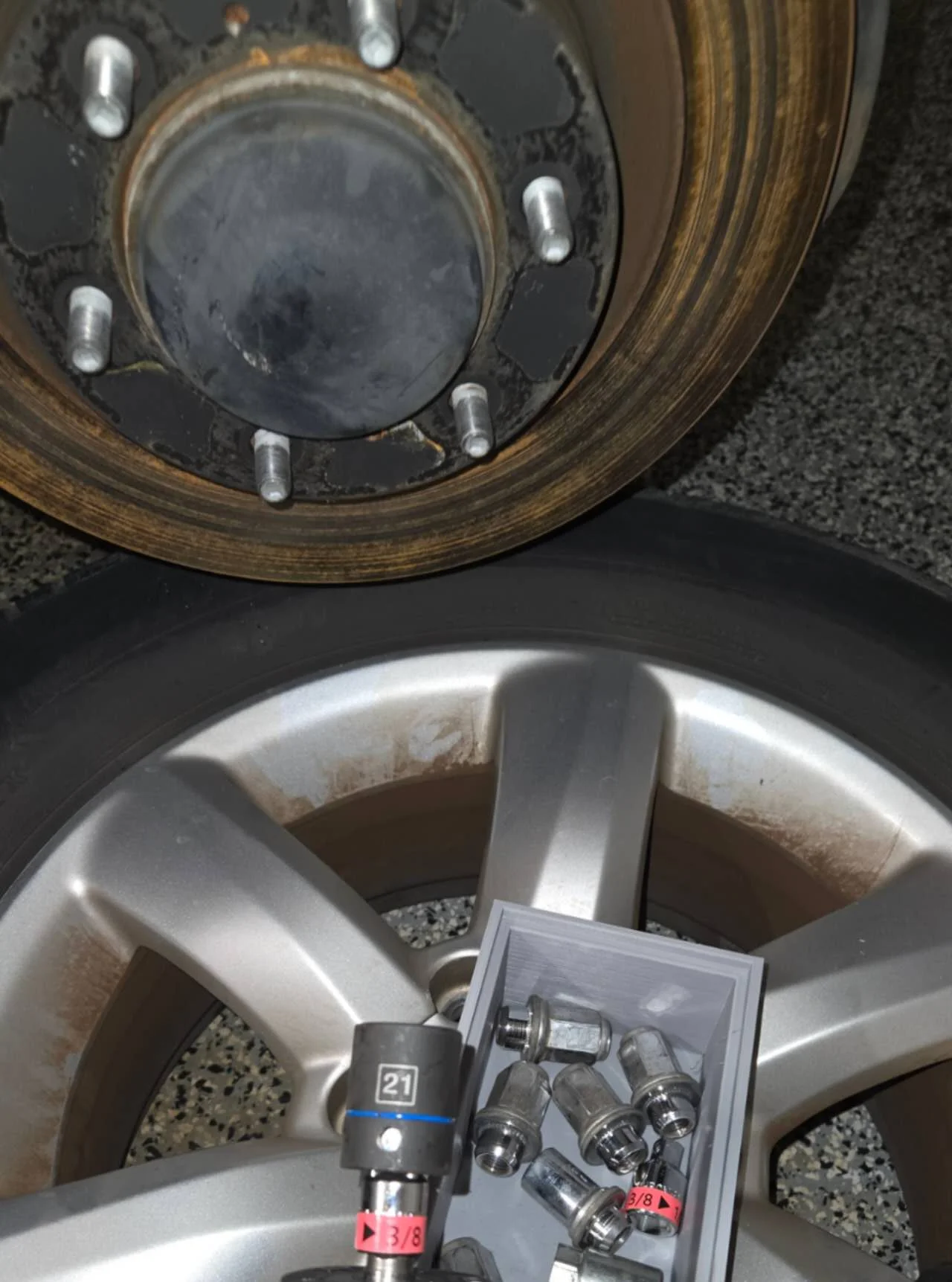

remove passenger side front tire torque 83ft/lbs

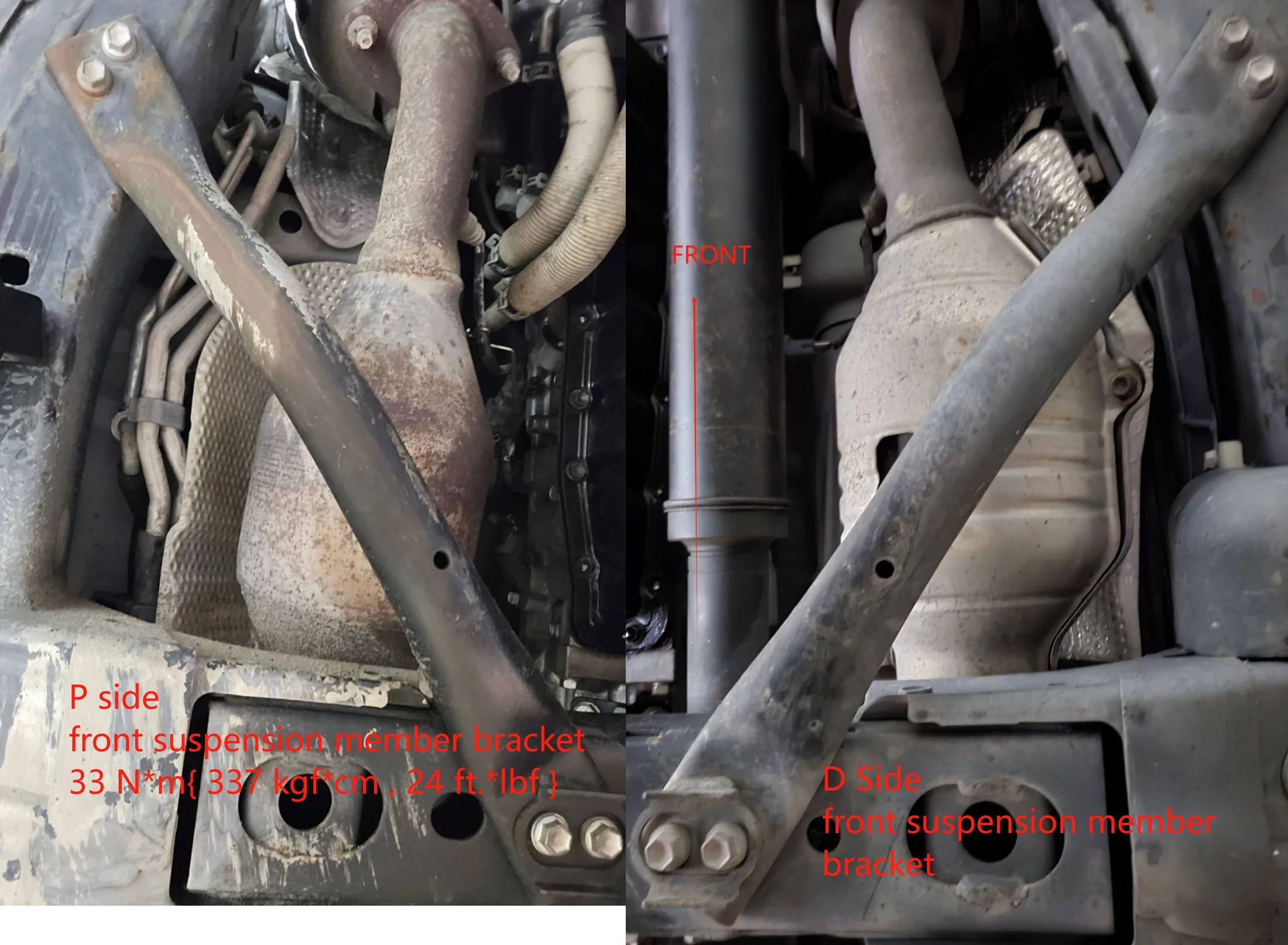

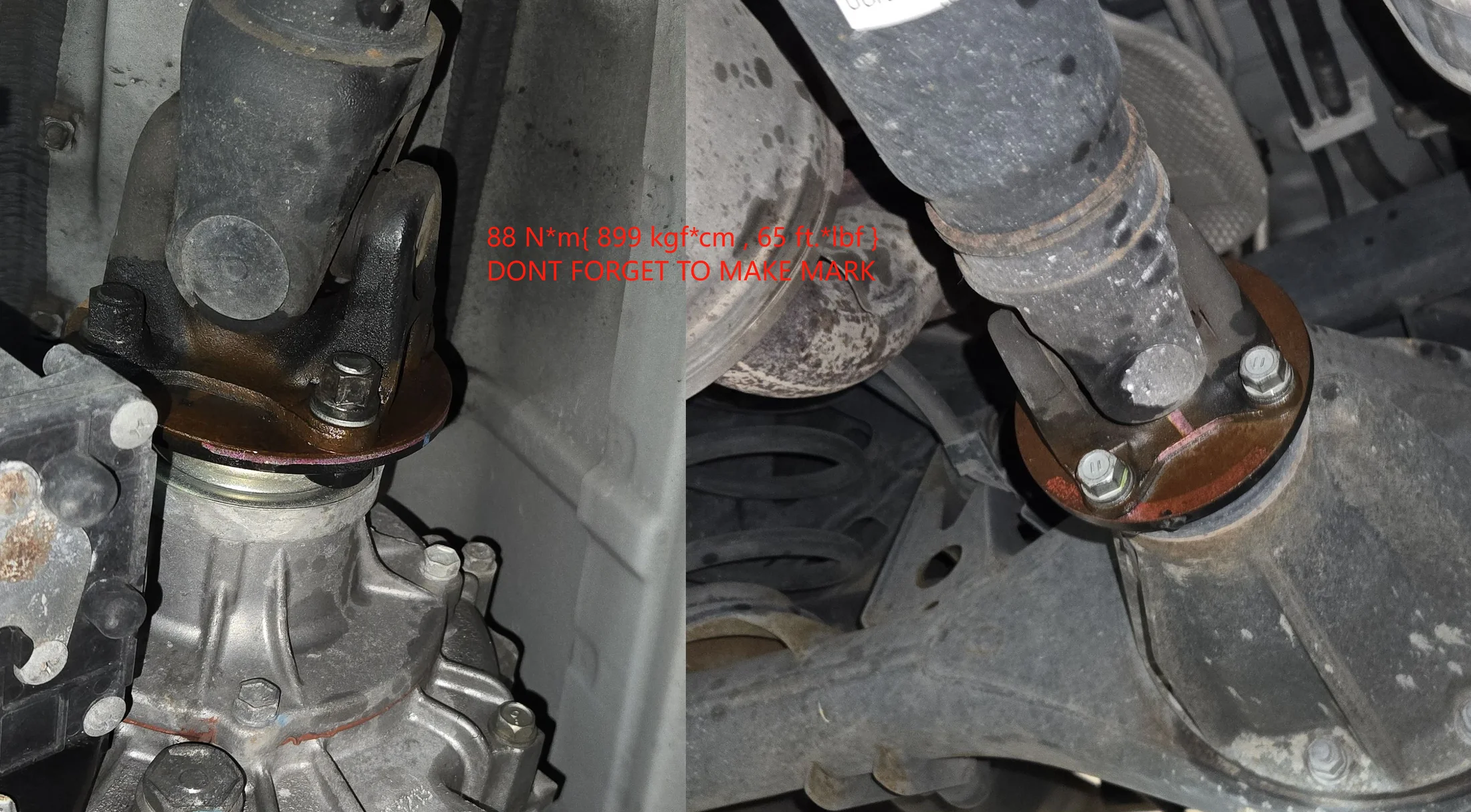

remove rear PROPELLER SHAFT
propeller shaft flange and differential flange
4 bolts, 4 washers and 4 nuts.
propeller shaft flange and transfer flange
use markpen make mark for install
may need use wd40 and high torque wrench to remove

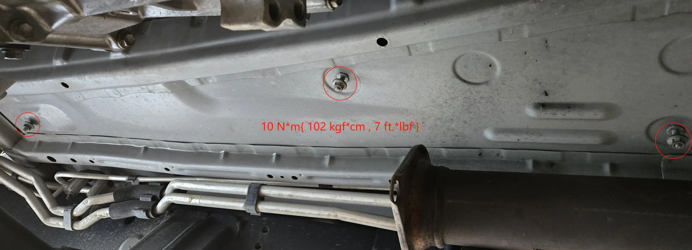

REMOVE PROPELLER SHAFT HEAT INSULATOR

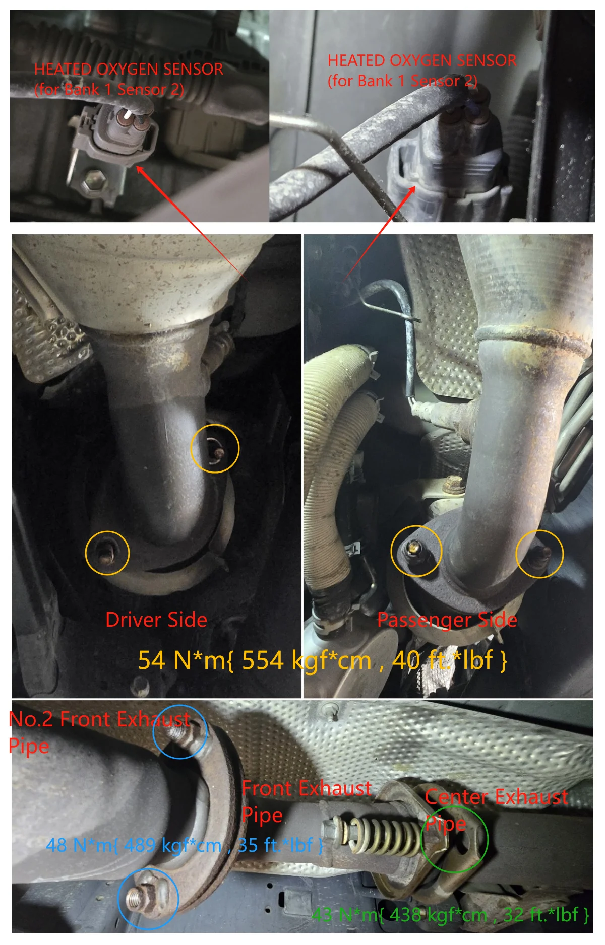

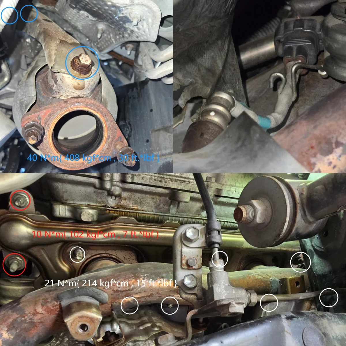

REMOVE HEATED OXYGEN SENSOR AND EXHAUST PIPE

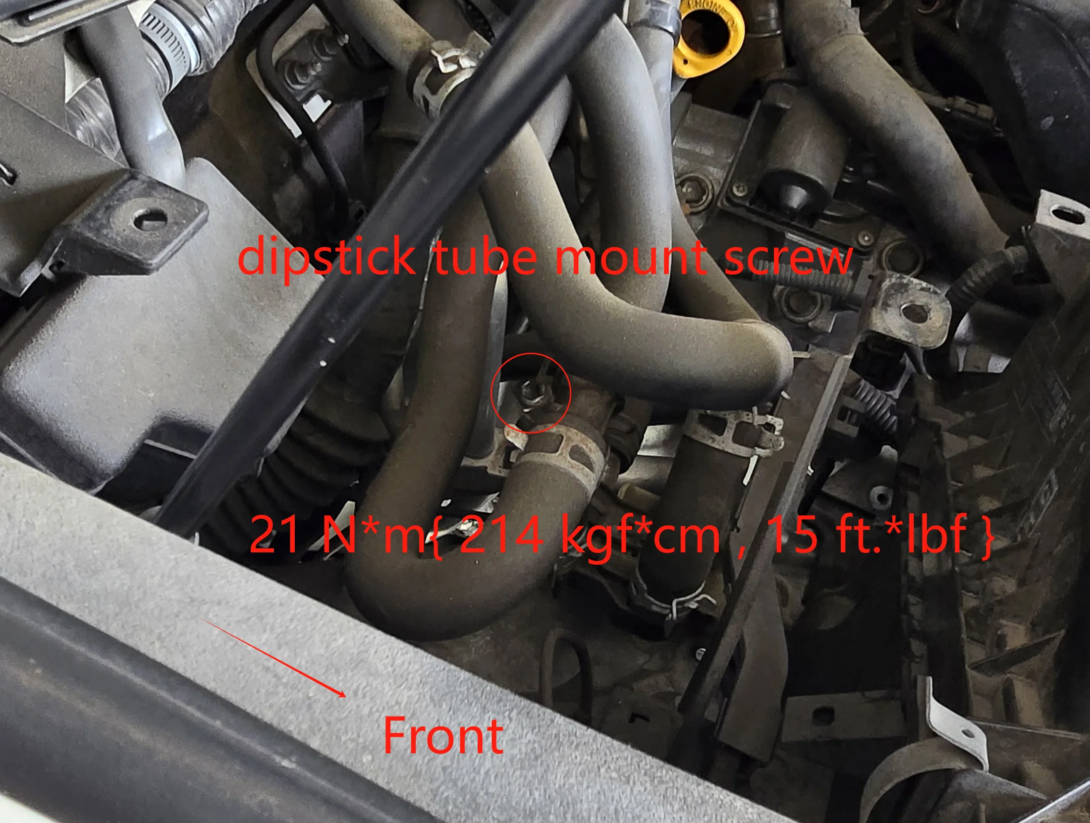

remove oil dipstick tube
remove HEAT INSULATOR

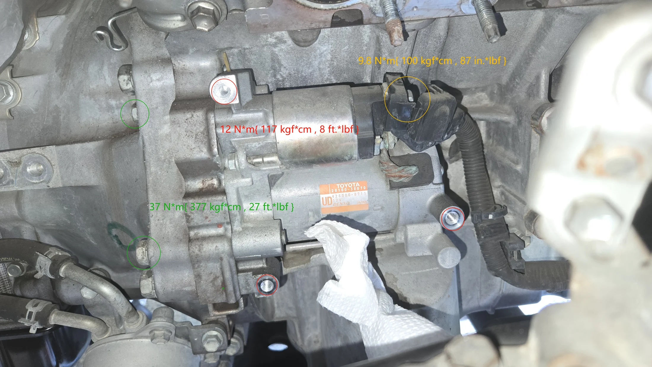

remove EXHAUST MANIFOLD discon sensor plug first
