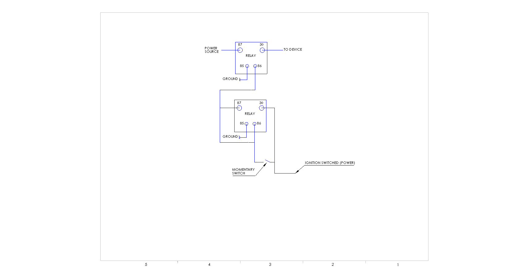

This was my solution. I could have used just a toggle switch but figured I'd get lazy and stop using it. This needs to be reset each time you start the car and goes open when you turn the car off.

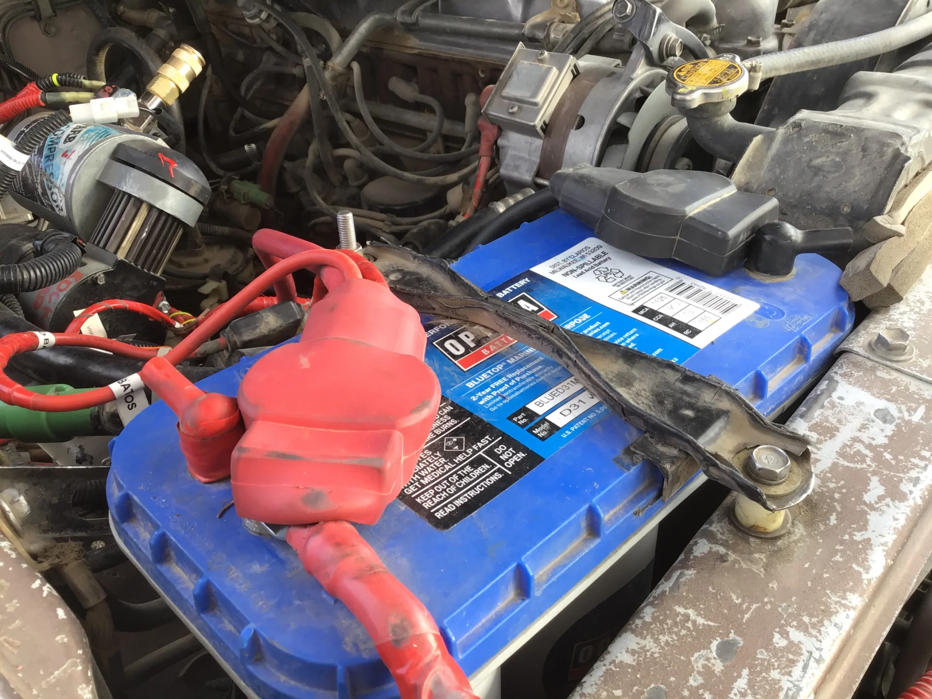

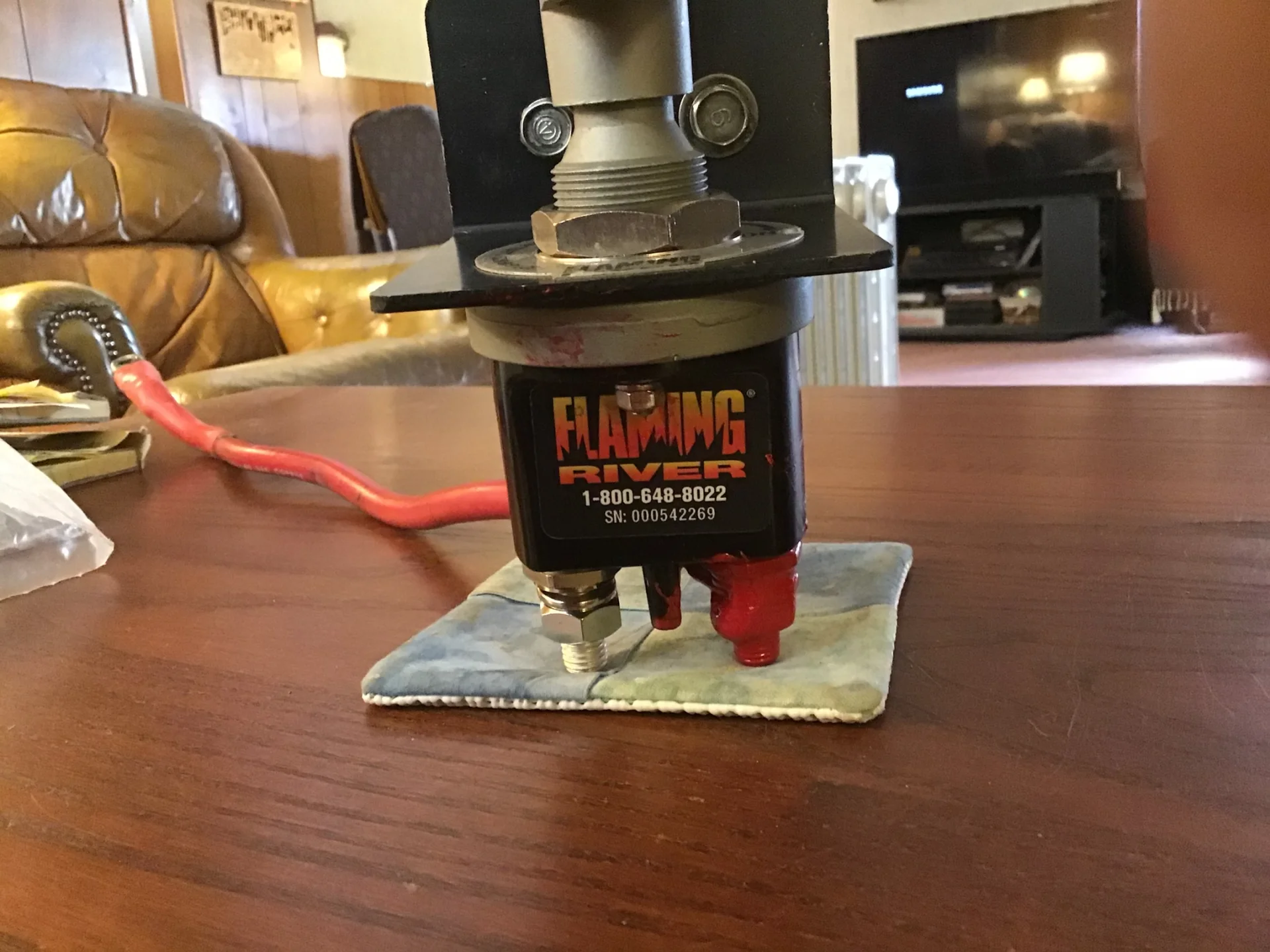

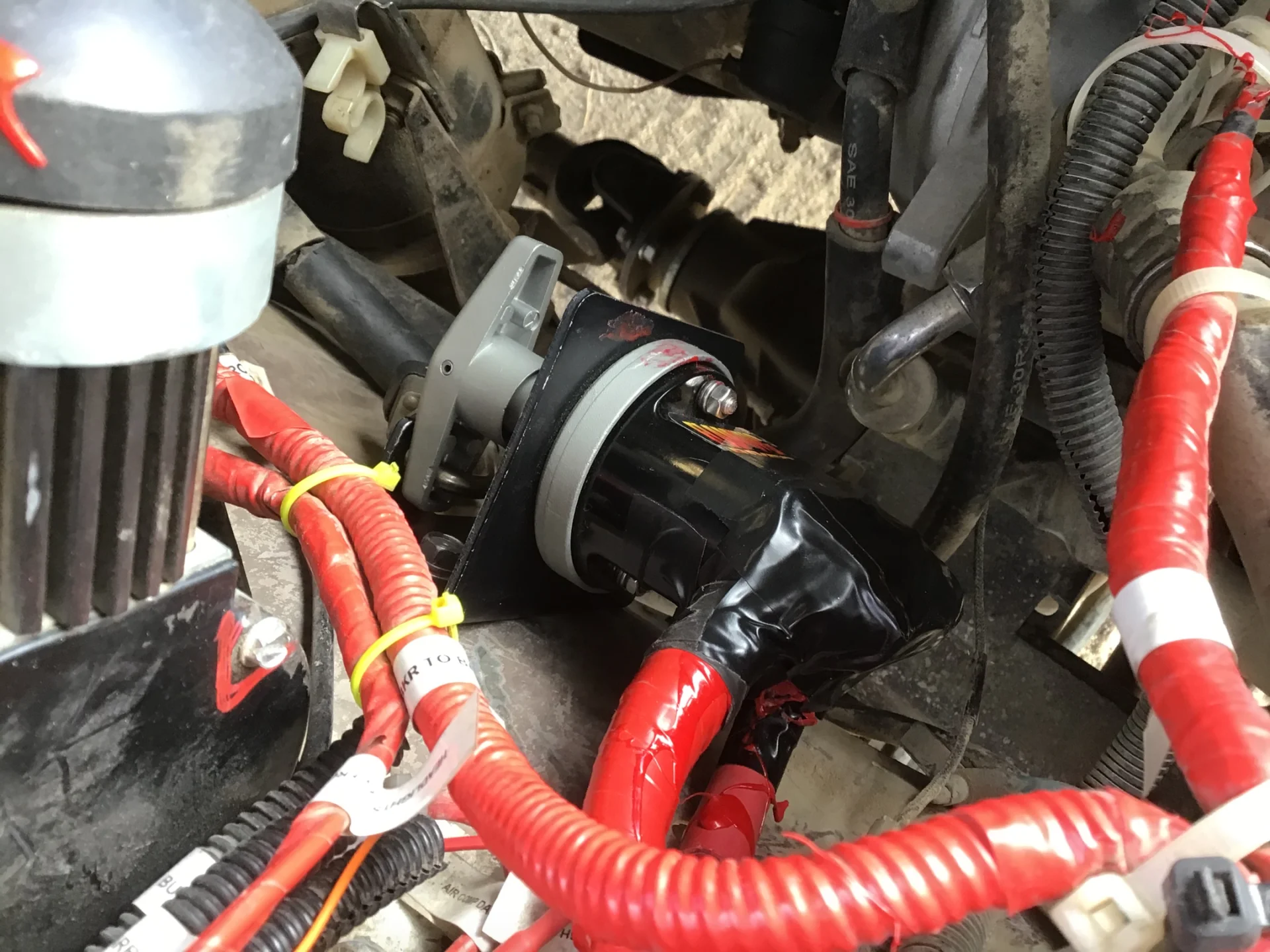

And here’s what I use on my 40 & my 60. FLAMING RIVER cut off switch that also uses a padlock for additional security.
It installs in the positive battery cable. After install, turn the handle & it disconnects the starter from the battery, with the padlock you get a bit more security.
