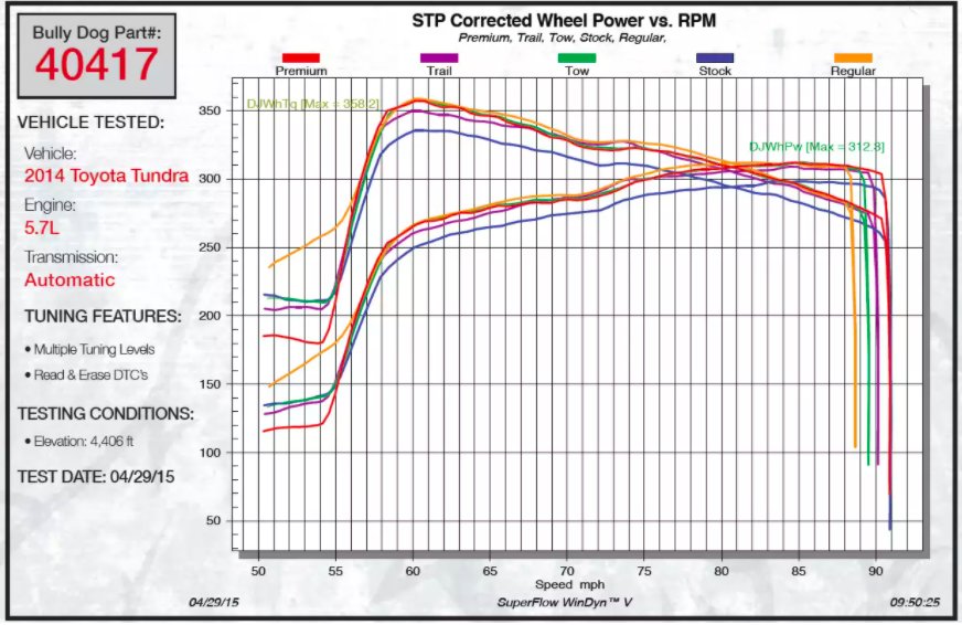

I don’t understand this power curve. Does anyone know the sweet spot for the 5.7 v8 torque curve? Like what’s the rpm to shoot for for being in final gear (.59 in the 6 speed I think) on the highway?
Think horsepower. HP is what does work at the end of the day, and what gets rigs and loads to the top of hills.
From that lens, the sweet spot for the 5.7L is 5600 RPM, although it's tractable everywhere.
It's because torque doesn't really mean anything without RPM when it comes to doing work. The two combined is the definition of HP.

310 HP at the wheels and at 4,400 ft elevation? Impressive for 381 at the crank at standard atmosphere.

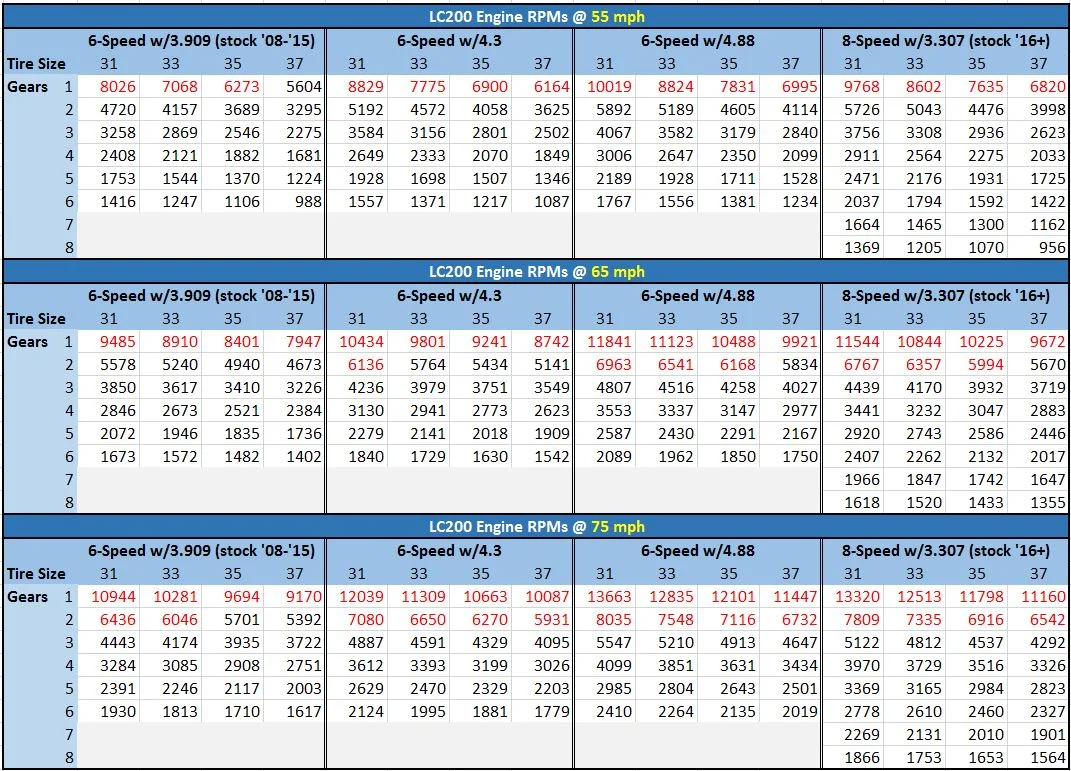

Looks like I didn't answer the right question. Reading again, final engine speed on the highway depends on overall gearing, tire size/rolling resistance, and loads in terms of aero, weight and/or towing. The dyno graph only shows how tractable and flexible the 5.7L is, but won't answer what engine speed you need.
The transmission ECU is going to try to lock-up if wheel torque required to hold speed is sufficient. If it needs a bit more torque, it will unlock the torque converter to get a slight gearing advantage along with a bit more engine RPM. If torque demand is still not met, it will downshift with more engine speed again. There isn't necessarily one single value to shoot for and will depend on your mods and power required to hold speed.
Looking at this chart, a point of reference for a stock vehicle at 75MPH will be 1930 rpm for the 6-speed and 1866 rpm for the 8-speed. So somewhere in that range is maybe your answer. You can see how tire size impacts that rpm not for the better, making it more likely to unlock/hunt. Pair that with more aero loads still, and using sport mode or a regear maybe the answer. I will say there's margin at those engine speeds to hold the gear with some minor load/grade.
As an upper data point and more extreme example, when I tow my 8k trailer with rounded corners on 37s, I need about 2600 rpm at 65mph for the transmission to stay locked in gear. There's margin in that too though and 2300 rpm maybe all I need if I had a gear to get to that engine speed.

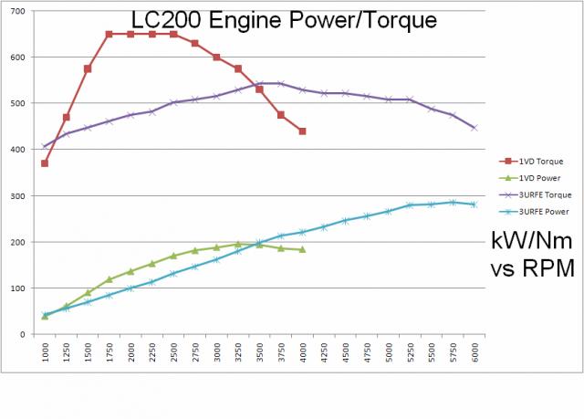

This chart is more representative of what the actual torque curve looks like vs that one in the first post. You will have to do the unit conversion from kW and Nm.
I think the chart from the OP was with a tune.
Yes but the chart is kinda dumb since it looks like they didnt even start the pull at a low enough RPM to be useful, and show it in MPH instead of RPM. We dont even know what gear they used. Looks like they didnt start the pull until >3500 rpm.
