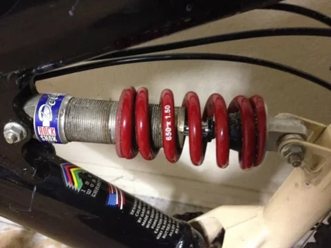

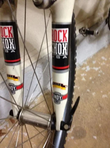

Back to the present time...my new horse just arrived and it needs a bit of work. The front and rear shocks feel a bit too spongy. It's been a while, but I don't remember my ride being that soft in the past...My body isn't used to riding this type of bike, but it just doesn't feel right - I'm assuming the shocks are old and shot.
The primary reason for this post is: What shocks would be best to replace these old worn out hogs with? It will probably only be used on light trails, nothing too extreme, but I want it to ride well. I just have been out if the mountain biking arena for too long and everything seems foreign to me now. All suggestions will be greatly appreciated.

Rear shock is a coil over, Rock Shox also. Prolly feels sloppy and soft to you coming from road. Can you post a pick of the top of the fork where the stem mounts with a tape or ruler to see the steer size?

Rear shock is like tag3 said. Just a coil over, so unless you can find a firmer spring, I would leave it alone. My neighbor with a Trek counterpart filled his (air shock) with some sort of epoxy to make it a hard tail. Maybe if it's too soft for your liking, you can get a steel rod in there. The front fork, the elastomers are probably long gone. You can order new ones here:
http://www.suspensionforkparts.net/...shox-indy-elastomer-refresh-kit-97-xc-sl.html
But you have to ask yourself if putting all this time and money into it is worth it. I would rather get an old school rigid MTB (Like a Trek 800, Spec Rockhopper, etc.), put some fat tires on it and just enjoy riding. I have a 93 Scott hardtail myself, that I replaced the Indy C fork with a rigid steel fork. I also replaced the old, hardened brake pads with some Kool Stops. Rides great. Good luck with the rebuild.

You could buy a newer fork but may have a hard time finding one that has an older style axle to crown length. Newer forks are longer in general which will affect the geometry of the bike poorly. Plus, any replacement fork will cost more than that bike is worth if that matters to you.
The rear shock: Y-bikes are bouncy by design. Can't avoid it. When this bike was made, air shocks were not yet the standard. It was not cost effective to equip most bikes with an air shock. Also at the time, coil shocks with pretty red springs were a selling point. Unfortunately for bikes like yours they just made a bad bike worse (no offense). They had no way to control "pedal bob" but they made the rear suspension feel smooth and active when you sat on it in the store. If you really wanted to fix it, I would search the internet for an old FOX Alps 4 or 5 rear shock with the correct eye to eye length and the same stroke as your coil shock. You would also need the correct d.u. bushings and spacers/mounting bolts.

I went to Turkey Mountain and pounded the Hell out of it today and it was surprisingly better than I had anticipated on the downhill parts, but this thing is a heavy pig. I did have a few close calls where I landed hard and the rear shock rebounded and nearly bounced me out if the saddle into an endo. The climbs sucked gigantic rhinoceros balls as the rear would bounce or compress causing me to lose all momentum.
I'm a bit sore, but overall, I had a blast getting out and riding dirty, but I'm going kick nostalgia right square in the balls and look for another ride. I think that I'm hooked in trail riding now and it's probably best to leave the old days behind in this case...

That just means your rear shock is bad, don't let it turn you away from a new full suspension bike.
