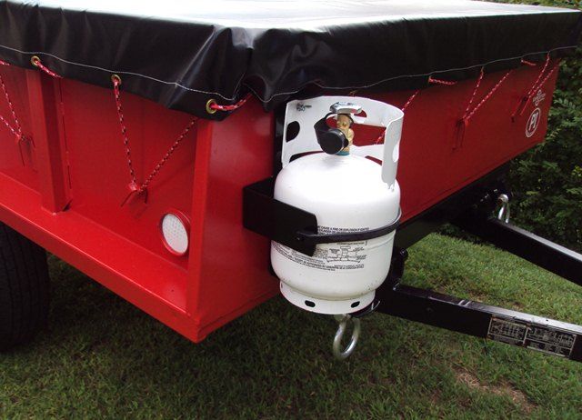

I fabed a propane tank hanger at work to hold the 10pound tank for the hot water and cooking needs.

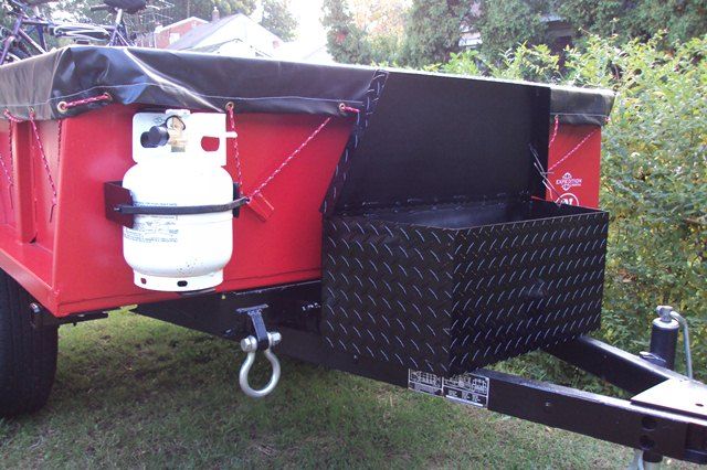

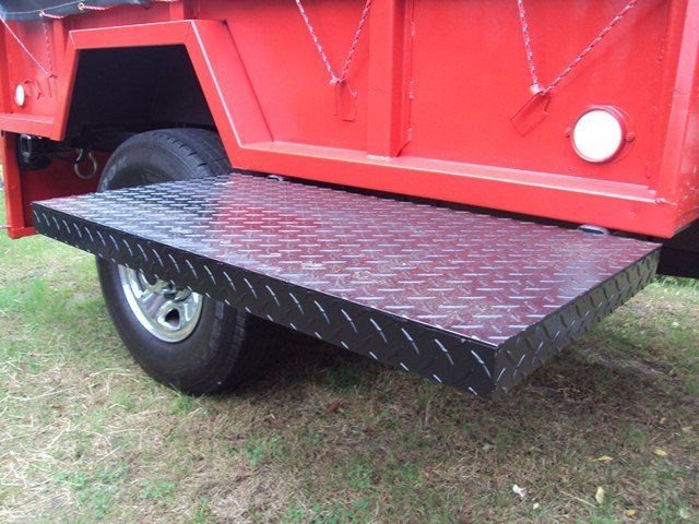

I got some free used aluminum diamond plate and welded up a table cook top for my Griswald burner.
It can be switched out for a webber grill when burgers and dogs are on the menue.

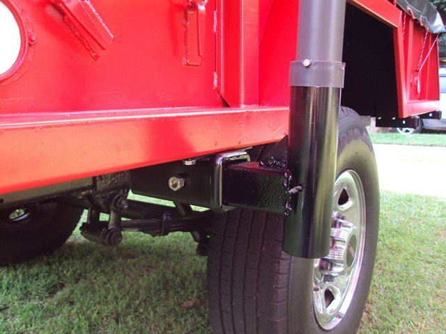

I added several reciever tubes for an umbrella mount and to hold a cook top.
They are welded to a plate and bolted to the tub. I made a diamond plate counter and fabed up an umbrella holder. I plan on adding mounts for poles that hold a canopy and rack for a RTT soon.
