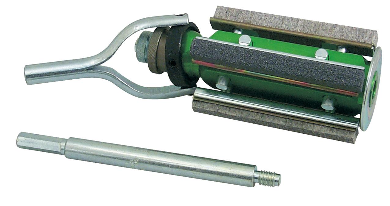

What hone are you using? Ball hones will take off the glaze, but can't really correct any damage.
What you want ideally is a rigid hone with finishing stones and guide shoes. A nice Sunnen manual hone is a hell of a nice tool, but there are cheap home shop grade knockoffs that work OK made by Ammco and Lisle for engine cylinders as well. I use manual hones extensively for hydraulic cylinder repairs. I have a couple of the Ammco ones I'll use for real nasty stuff I won't touch with a nice hone. They work fine. They're just crude compared to a Sunnen.

Thanks, that’s the style of hone I was looking at years ago! Forgot all about it!It's pretty important that you hone each cylinder exactly the same with the same tool.
Those spring loaded finger hone things are pretty terrible.

The lisle 15000 looks like a cheap version of a Sunnen AN110. It looks like a fair deal new if I read the description correctly and it includes 80 and 180 grit stones. 80 is handy for roughing. You will want to use a 180-220 grit stone to take out a thou or two from your bores.
The Ammco model 500 is no longer made seems, but they are everywhere used.
Honing fluid is a subject you can get lost in as well. Make sure whatever tool you use, you also put some effort into the right fluid. You can cook up your own, but real honing fluid is night and day over anything else.
