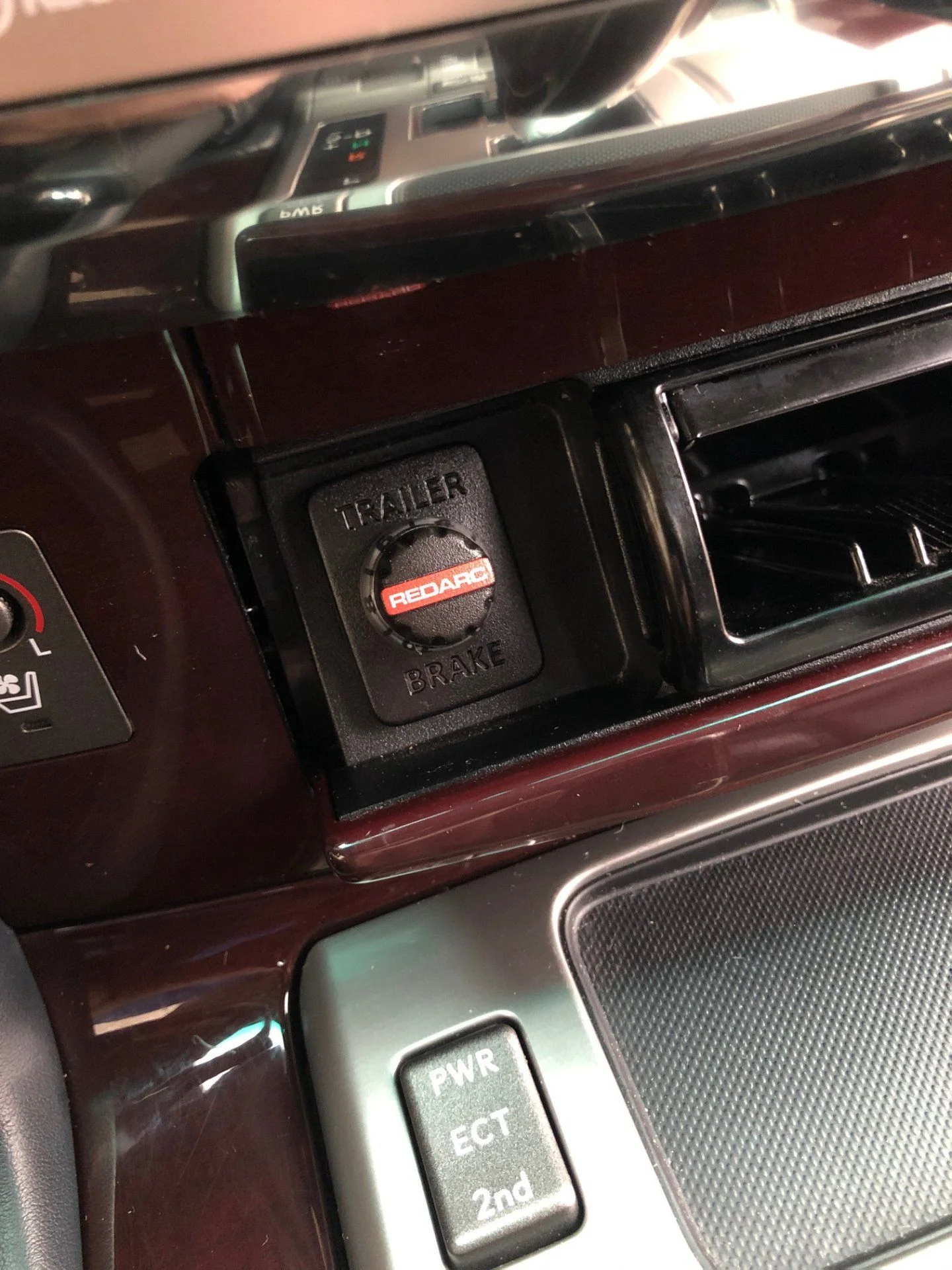

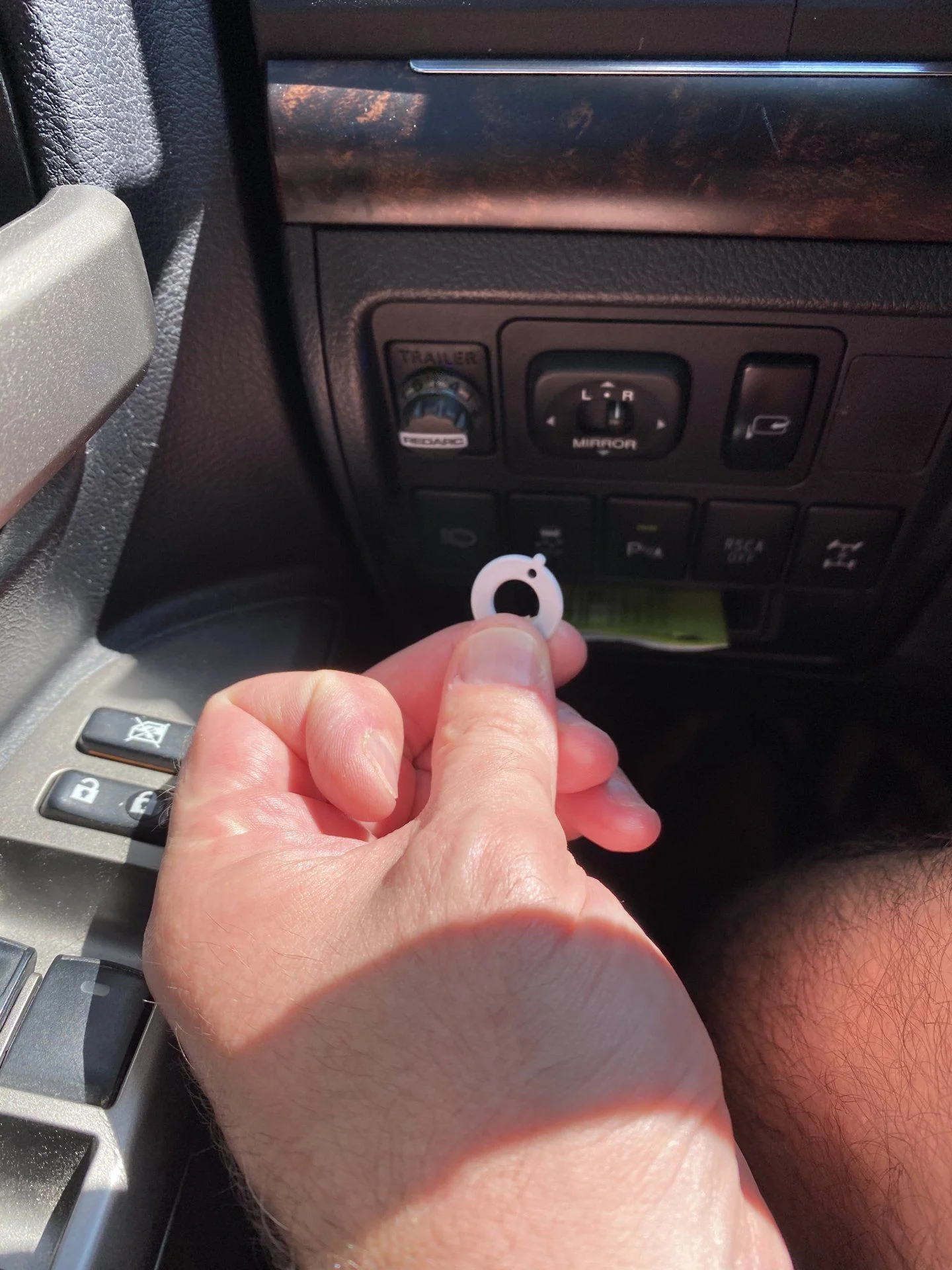

All, probably a stupid question, but when is the supplied gray washer/spacer used on our 200s using available blanks and adapter? I assume it is for spacing to achieve desired clearance and allow the button to be pushed etc. but half of you guys use it, half do not. What’s the consensus? (My hyper accurate* search of posted photos led me to this bold claim!)
fwiw I installed it initially but felt the button press wasn’t as ‘crisp’ and felt it was creating interference, so photo shown is as installed currently. Am I crazy for this method?!?
Don't know what the consensus will be, but I used it. I do remember that I need to make the hole for the small pin a little bigger, in it or the switch blank, with a drill bit when I did my install.
As @CharlieS suggested, I emailed @Brucey from RedArc and got my answer! For those using the switch blank insert (and not directly mounted to another panel) you do NOT want to use the grey spacer / washer.
I’m attaching the installation pdf (see step 3) provided by Mark and team @RedArc - great customer service for such a fast reply btw!
(note - I don’t mean to imply if skipping the switch blank install location that you “must” use the grey washer / spacer but am only confirming it is not needed in the switch blank with adapter)

Kevin, just FYI, I also did NOT use that washer though it confused me as well. I came to the same conclusion as you did as I did a similar install.
Great work Kevin, thank you! Cheers...

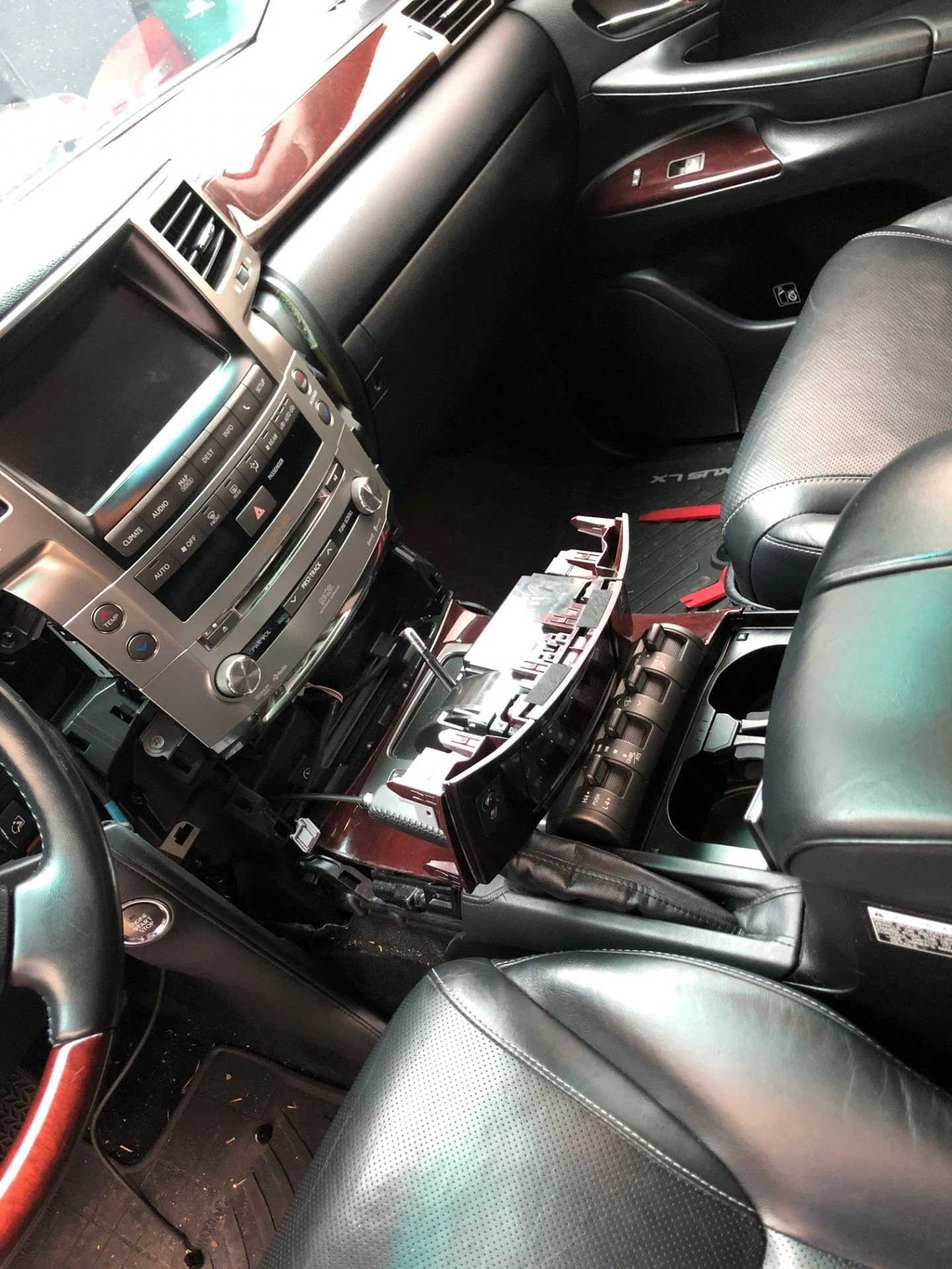

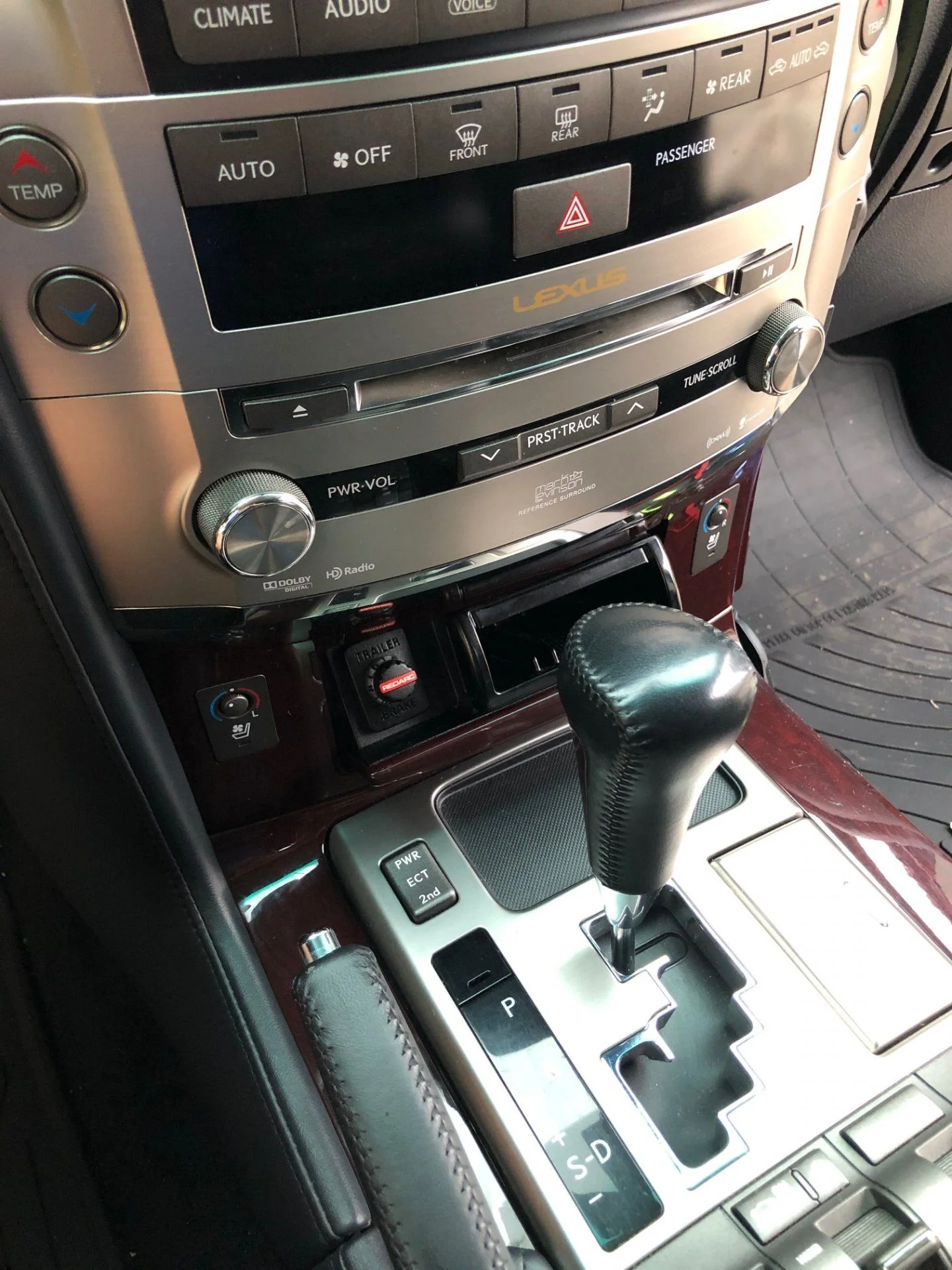

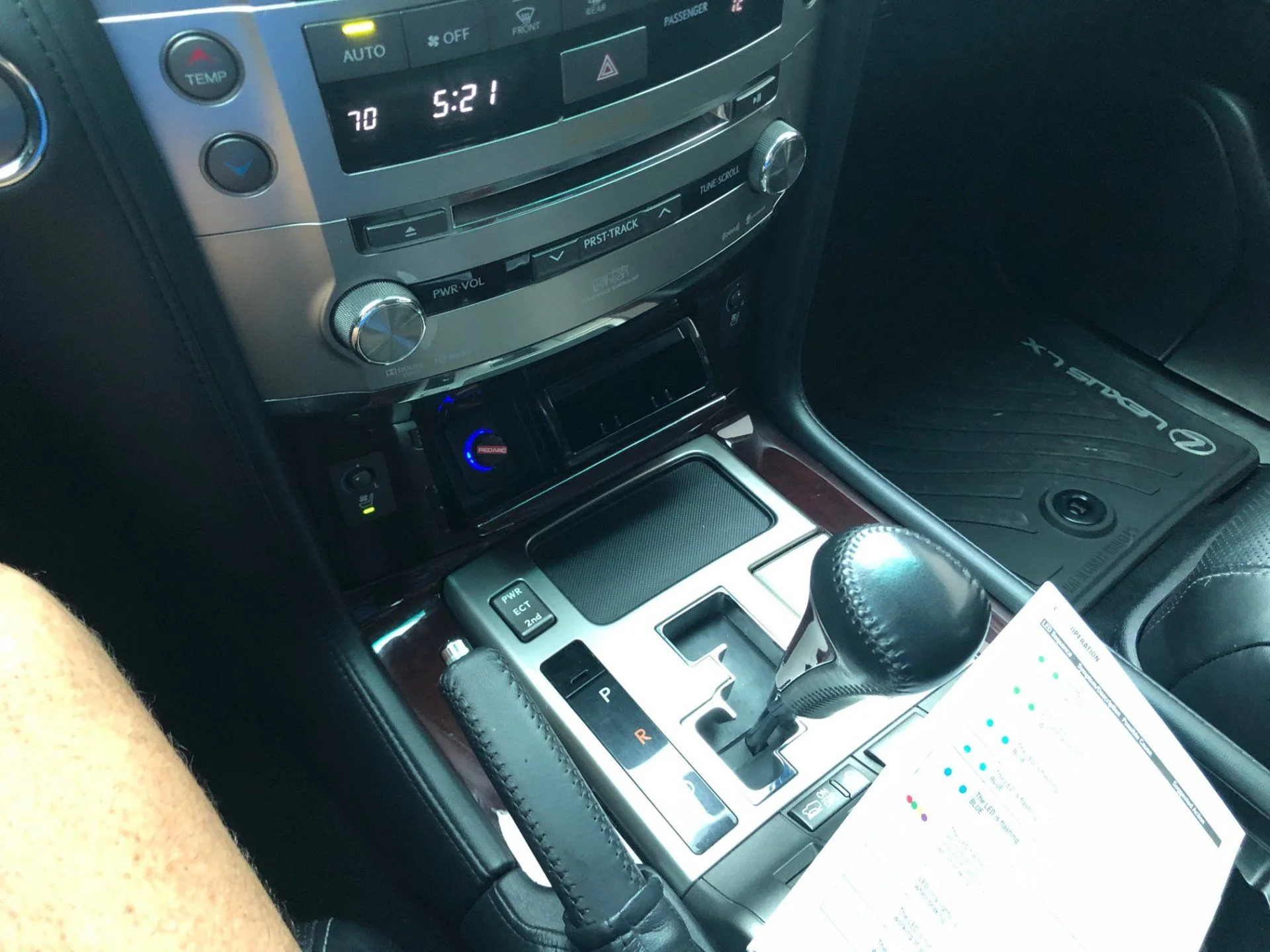

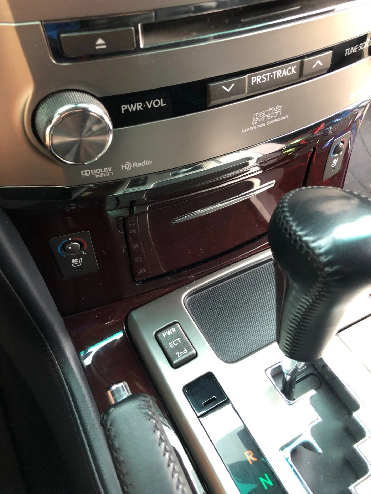

An alternative I have not seen suggested...this is where I put mine (LX570). Easy to see. Easy to reach. Hidden when not in use. And I never use the cigarette lighter.
Thanks! Inaugural tow. Did great. The Redarc was making me a little nervous in that it calibrated for a long time...but then worked perfectly.
