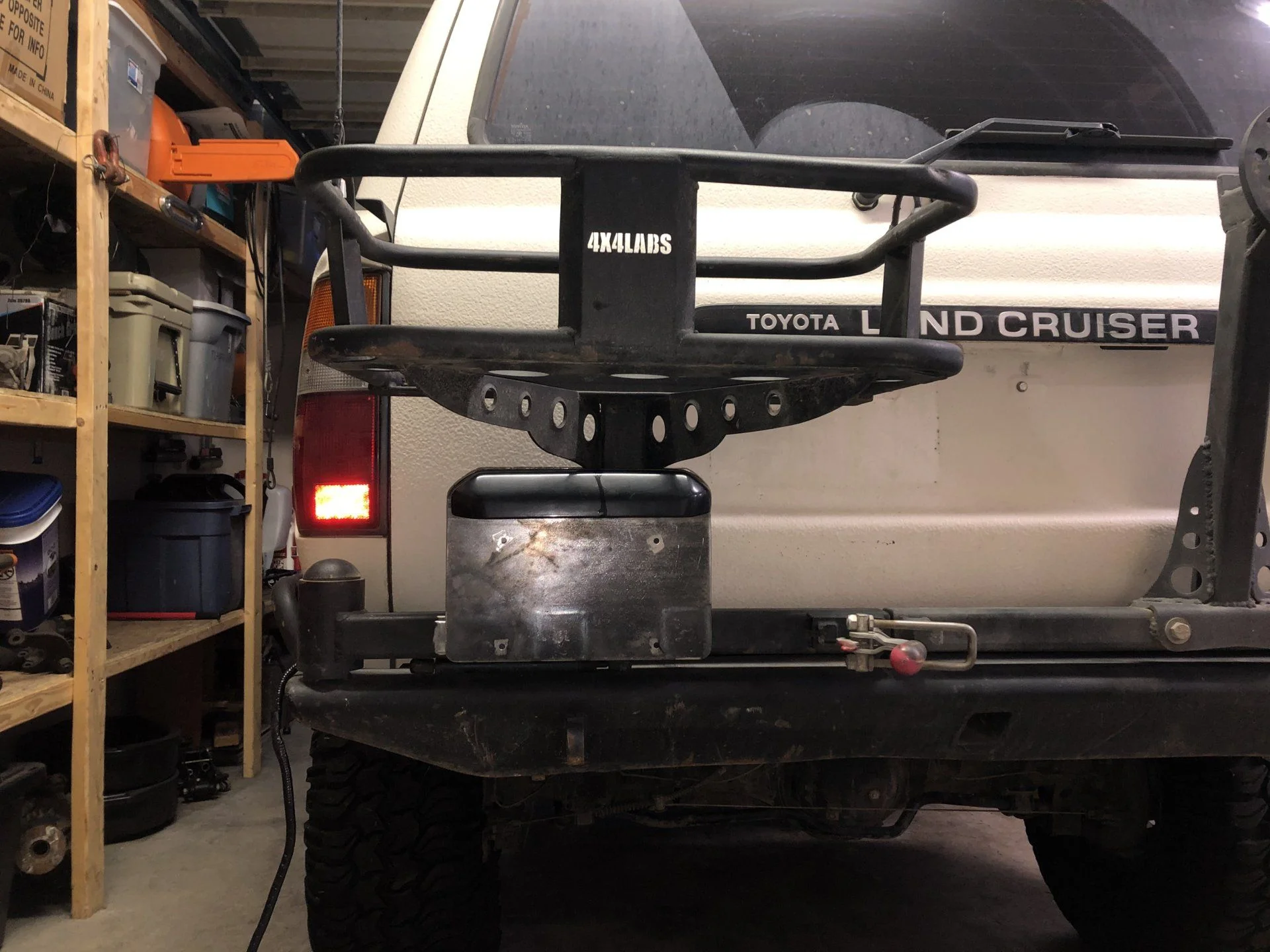

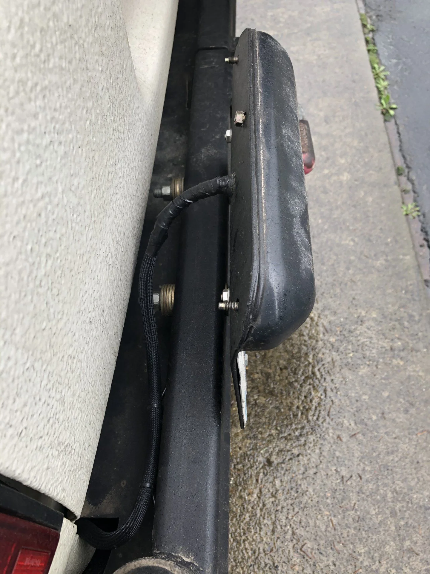

I was politely asked by local law enforcement to relocate my license plate because the spare tire was partially blocking the last digit even though I had moved it left and retained it with only one bolt 3 years ago and had no complaints thus far.
This is what I came with. I wanted it to work with or without the 4x4 labs cargo basket and be lit up at night. So, I moved the stock light to my plate holder and used the wire harness from a spare tail gate as an extension.

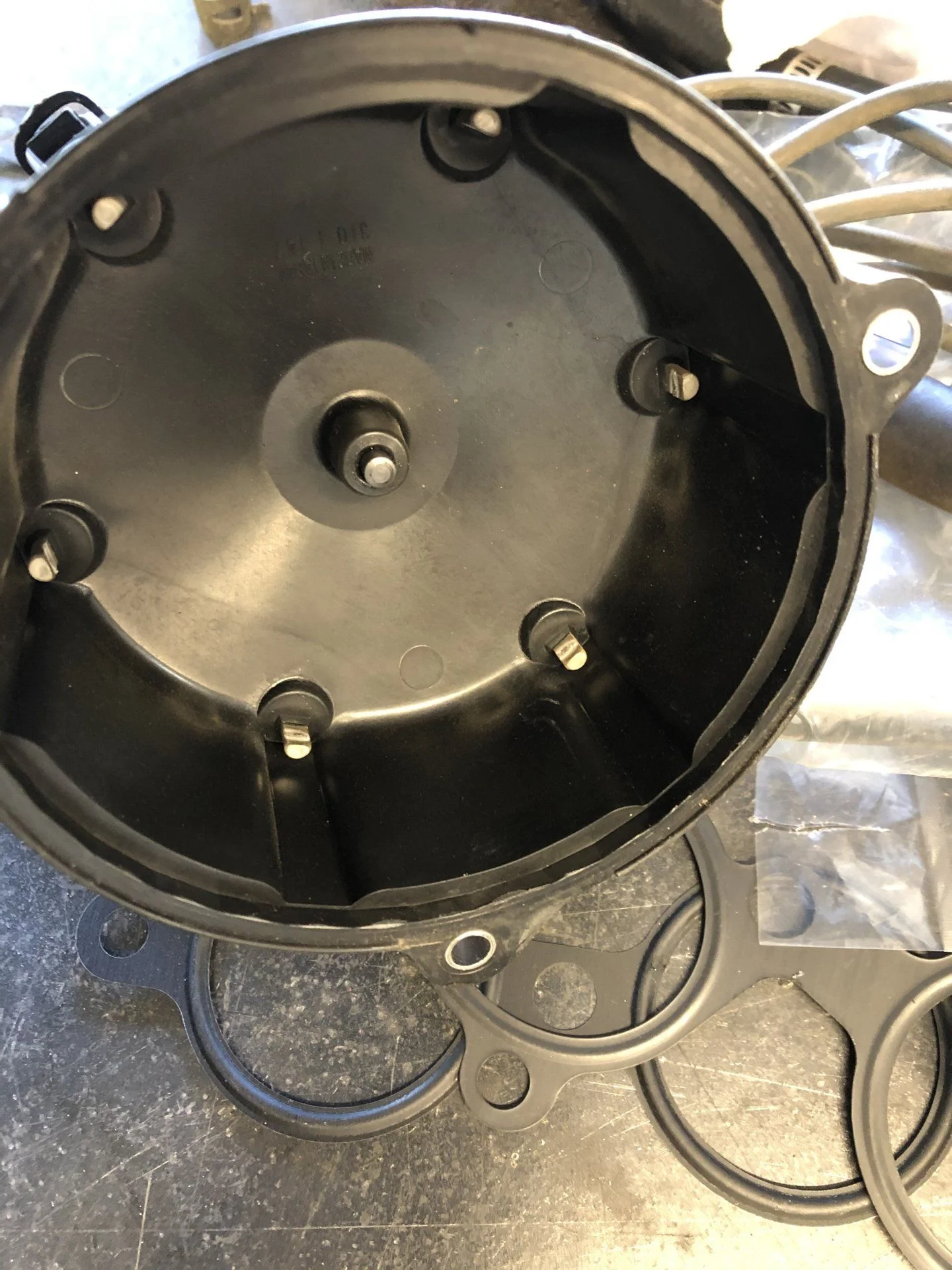

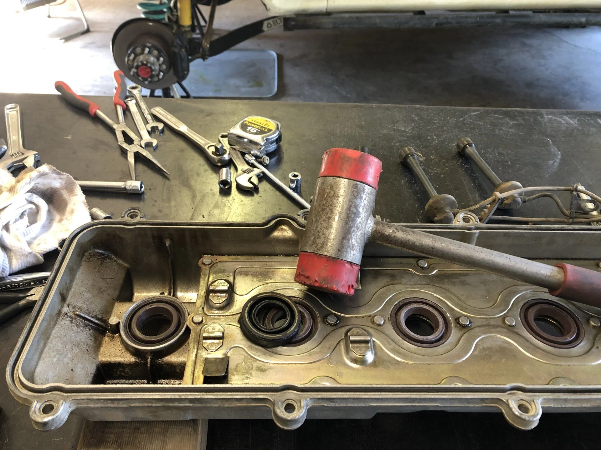

Apparently Bosch makes good stuff. These parts were on the engine when I bought it. I have Toyota stuff on my spare engine that has maybe 5k miles on them. I guess I will put the oem parts on as I go back together with this. Kinda wondering why because she has been running super well ...
An old seal and dead blow hammer works well to drive the new seals home.

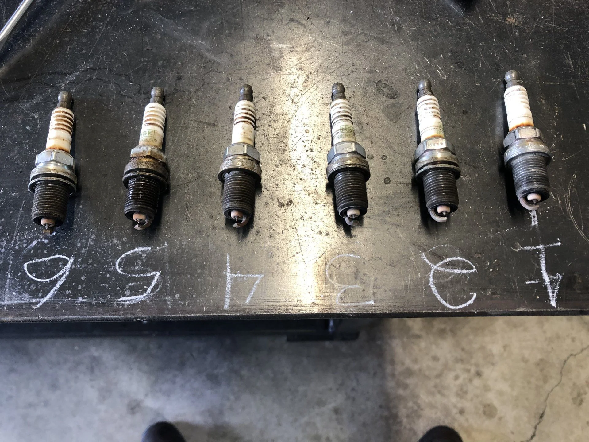

I may be repeating myself here; I bought this1993 80 series a touch over 4 years and 35k miles ago. It runs so well that I have not bothered to replace the spark plugs and wires with the oem stuff that’s on the engine that I yanked from the green machine after I rolled it. I removed the TB to have better access to replace the water bypass hoses and one thing has led to another and I’ve decided to go ahead and swap out these tune up parts while I’m in there. Anyway, the spark plugs look better than I would expect for being run in an engine with a touch over 300k miles on it.
