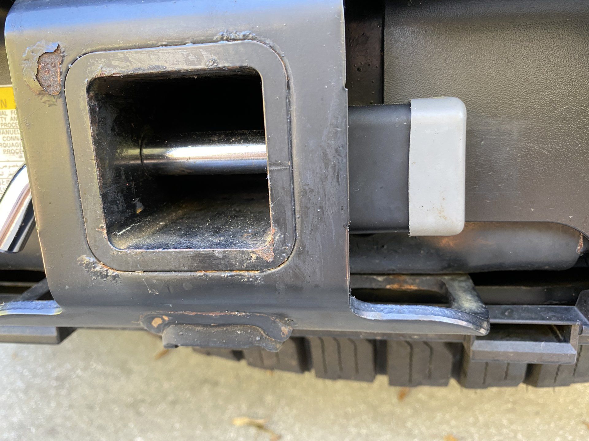

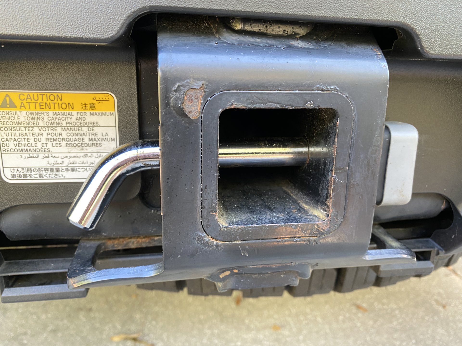

Has anyone experienced “premature” rust on their hitch receiver? My LC is less than a year old, never driven on salted roads, yet I’ve already got several rust spots on the receiver.
Pretty normal. I put a brand new Lexus oem pintle hitch on our GX470 and same thing happened. The paint flakes and damages easily. You can spray with Rust-Oleum but it will come off where the hitch rubs. It is just surface rust.
For sure on my '17. Yuck. I've had the best luck with Rustoleum Rust Reformer, but anywhere the chains, etc. rub paint will come off and rust again. Too bad they didn't put a better finish on the hitch.
Thanks for the replies. Anyone try to get their dealer to replace the receiver under warranty? Since I love to mess with my dealer (they actually treat me very well), I may try.
The receiver is a part of the frame and can't be replaced independently (at least on my '13). You'd have to cut it off and weld a new one on.

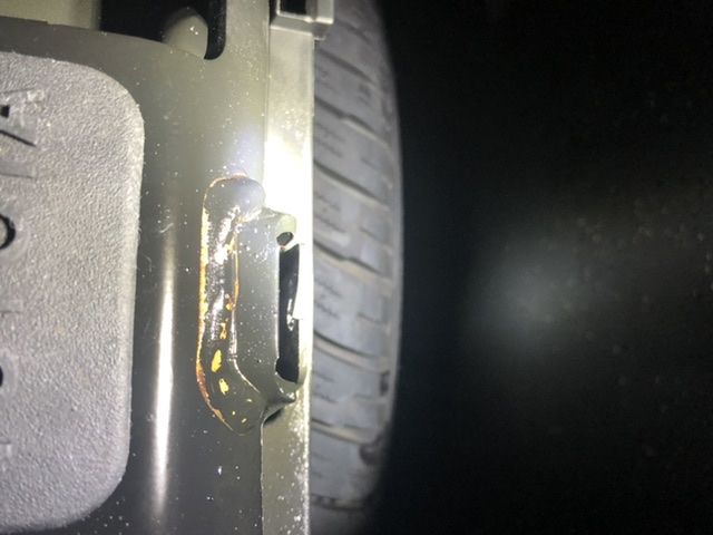

I do use my receiver/hitch. The rust really doesn’t seem to be from scratches...the face of the receiver and the rear part of the safety chain loops are the worst, and those are “no contact” areas when inserting the hitch or when using the safety chains. The front of the safety chain loops where the chains hang is fine...the rear is rusting. It makes no sense.

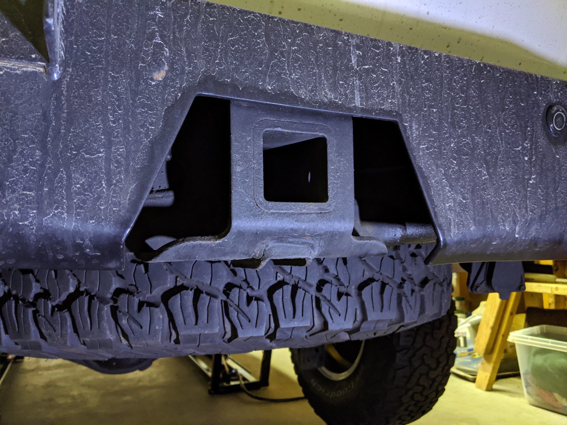

Here ya go, 5 years and ~72K miles in salty New England. Not a spec of rust, NONE. (please pardon the dirt, truck needs a bath) I have not painted it, that is the factory paint.
