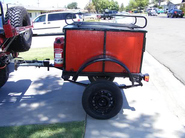

I was tired of hearing about how my campingtrailer was always getting in the way (from the wife) so I sold it to a local club member. The next day, we were driving back fro a local Indian Casino (after winning 250 smackers, I saw a little trailer that was covered in weeds, flat tires, weather beaten sides, and a for sale sign. I mentioned that that would be a great place to start a trailer build when I decide get one (after I put a side yard in) and the wife was feeling bad about nagging me to sell my old trailer so her is what I turned my new purchase into.
I put on heep springs with FJ40 spring mounts, flipped the axle, gave it a paint job, put a roof on it, and welded on my roof rack. It looks funky with the small tires, but I am going to get a 6 lug trailer axle for it to run my extra set of FJ40 tires on (I have a set of 37s for hard wheeling and 35s for light trail duty).
I welded on side brackets for my fishing poles (in white PVC plumbing pipes with screw on ends) and shoves, rakes, and camping/recovery gear. I plan on building an external box off the back door that will carry my camp stove/fuel/cooking utensils and fold flat into a cooking table. I also wired on some side lights that are wired through the electrical connection. I may also build a type of rack that will hold my Tule roof top carry all if I need more room besides the roof rack. It should be just about right for enough gear for 2 people and a dog or two for at least a week while leaving room in the Cruiser for breathing.
I will either buy an axle kit from some place like Northern Tool and simply bolt it in, or if anyone knows where I can get wheel adapters for a 4 bolt to 6 on 5 and a half I'll just get a pair.
Anyone know a place where I can get that type of adapter or is that going to be a special order? It is kinda strange to go form a 4 lug to 6 lug wheel. Suggestions or would it be cheaper to get a 6 lug kit?
