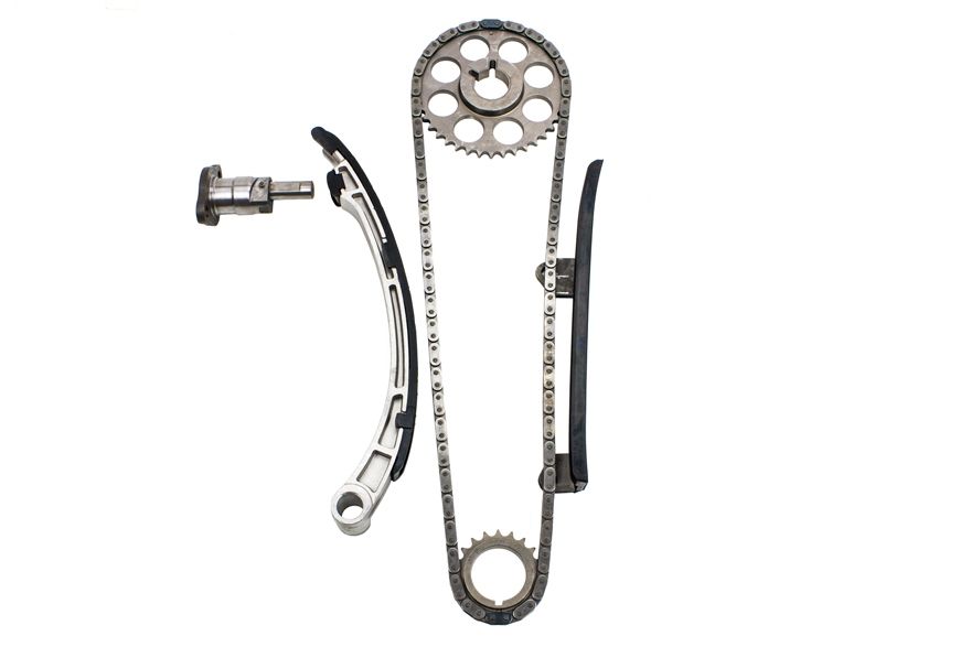

Tensioner, slipper or damper could be issues, but you've got relatively low mileage for that.

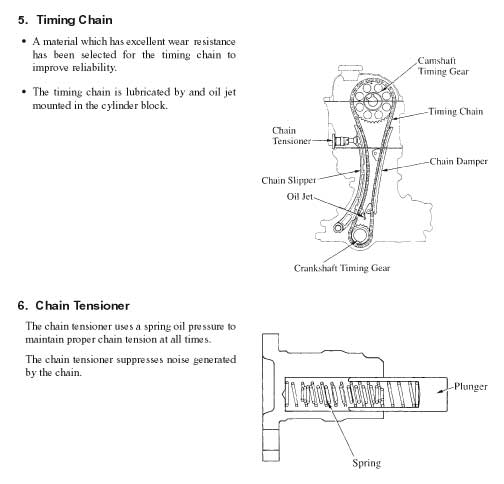

Sounds like you are describing 'start up rattle', nothing to really worry about. The tensioner is a Spring/Hydraulic design...so it might be that engine oil is taking a bit to circulate and the parts are also warming up. The chain is lubricated by an oil jet.
