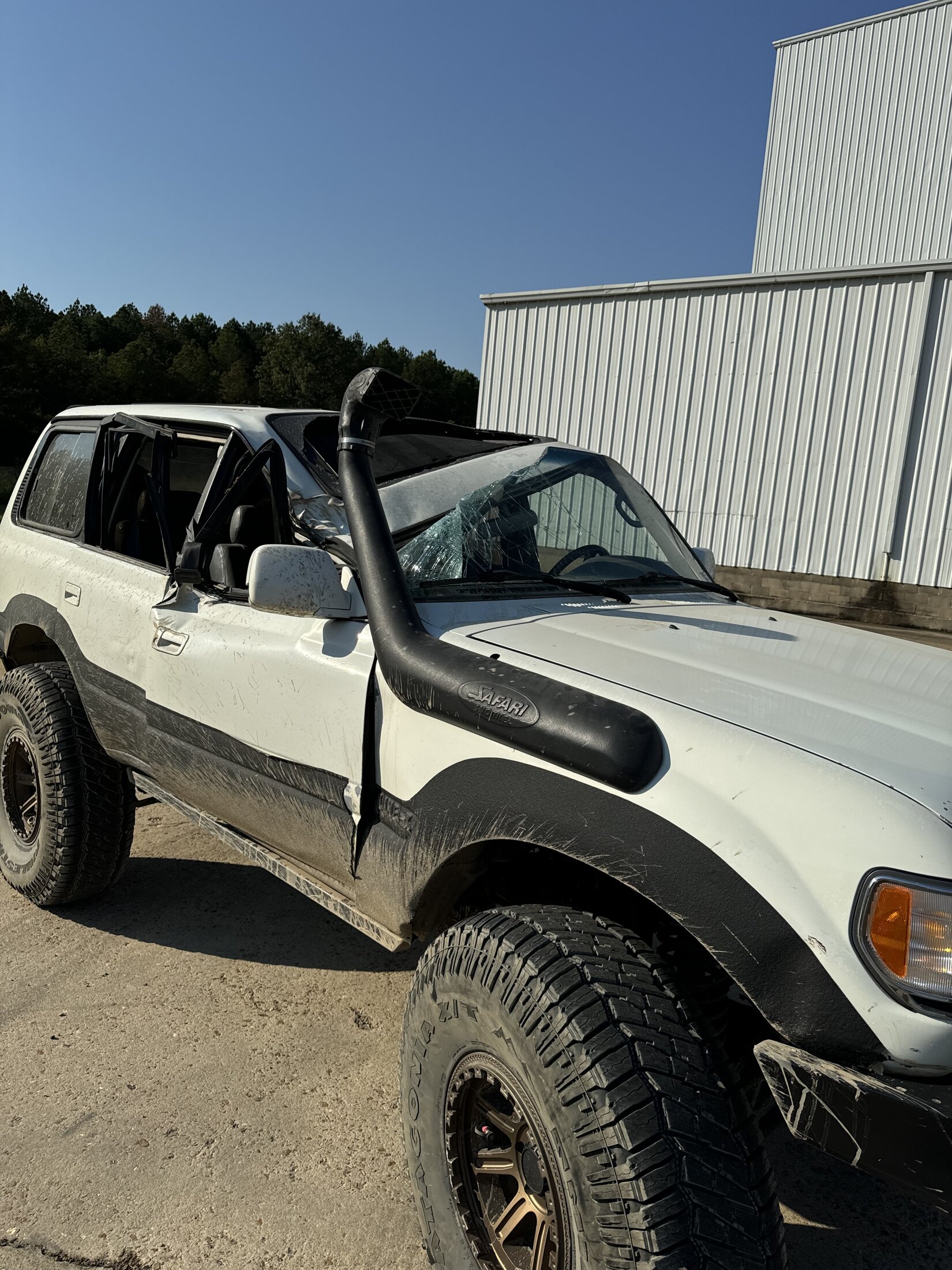

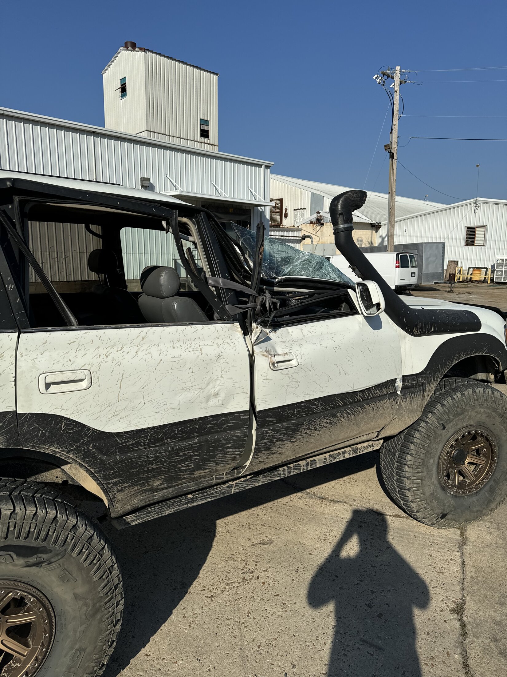

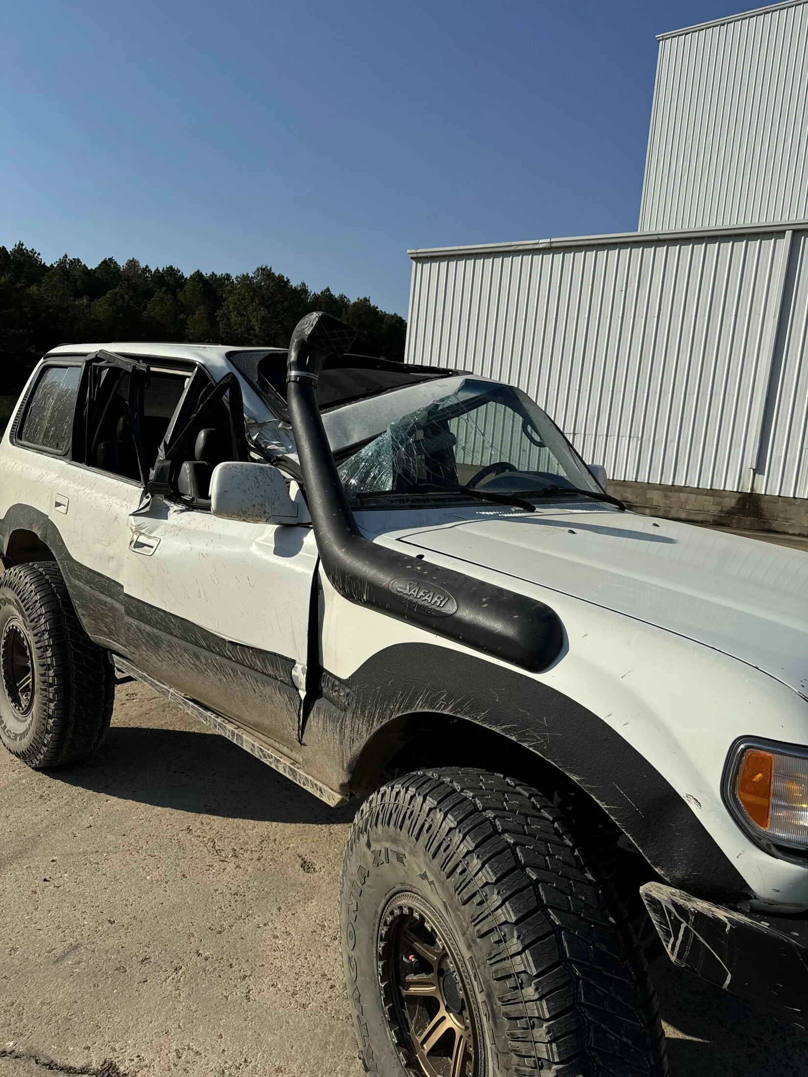

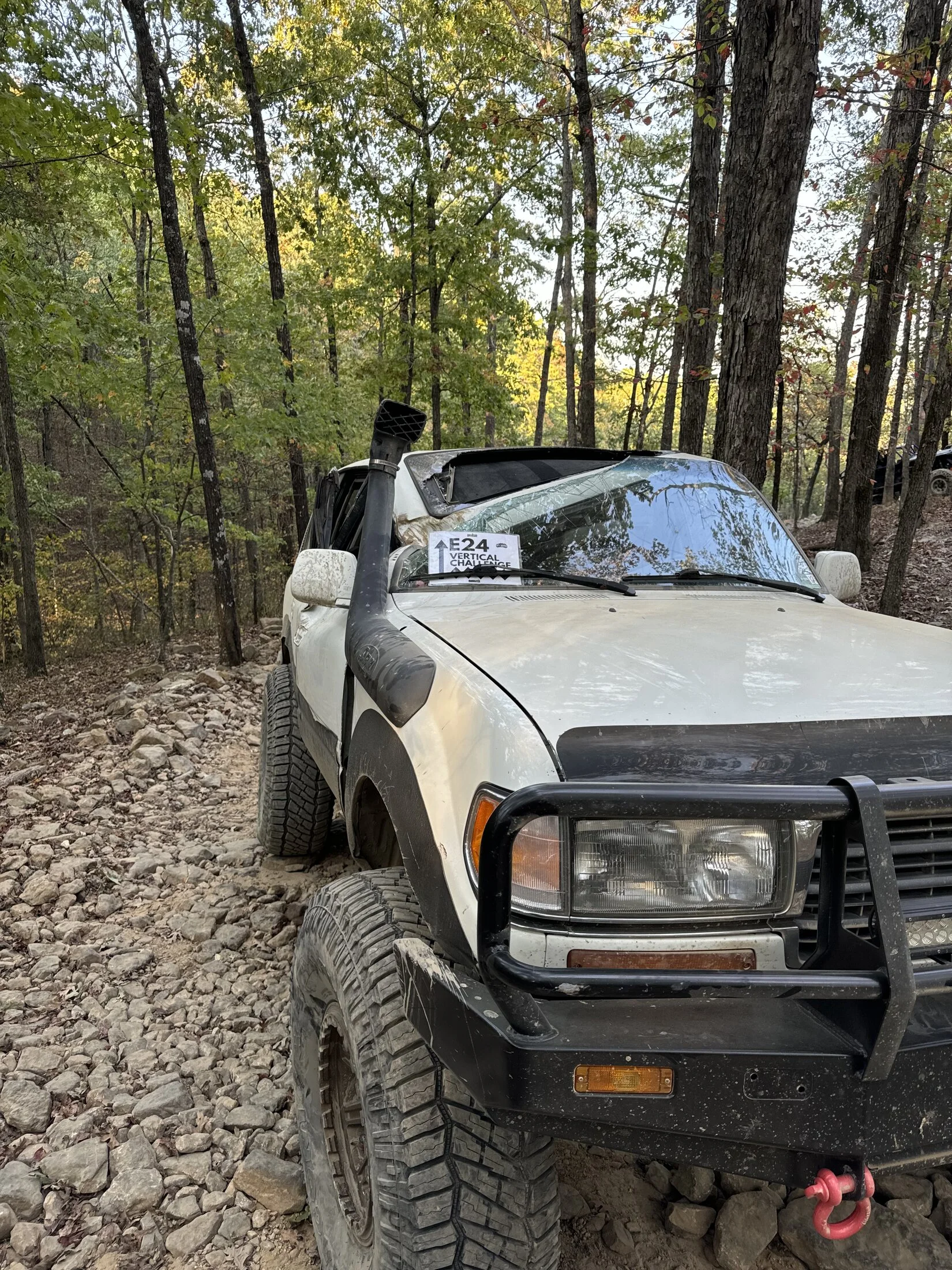

Ran out of talent at the Southern Cruiser Crawl this past October and the 80 took a bad hit with a tree and suffered serious damage. My wife and all 4 kids were in the truck when it happened and luckily aside from my wife having a hurt back and me a swollen ankle all of the kids were injury free. It could have been a lot worse. It’s days on the rocks are over and once the rebuild is complete it’s time for me to add a buggy to the fleet.

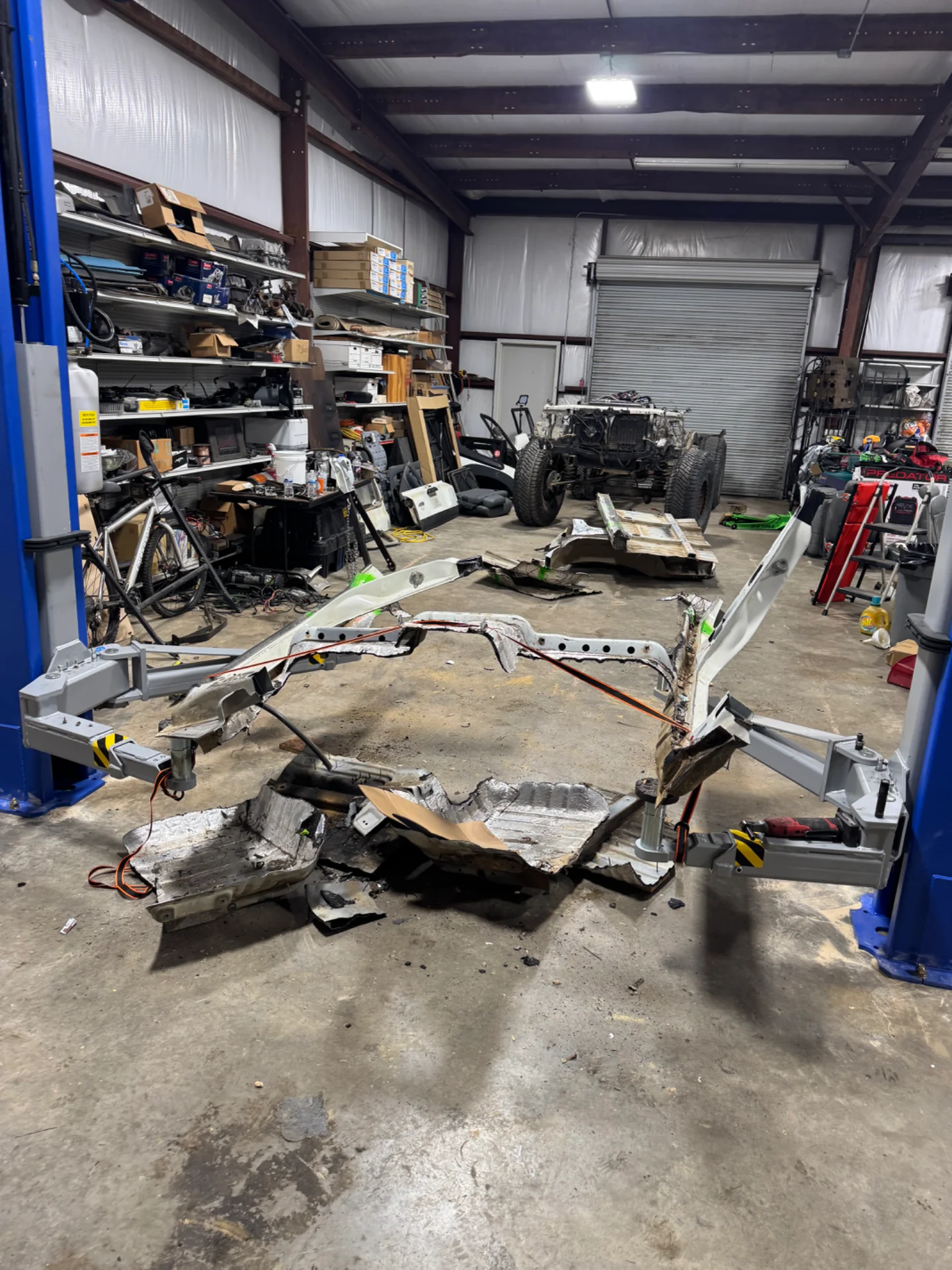

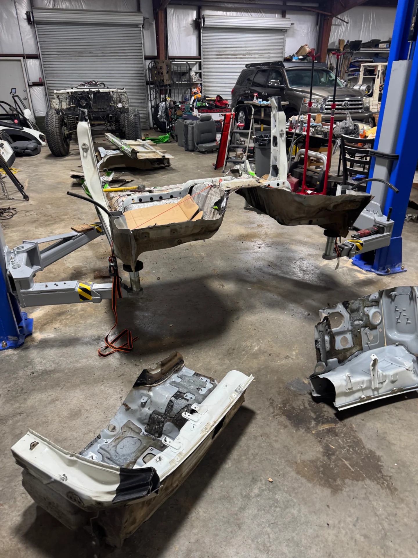

Then stripped the rest of the body of salvageable parts to add to my stash.

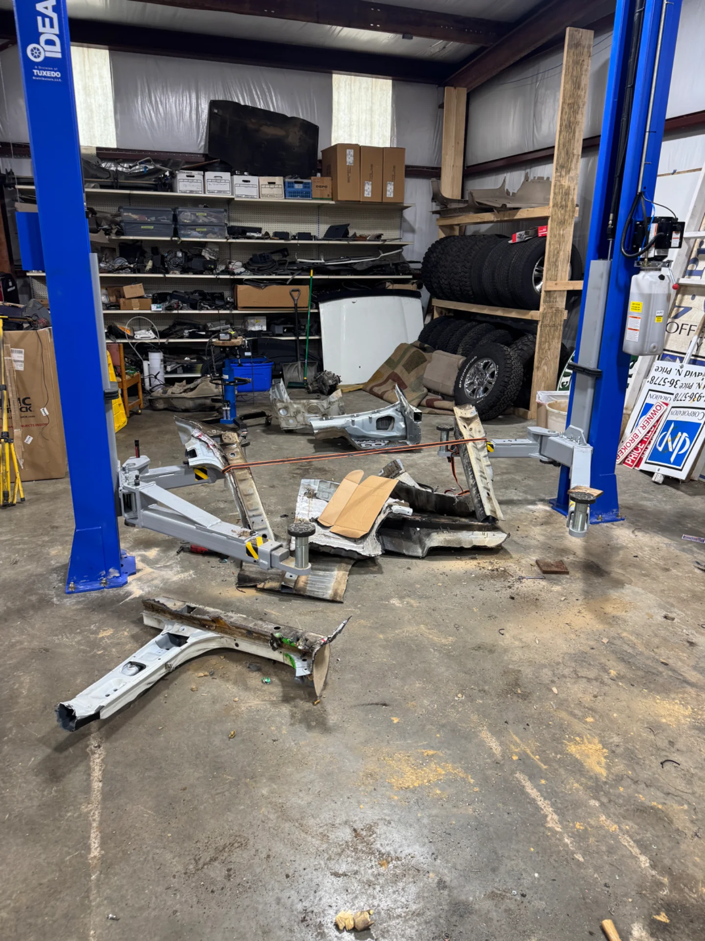

Decided to go ahead and cut the roof off to make dash removal easier to manage solo.
At 10 pm this is what remained and I called it a night.

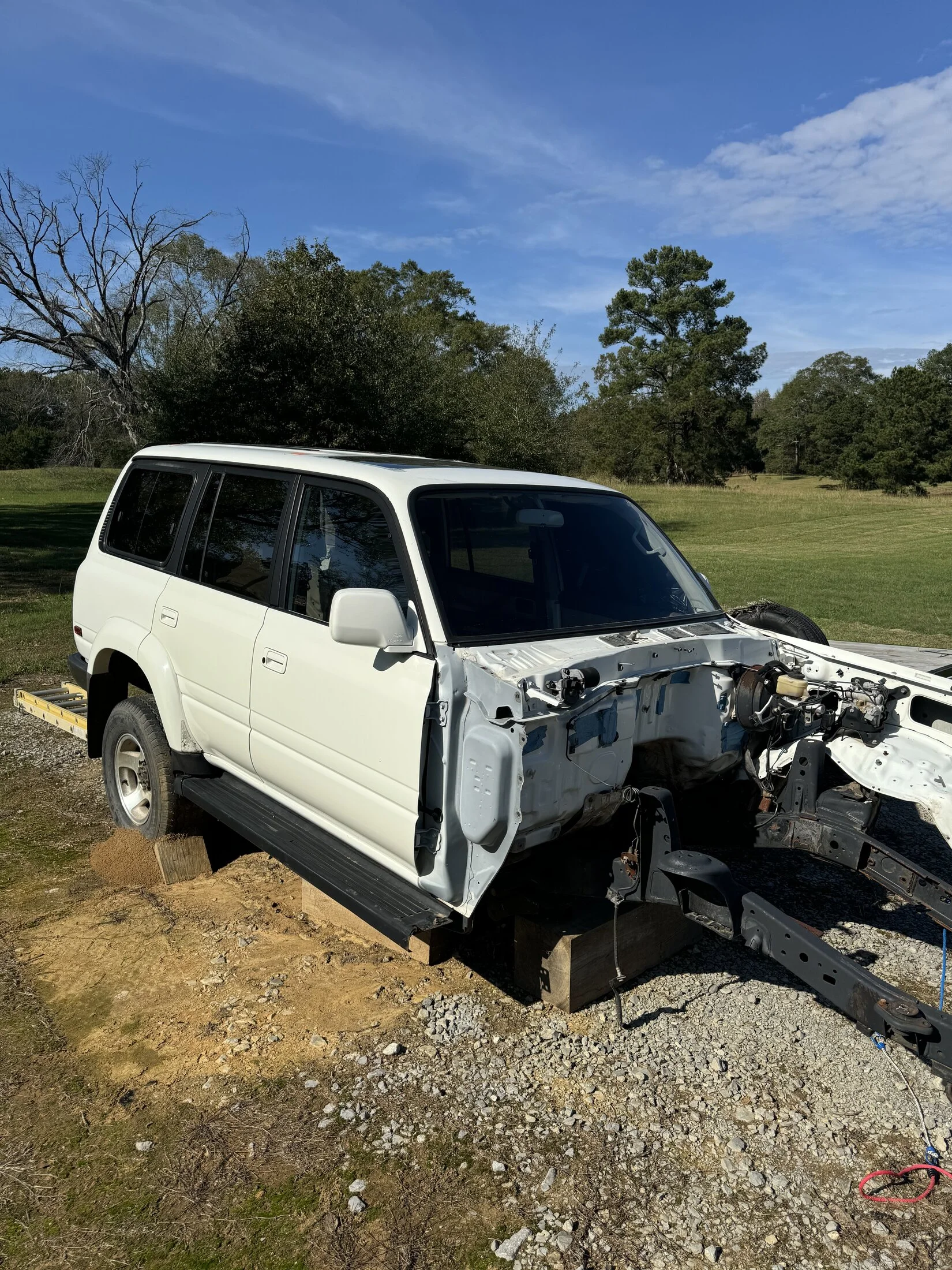

Being that my donor body was stripped completely bare due to a diesel swap gone rogue where they were trying to install a Ram 2500 dash into an 80, May 22 was spent stripping down to bare firewall and drilling spotwelds for various brackets that were hacked off. Also starting removing body bolts.
Started May 23 getting the donor body staged for the rollback to come pick it up out of the driveway.
Then I was able to finally lift what was left of the old body off the frame.

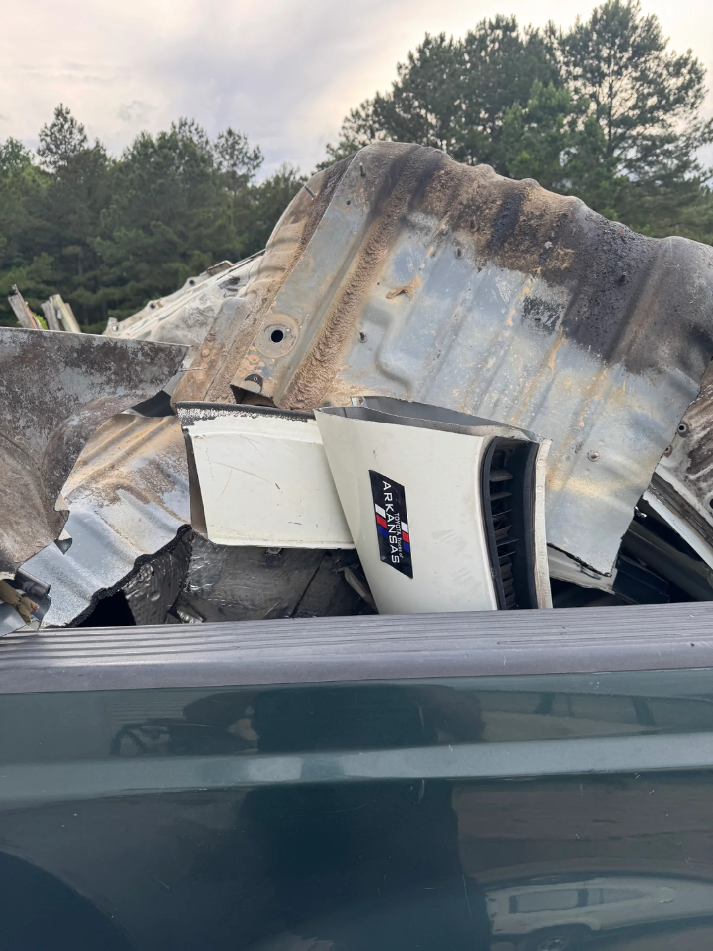

Spent the next hour or so cutting the old body up and loading it in the bed of an f250.
Now that the old body out of the way it was time to clean up the chassis.
Wanted to get the donor body staged for removal from the chopped up frame the following morning. It actually rolls pretty good with a floor jack under the driver side tow hook and I was able to drag it into the shop.
May 24 the donor body is off the chopped up frame and lowered down onto my chassis. Had to remove the rear flares as my OG 4x4Labs bumper was not notched for flares.

Never had any luck with re-homing sheet metal. This was the second one that went to the scrap yard. Had a complete rust free shell a few years back that I ended up giving to a friend of mine. Instead of having it lingering indefinitely I cut it up and made it disappear. In case anyone is wondering an 80 shell with 1 front and 1 rear door and 80mil of Noico weighs in at 600lbs and brought $42 at the local scrap yard.
